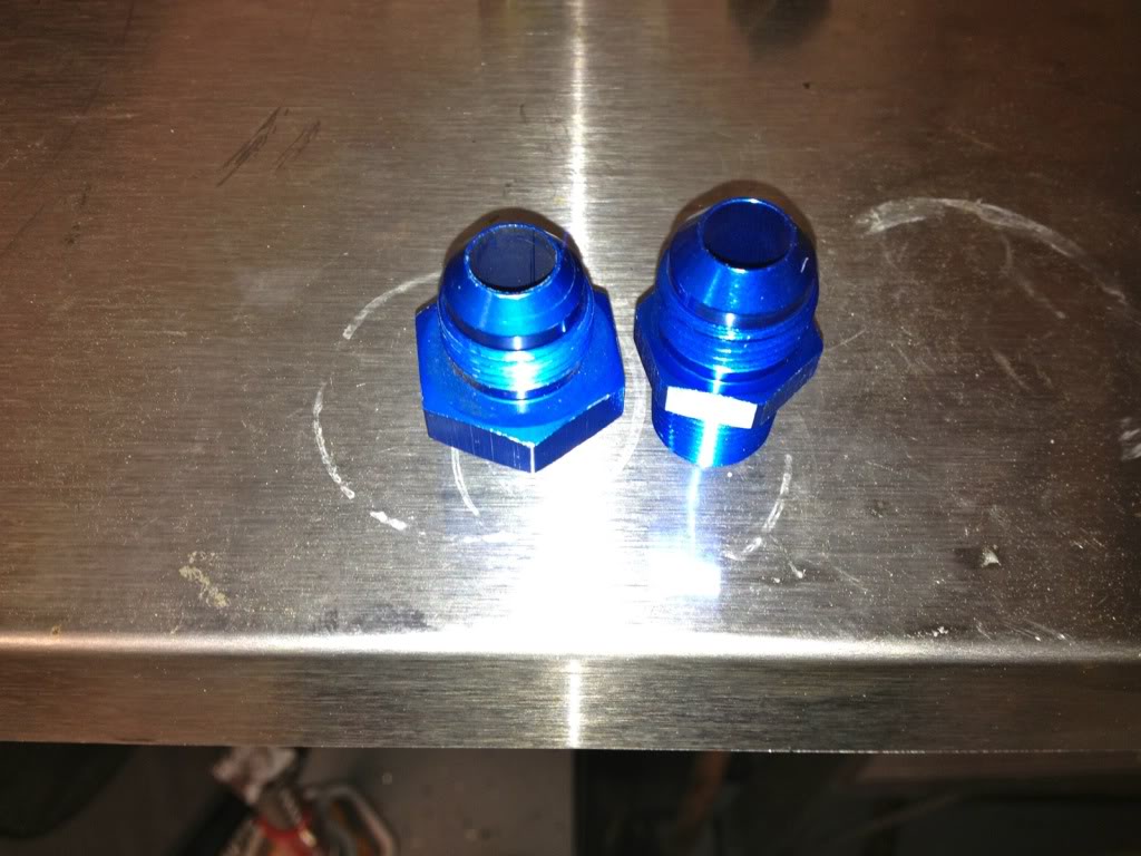

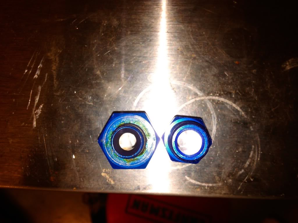

My connections worked out, got some parts at 11PM on a friday lol. The swap/fix was simple, went with Atomic's routing. It worked out that I added that inline fuel filter, had some extra line to reach the back of the rail. Also found a hidden restriction fitting the feed line from the tank hooked into, this couldn't have been helping my cause.
Looks 8an...
Negative..

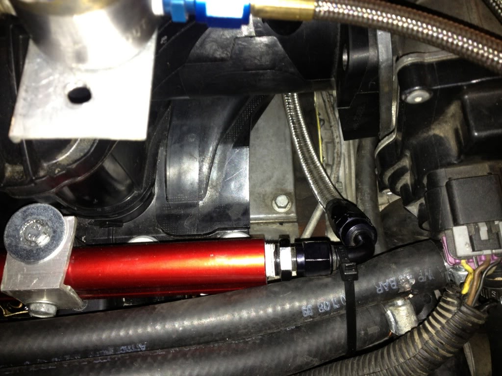

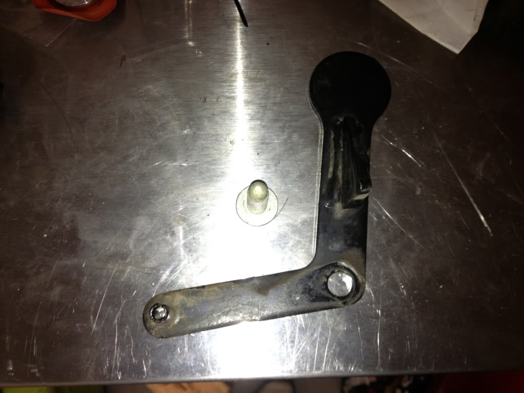

Only thing that had me worried was this damn plate behind the manifold blocking me at the rear of the rail, luckily the thing was held on with one bolt but was a PITA to reach. Good weight reduction mod for 9s..

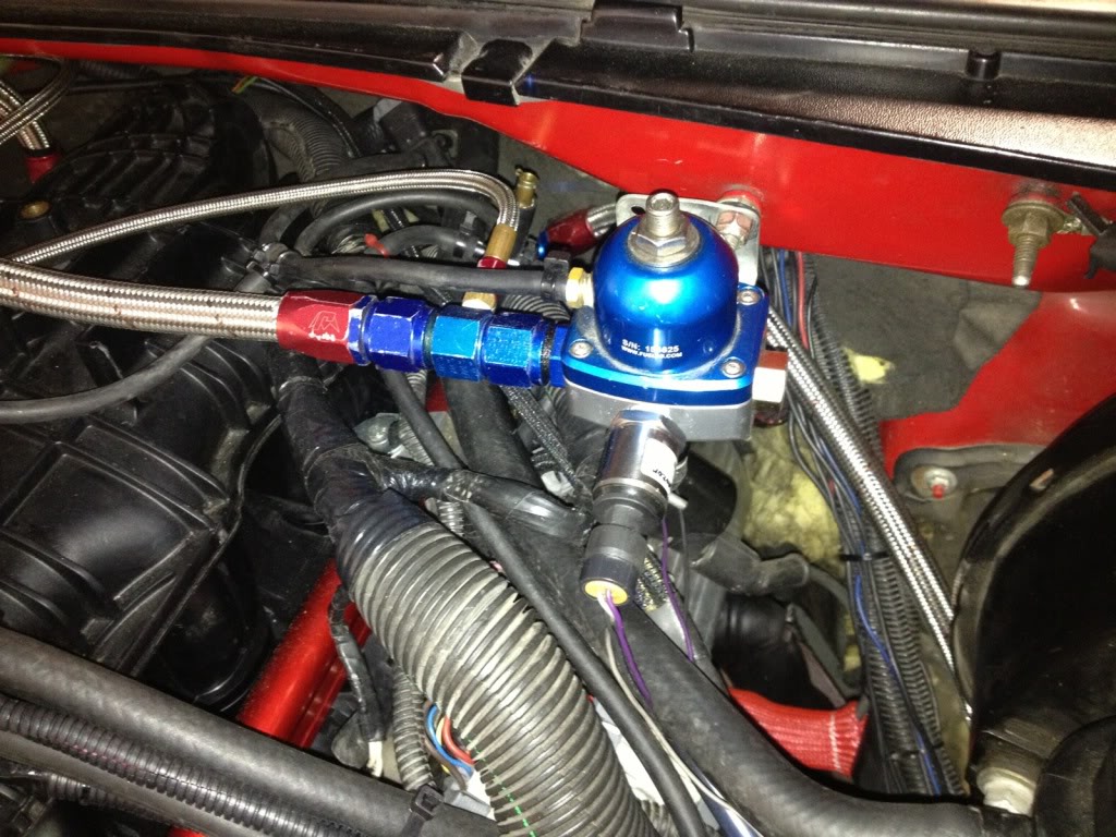

Little late to fire her off for all my neighbors. I'll do a few pulls tomorrow before going to the dyno to make corrections. Still got plugs to swap in tonight and a few more beers to take care of.
