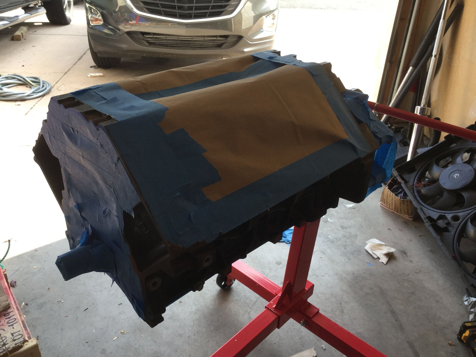

Default A few photos

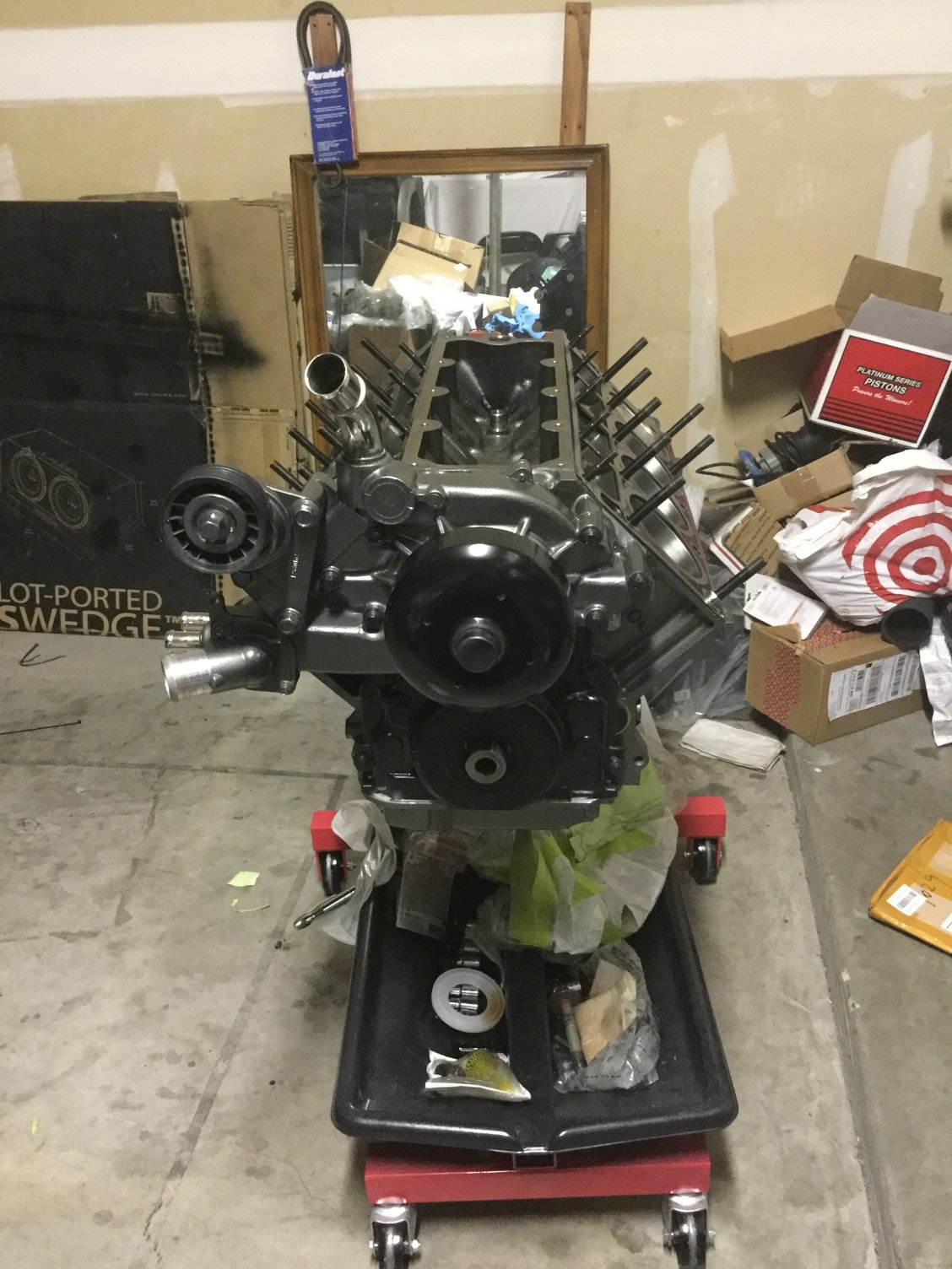

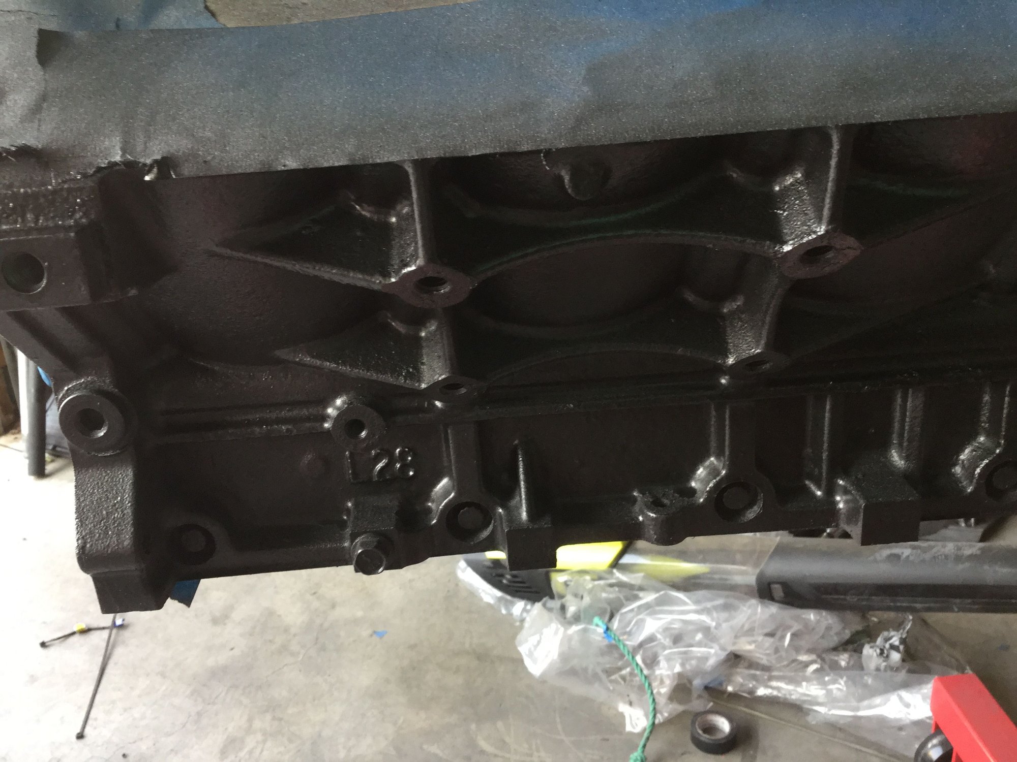

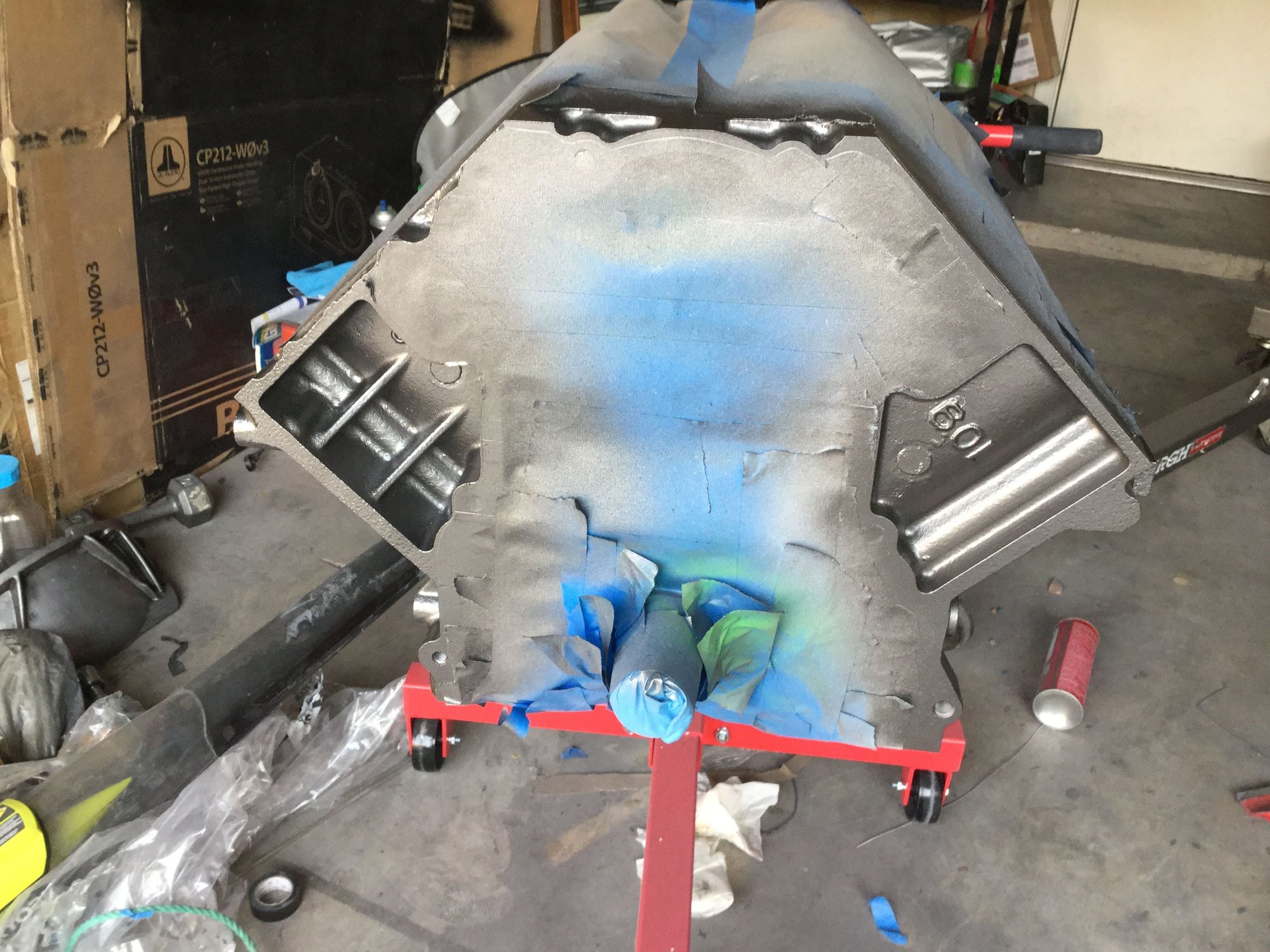

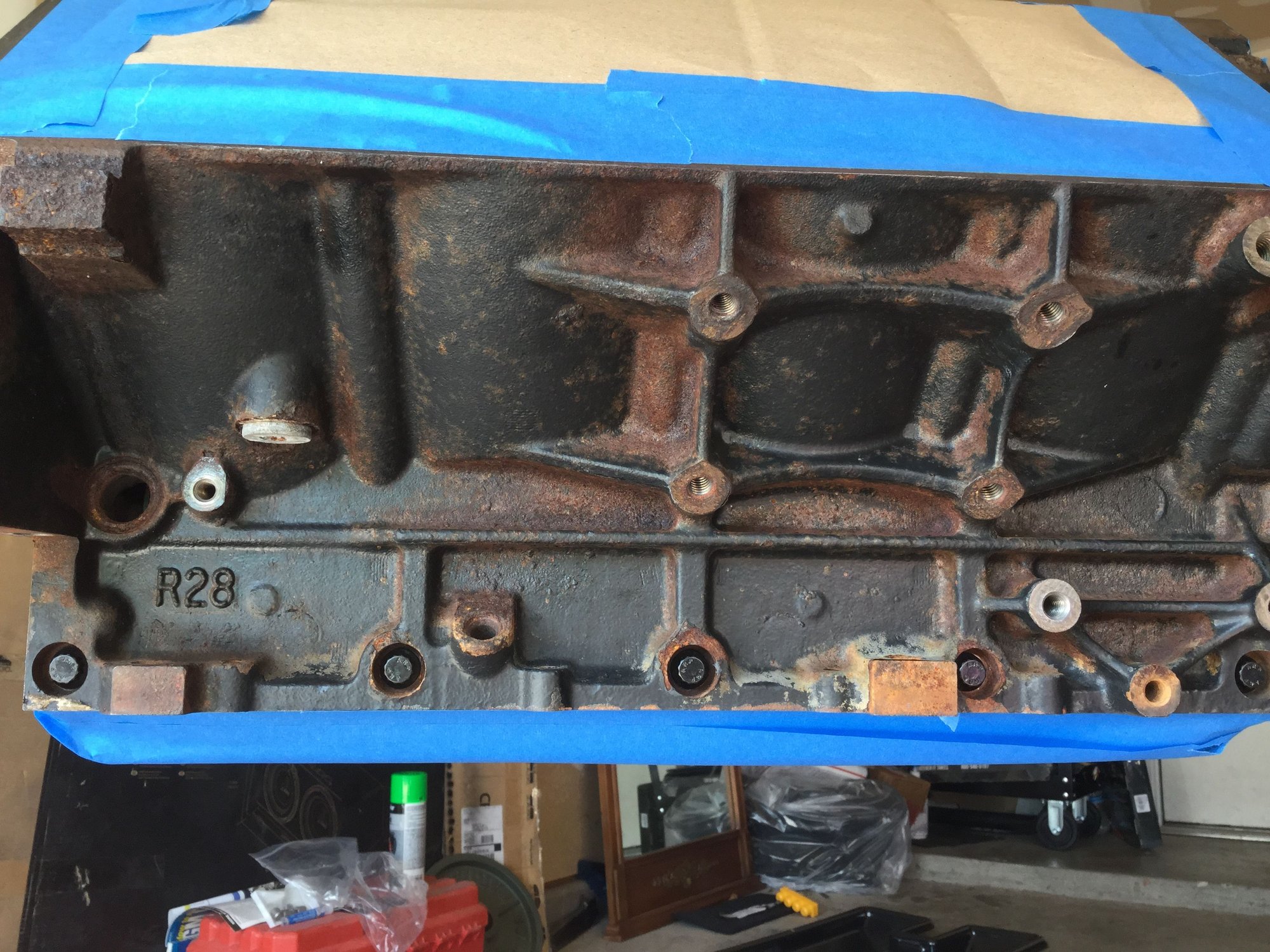

A fresh start
Back from the machine shop
Time to go to work

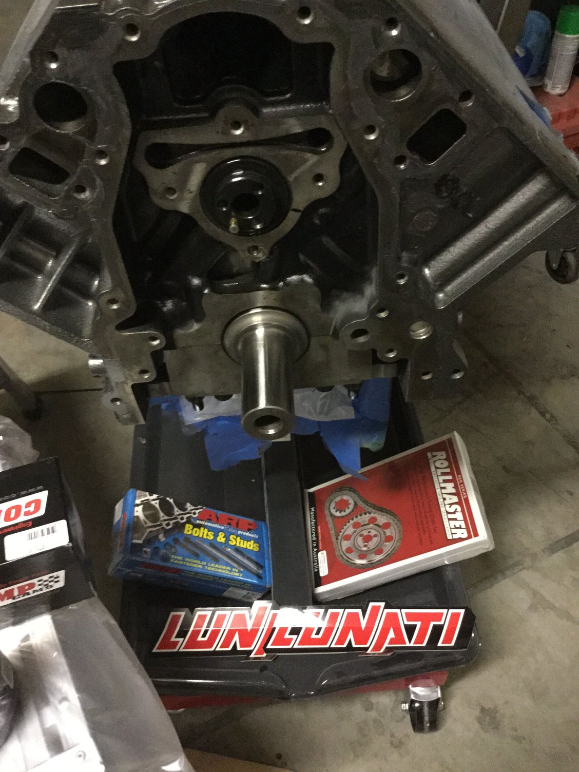

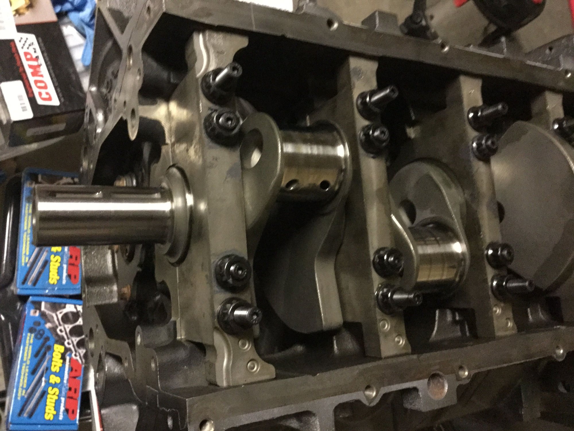

Stroker crank

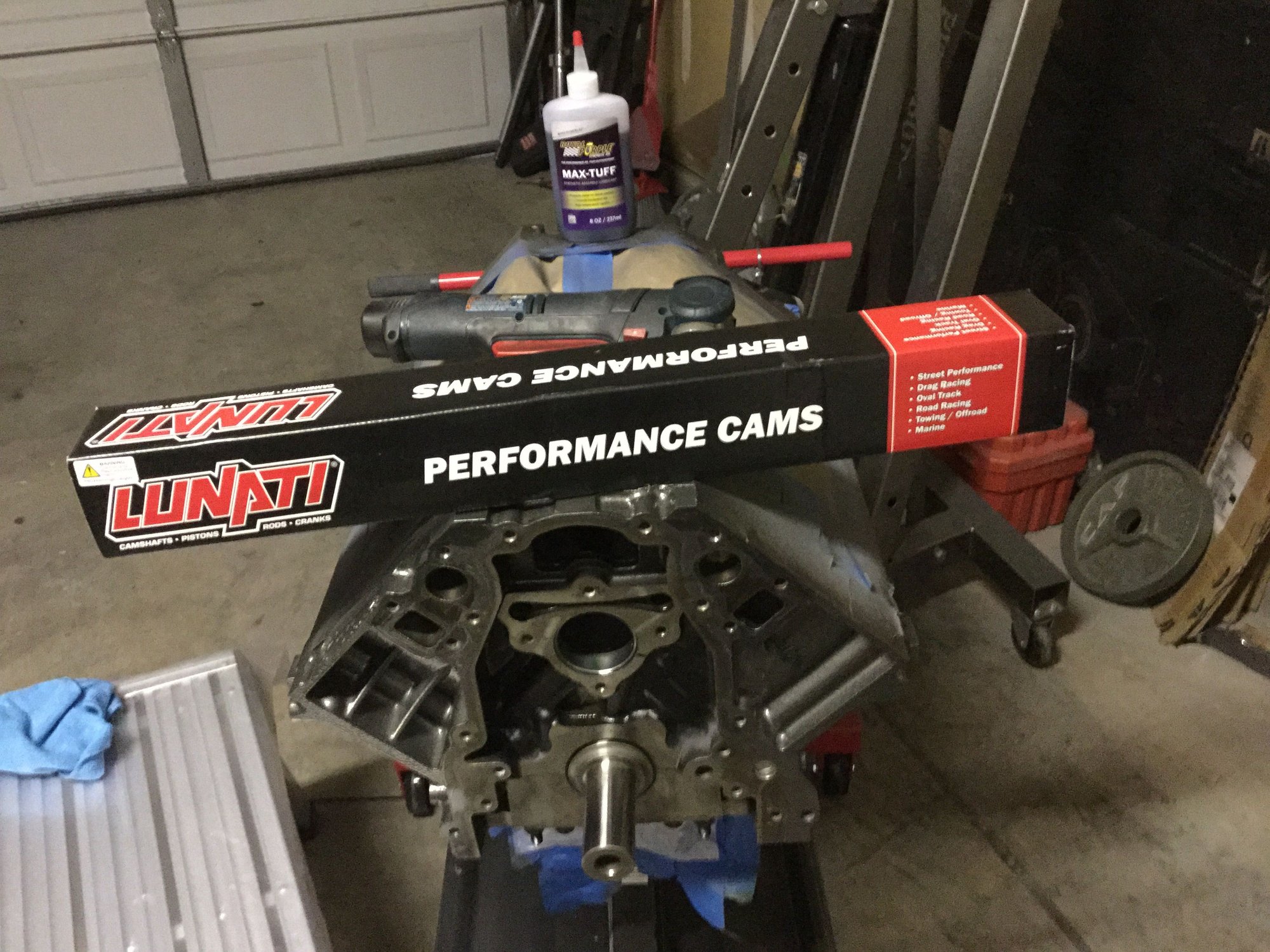

Default Even more pics

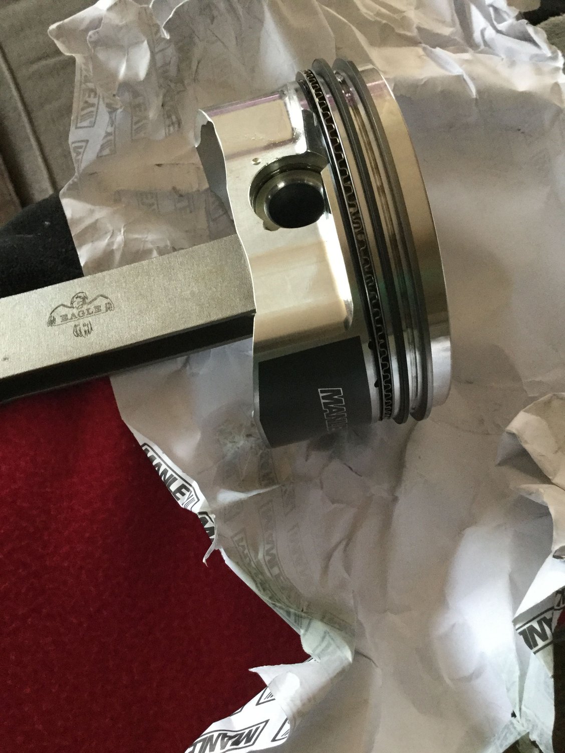

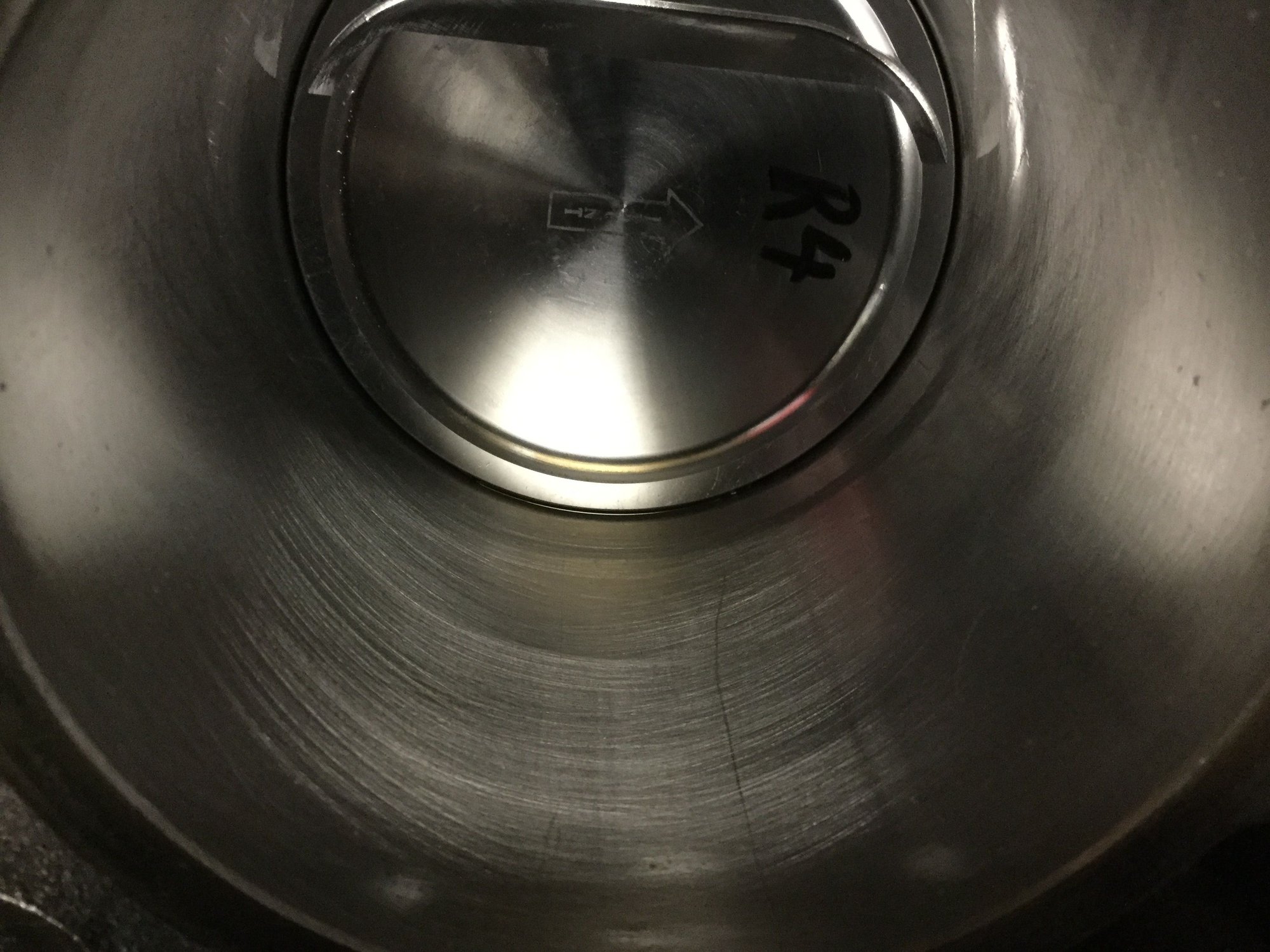

Had the machine shop put the rods on the piston only to later find out they had numbered them all wrong

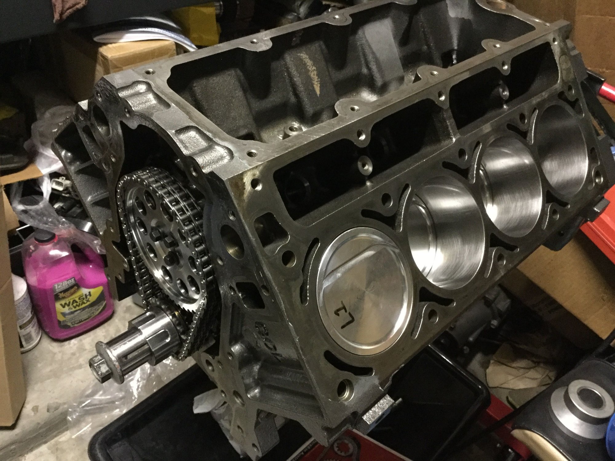

Cam is in

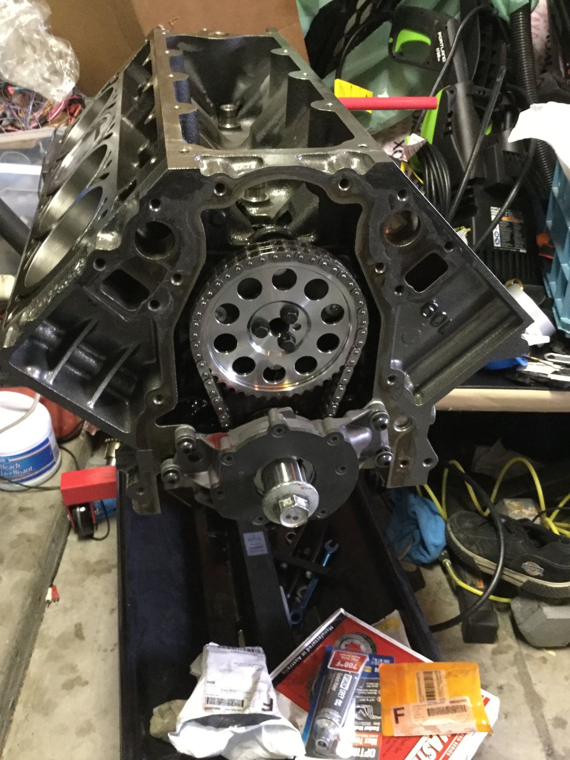

Default Still more
Number one piston up
After I learned they were numbered wrong
Getting it all lined up

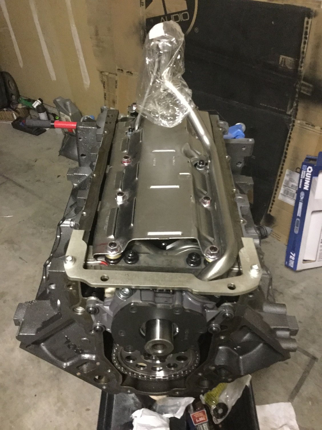

Default And even more

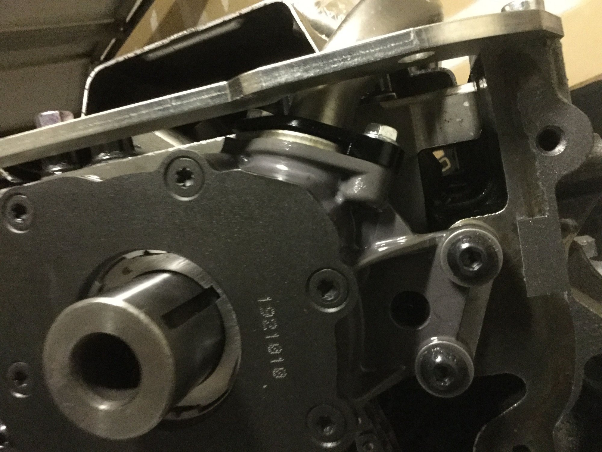

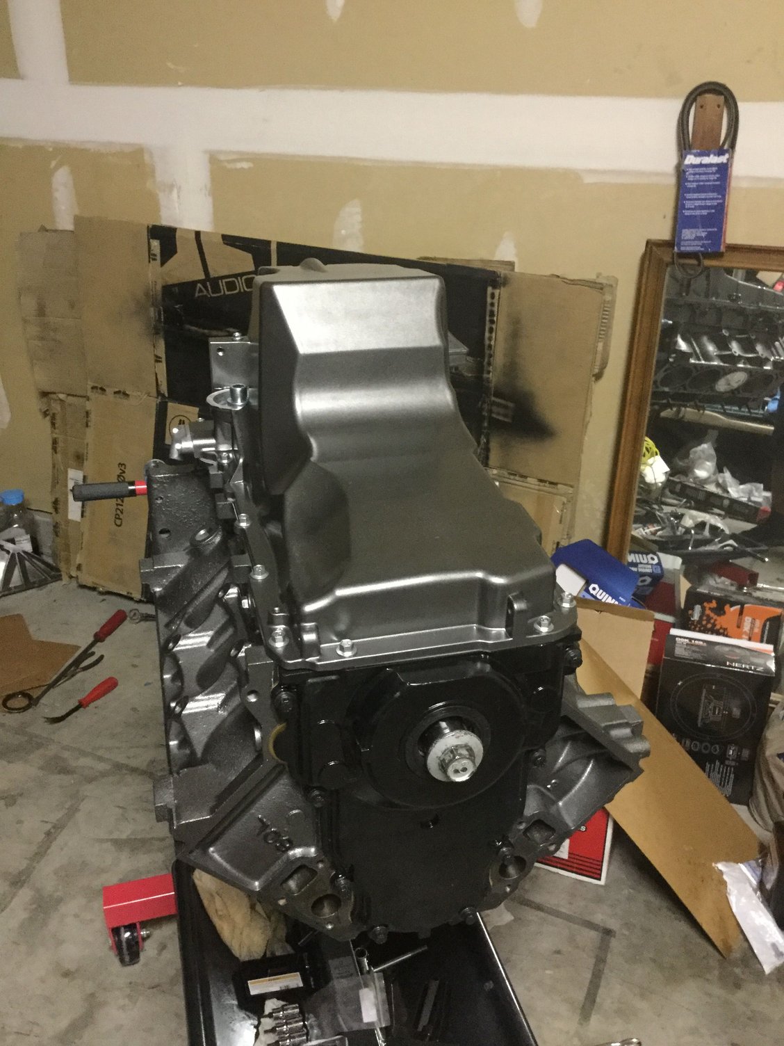

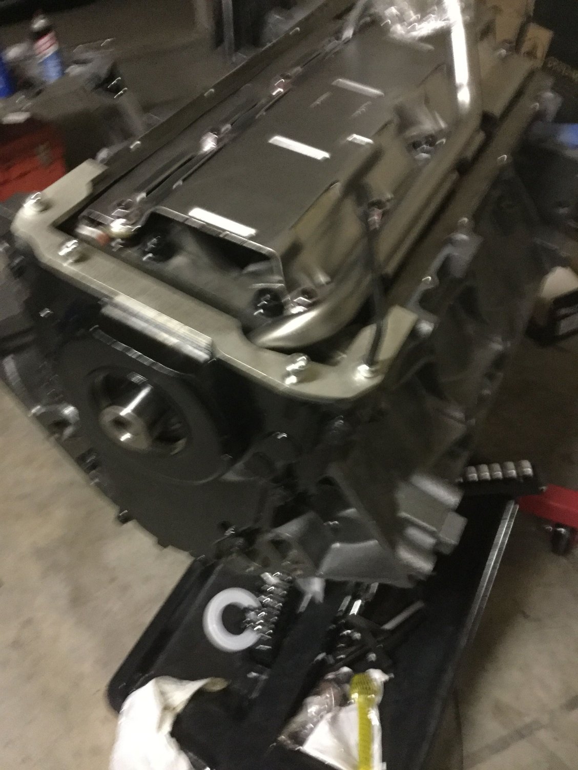

Getting everything lined up of course had to change a few things because the crank was hitting
Oil pump
Oil pump tube clamp
Old Dec 25, 2020 | 01:04 PM

GM makes a windage tray for 4.0" stroke motors, I used it in my 408 as well!
I also did the pick-up tube clamp
what are you gonna rev to?

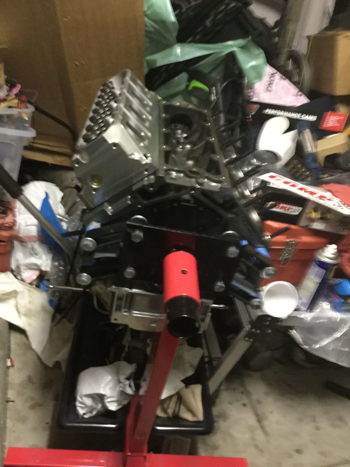

Slowly but surely going back together

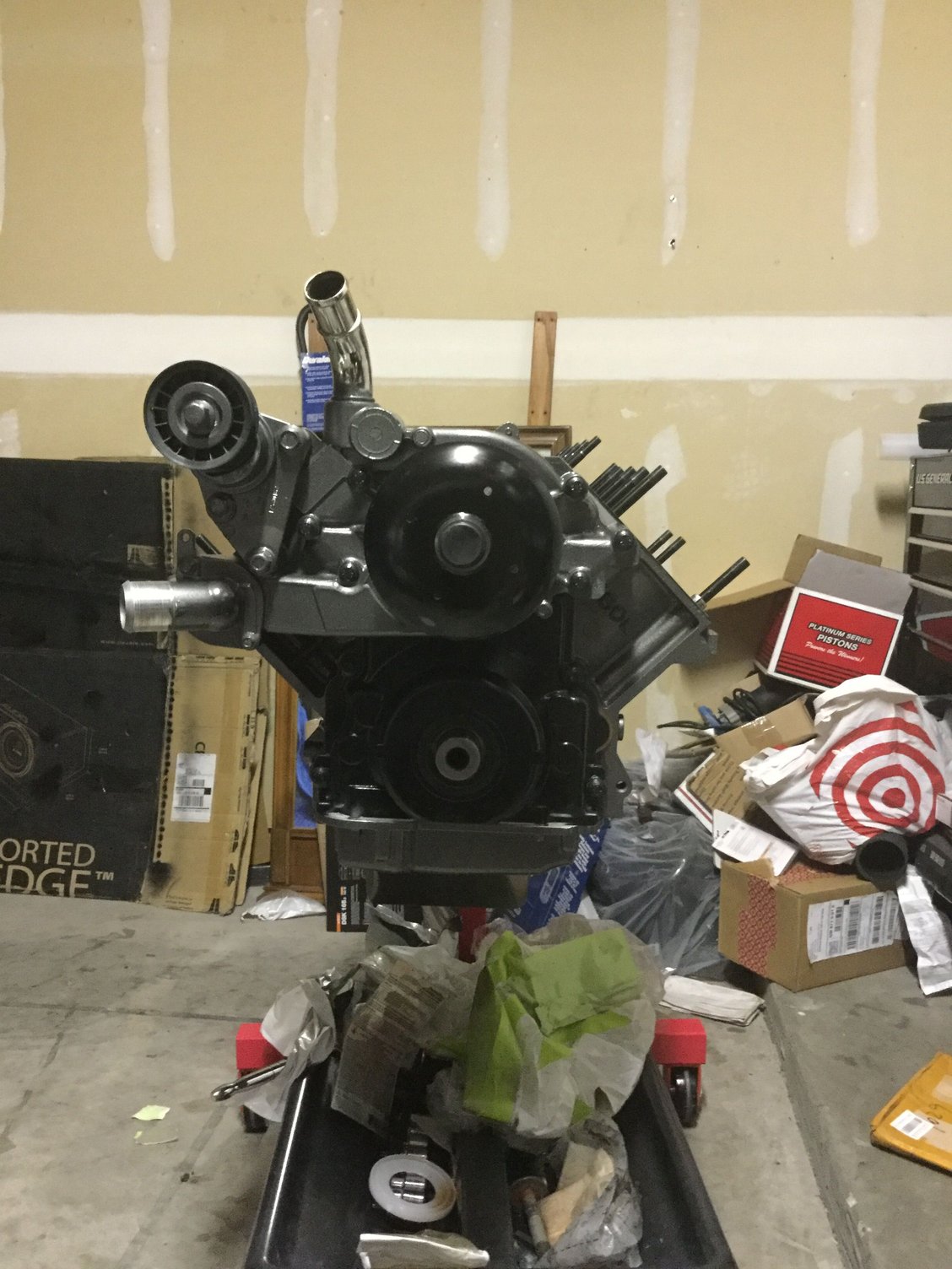

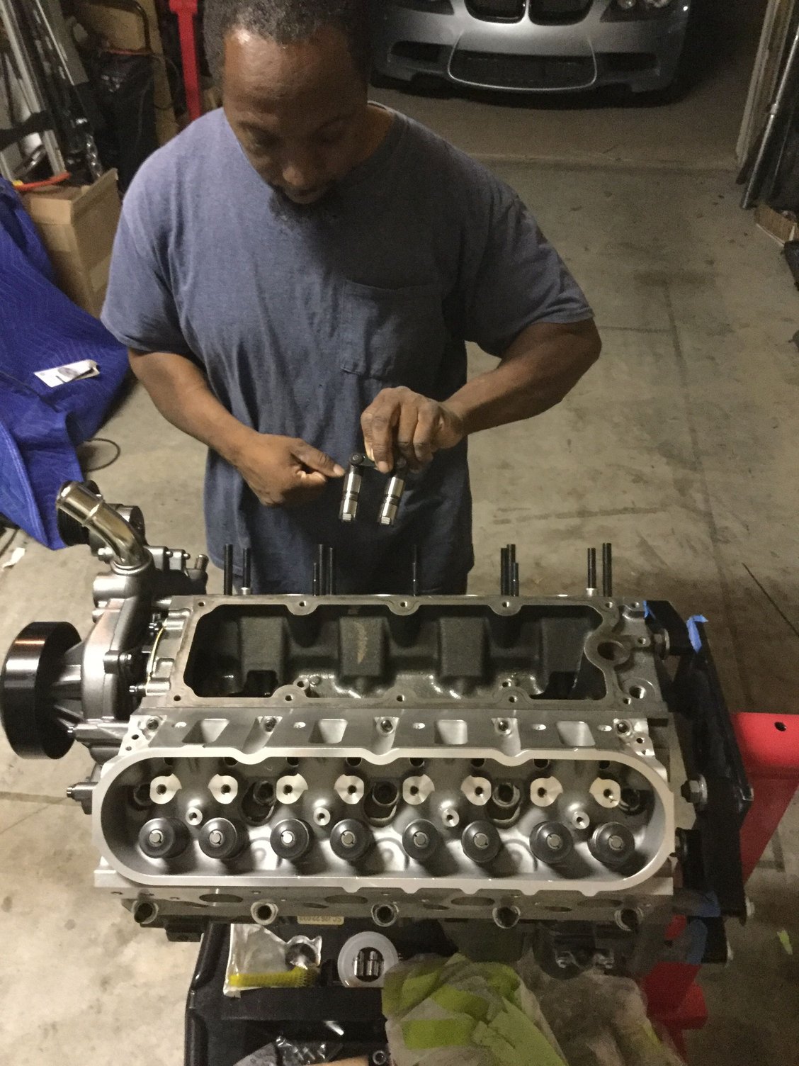

Default More
Add to re-order Ls9 gaskets Tried a cheaper pair off of eBay they look the same but I had to replace them if it was not good
Water pump installed
Finally getting the lifters installed after the porch thieves got a hold of my first set and delaying me even more
