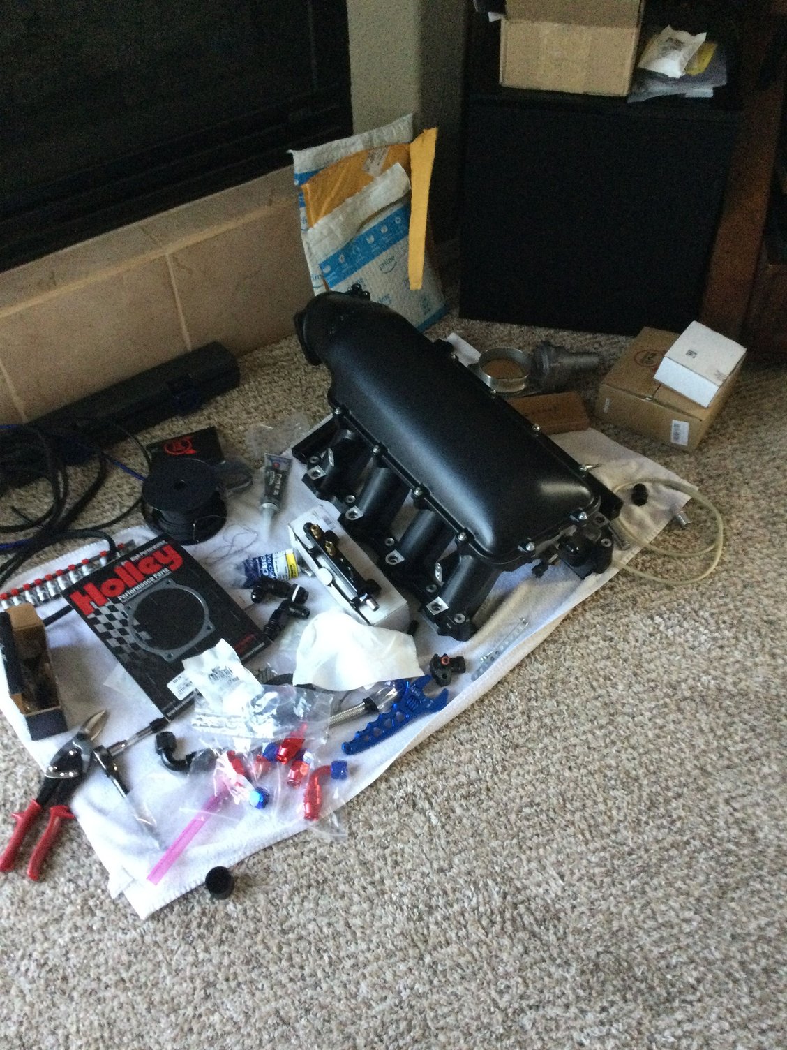

Default Even more
A better fit
Second set
Getting Even closer

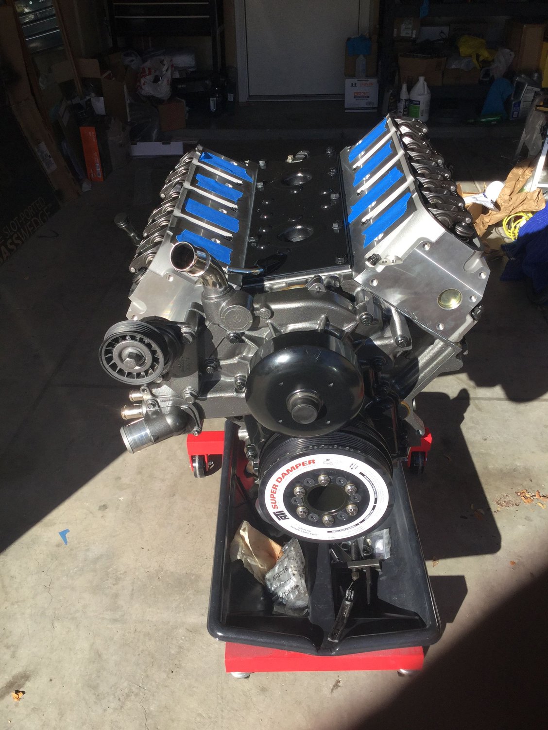

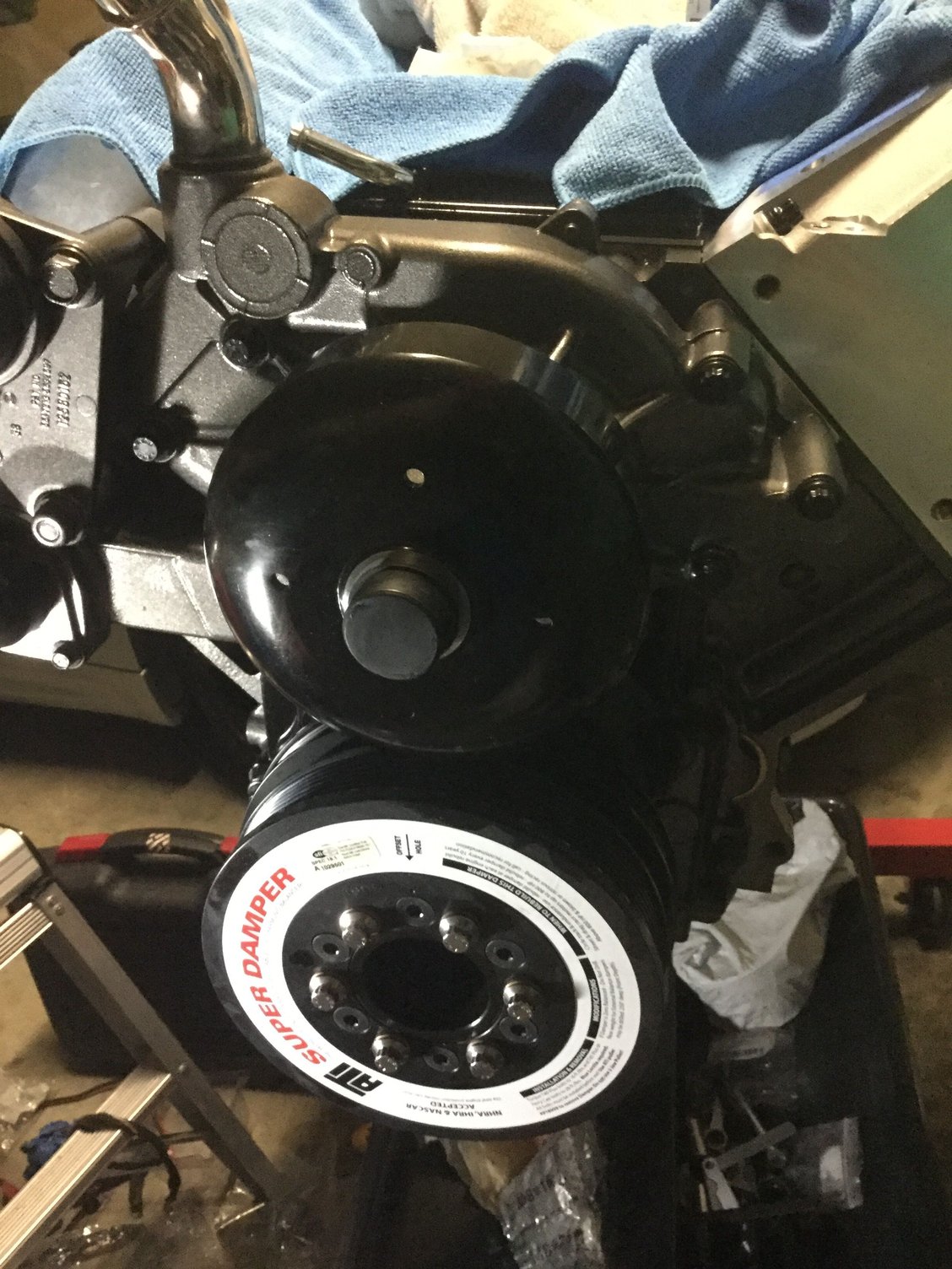

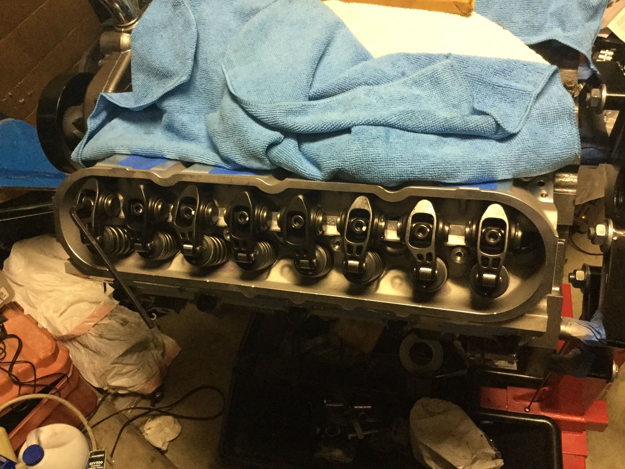

Default Still more to go

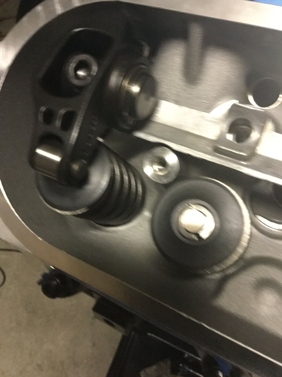

Damper
Rockers
Rockers

Hey man, I don't wanna poo on your parade, but 7500 with a 4.0" stroke in a stock gen3 block is really high
I have a gen4 block, the skirts are allegedly .05-.055" longer than gen3 and I'm only going to 6500
I hope she does what you want her to! But I'd be keeping a real good eye on stuff going that high
https://www.improvedracing.com/winda...-19244049.html
I had to machine some ribs in my C5 pan for it to fit, but it clears the crank no problem and the pick up fits perfectly

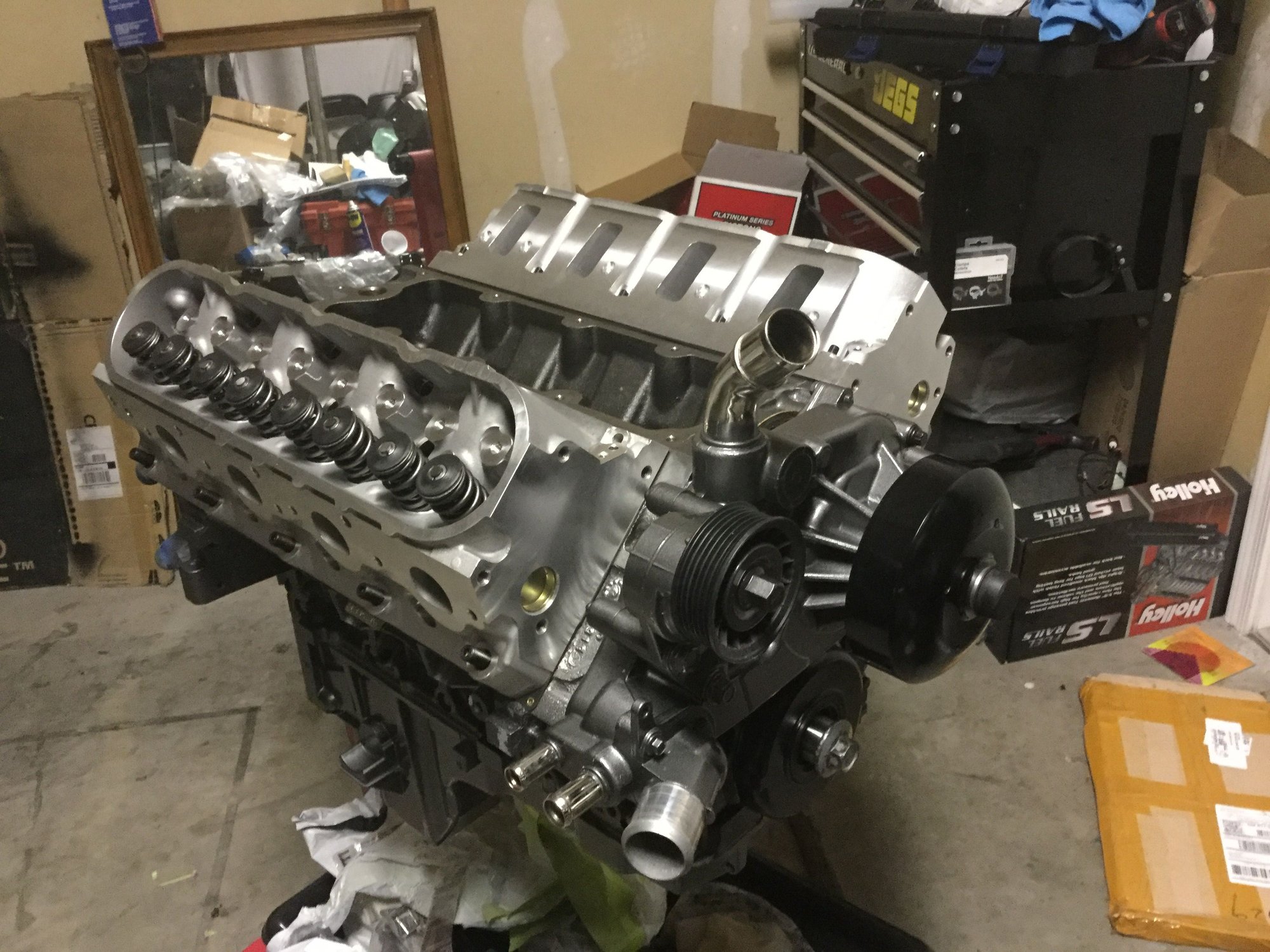

Default Pics
Better lighting
Apart to get Powder coated black
Taking it apart to get Powder coated black
Okay that's good to know.. will be careful with that thanks.. told the place I order some of my stuff from I wanna go a bit higher on my revs. they said with these parts would be ok.

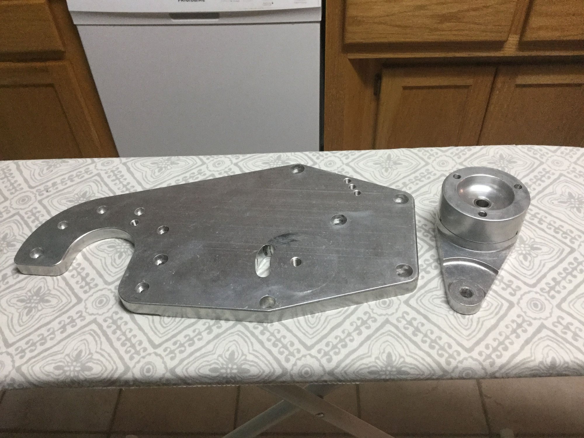

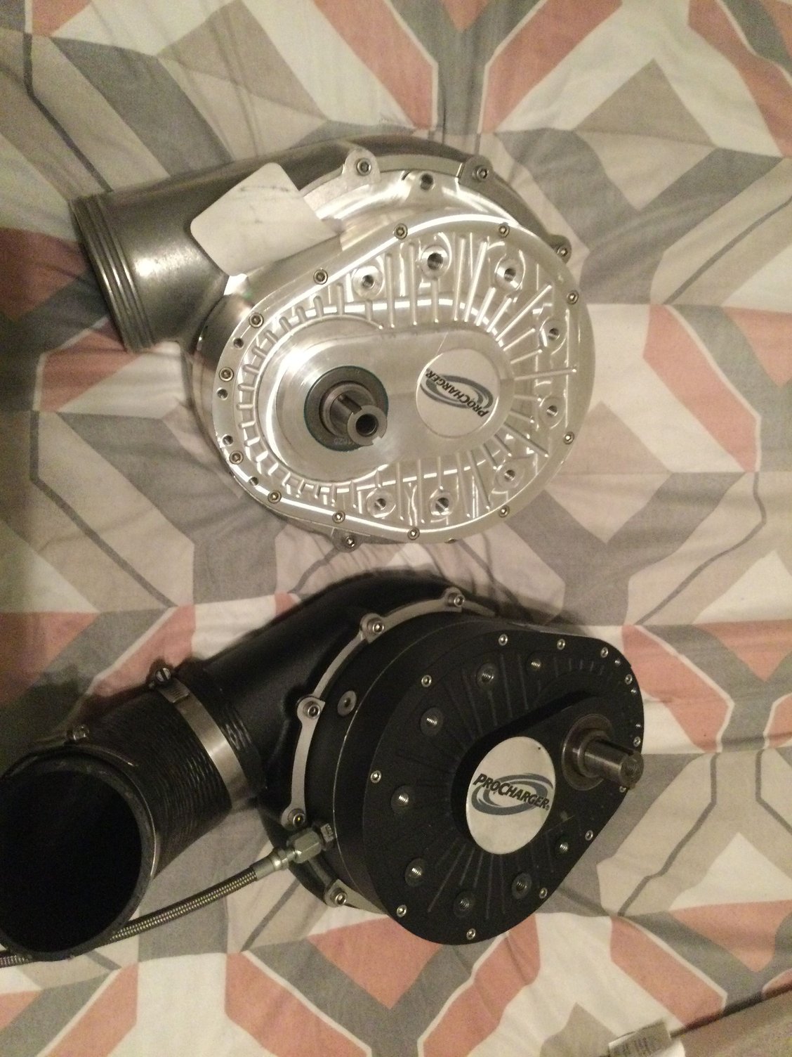

Default Supercharger
Two options F1X new Never used and a F1A-94

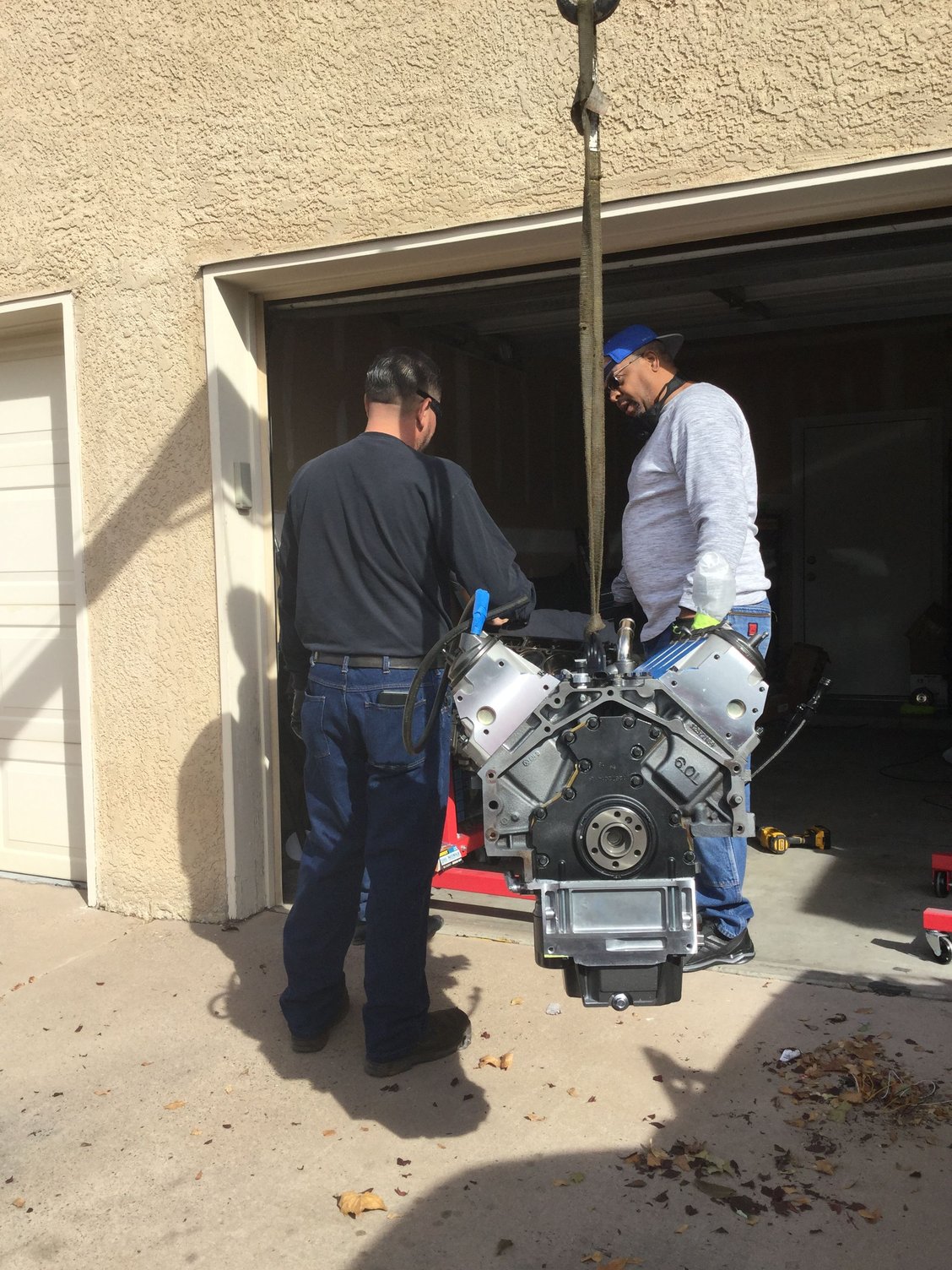

Default A little help from friends
This is why it’s cool that friends sometimes have the right stuff to help out

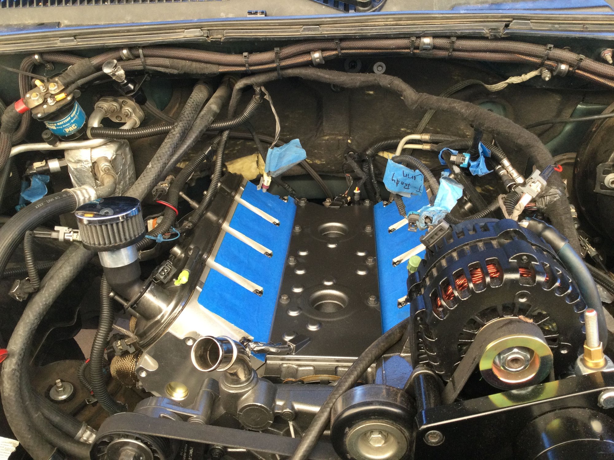

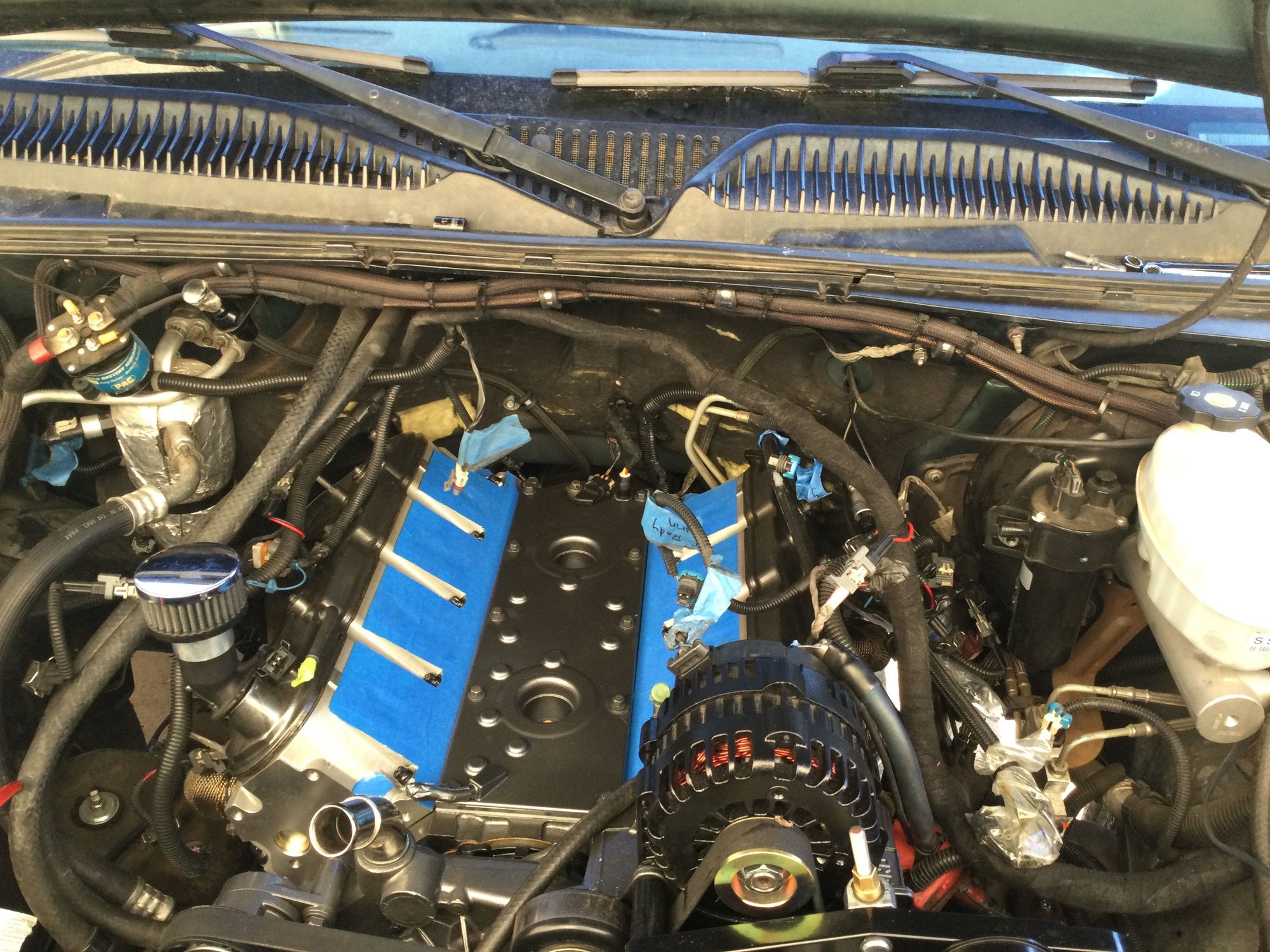

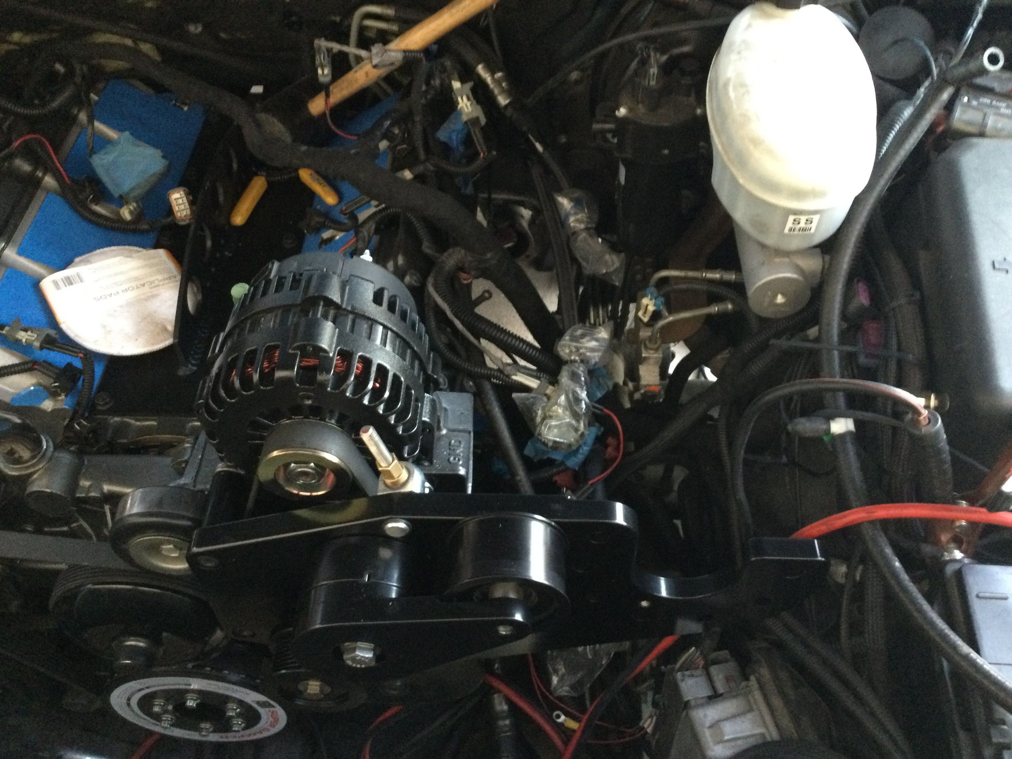

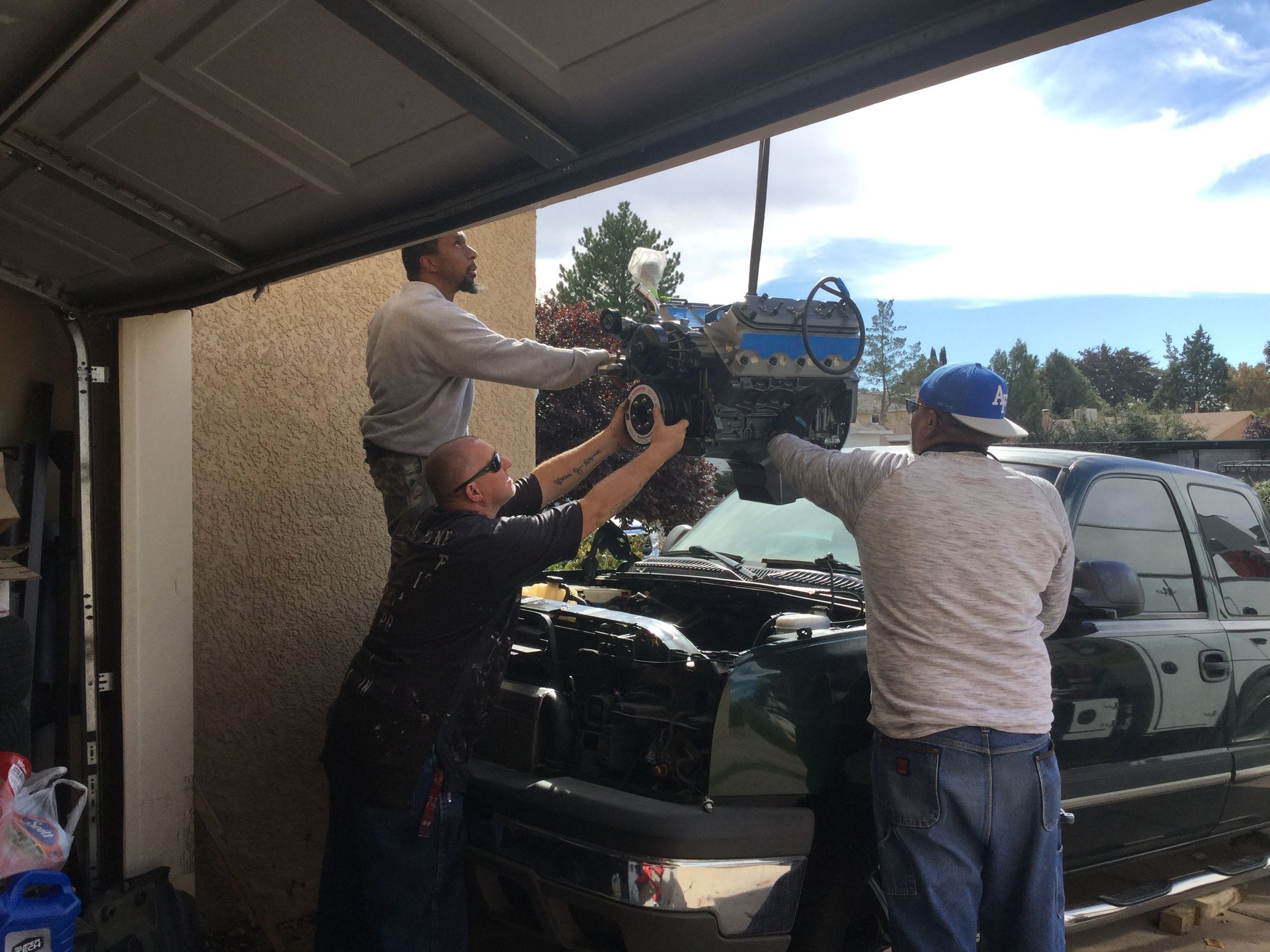

Default Finally the motors in the truck
Powder coated Bracket now installed
