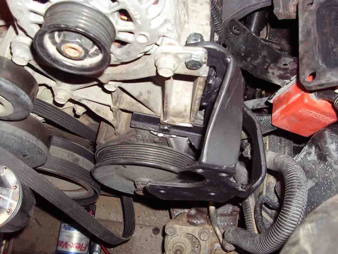

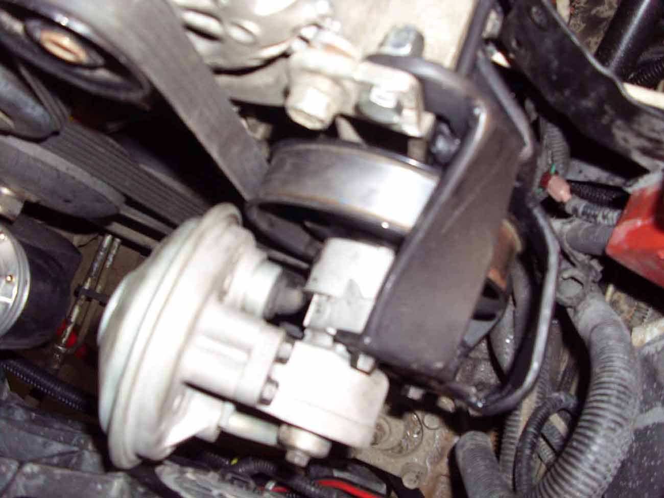

I think i finally found a solution to my smoke and stink problems. I was previously running both valve covers into a catch can with a breather on top but was still getting stink/smoke into the cab and even out the tailpipe sometimes. I mounted a vacuum pump from a 6.5 turbo diesel and routed the line to the top of my catch can. I took it for a bit of a drive and so far so good. Only problem is that it is kind of noisy, although i'd rather that than the stink!

Looks good, keep us posted about results.
Did you use the same belt?

Used the same belt. Took it for a drive today in the daylight and all smoke/stink is definetly gone. It kind of sounds like my old 6.5 though
