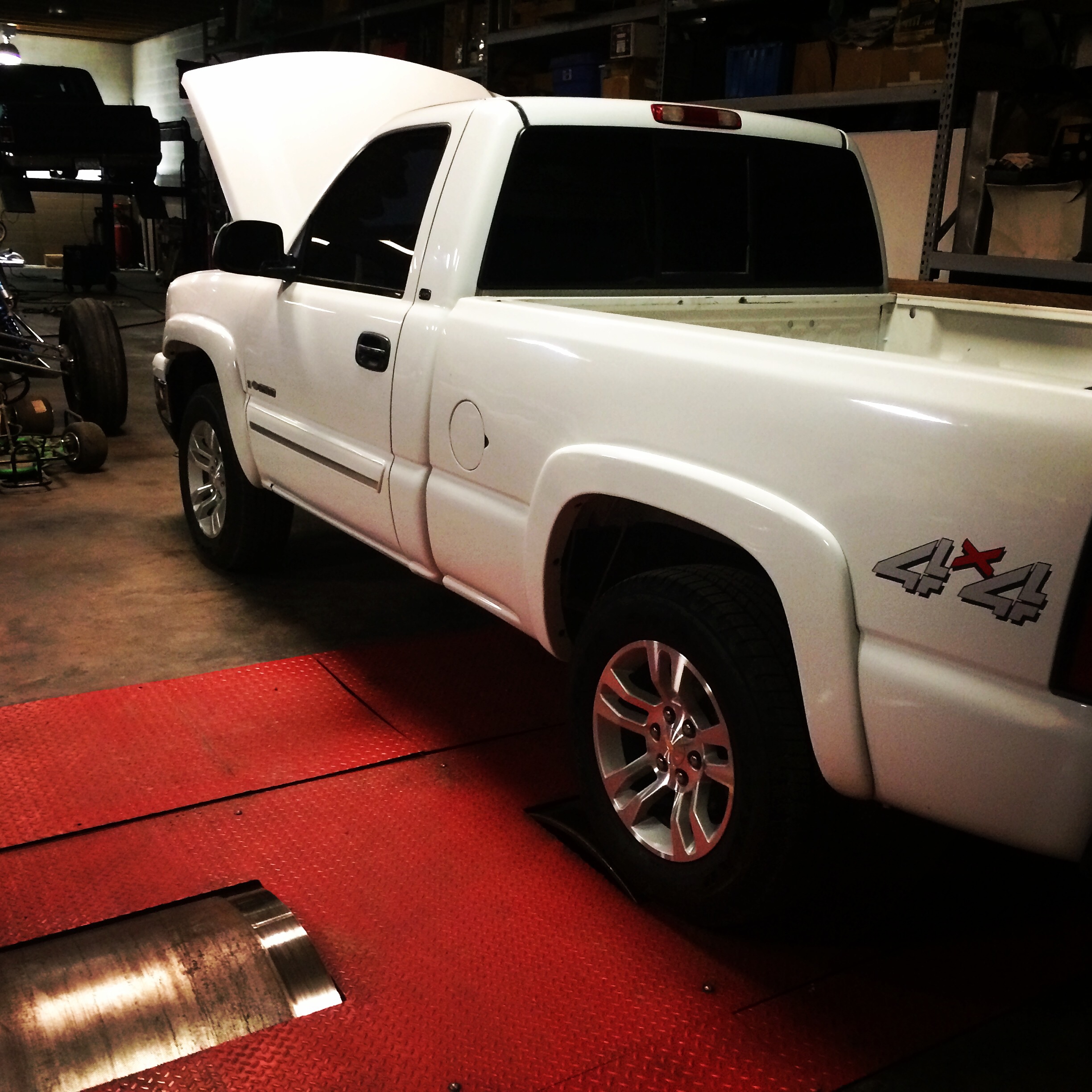

Well, I finally got my truck ready after a LONG time..
I got an email from my tuner that the truck is ready for pickup..
Specs are on my signature, it made 572/530 ~8-9lbs and 667-613 ~12-13psi..
What do you all think?
He told me it was on a safe and conservative tune and that the Cam was holding my power down =\

This is the truck..

Made over 1000rwhp with a stock48 cam and has a better dyno graph then most donkey dicks
Your power is about right for mods

I think your power seems right, that cams fine.

The safe, conservative tune is holding power down, not the cam lol.

Turbo dont care about your cam

Thanks guys, I like my hp numbers, I expect that the torque would be higher than rwhp..
First time they got a hold of me to tell me the wastegate was to small and that I needed to order another one, tq was higher than rwhp for about 100... (662-767 @ unstable boost)

torque depends on load on the dyno which most dynojets wont load properly to show a good torque number
load also depends on turbine size as for when it comes in
truck will probably show more torque at the track then on dyno
curious as to who said the cam is holding you back
