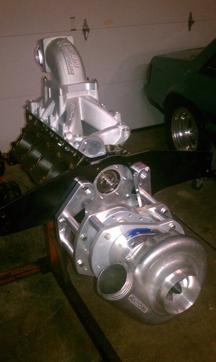

How about an F-2 turned around!
With all of the room a truck has, you could easily place a smaller radiator on each side of the blower. I've never seen one done on one of these trucks. That would be sweet!
