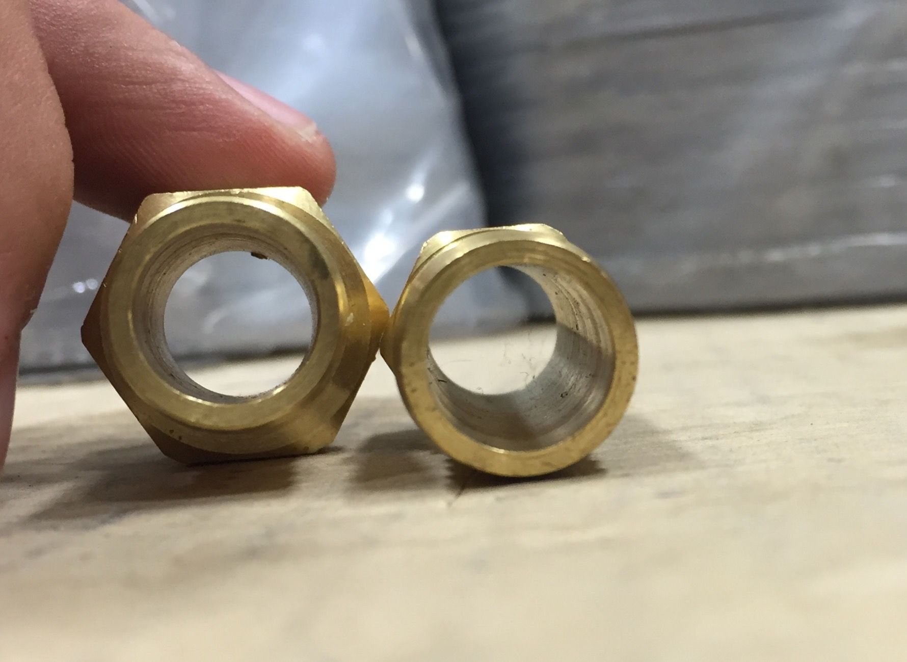

We have 100's of these oil
Kits out there. Been running that combination for years.
The 5/8 hose barb Has the same id with 1/2npt or 3/8npt.
Now unless the fittings where machines in error then they aren't the issue.
