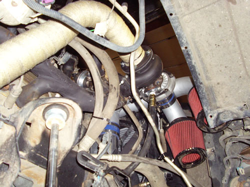

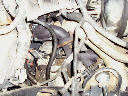

My air/water intercooler slid right in between the electric fans and the engine so that part was actually very easy, these are the best pics i could find that show it.

That's not to bad. Do you have a picture of the drivers side down pipe? Thanks J

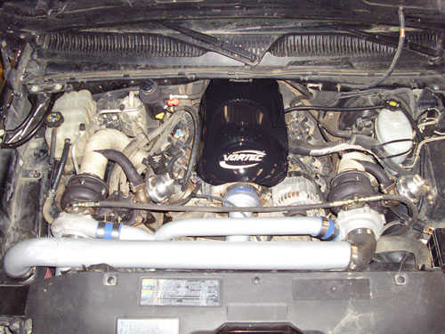

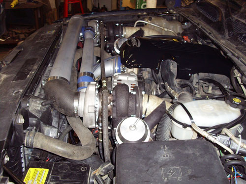

here is my drivers side
here it is, not quite as fancy as 2004denali
Attached Thumbnails Debating between twins or single-dsci0636small.jpg   Debating between twins or single-dsci0641small.jpg

Thats the most dirty engine compartment I have ever seen! LOL, j/k
