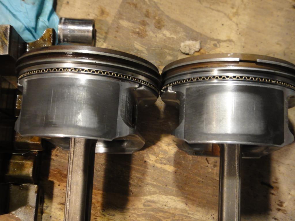

This pic the pistons are facing a way from each other, every pistion has one side worn more then the other as shown below

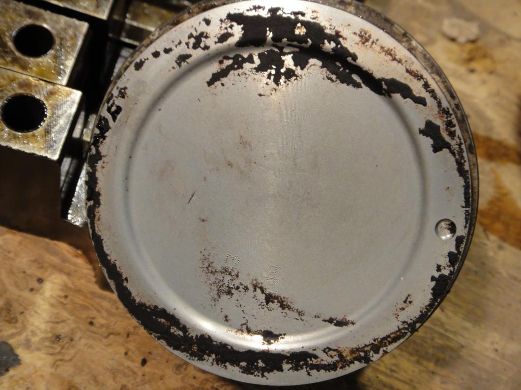

Tops are not showing any wear to me

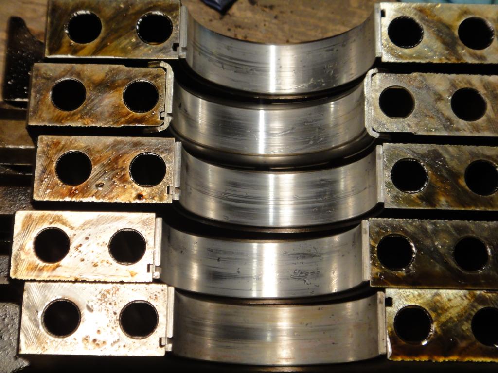

main cap bearings how do these look?

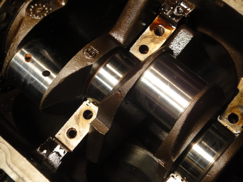

I really dont feel any thing on the crank surface?

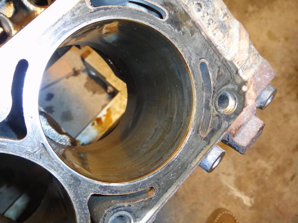

can only see cross hatch marks lightly you can clearly make out where the piston didn't touch the cylinders

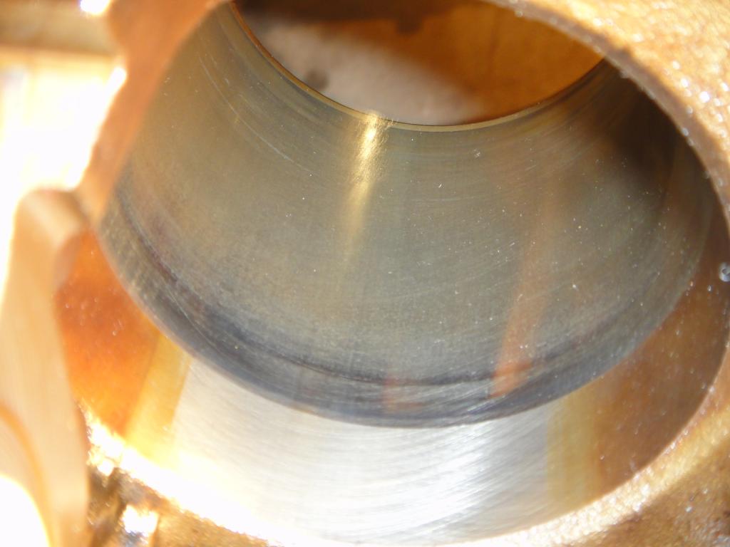

couple have discoloration but dont feel any thing really?

Run the stock bottom end if your only going to push 12 lbs. It will handle that pressure all day long if you get the tune right. Your going to have to buy new head bolts anyway so might as well put studs in it.

13ish on 93 or 18ish on 93 and meth is a pretty decent rule. Lots of other factors though mostly related to tuning.
Keep it stock cube and bottom end for 600ish HP. I bet you reach it no problem with a boosted 6.0
