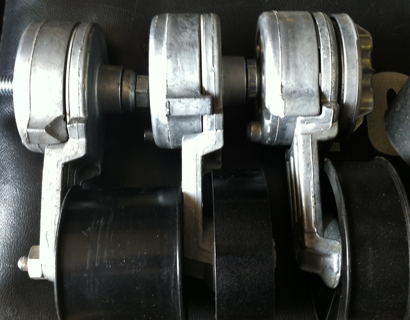

I got both another Dayco tensioner and the Ford version. Looks like the the Motocraft has more beef to the stop area. Busted Dayco is on the left. New Dayco in the middle.
