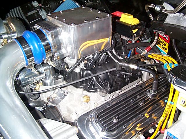

Hello, guys. Jess here.
take a look at my setup. it was a work in progress since about 2000. i bought it new in 97, has 14,800 miles on it now. it has a lot of mods, too many to list. but basicly (sides what you see) = ported heads, beehives, pro-mag rockers, ahr270 cam, 3.73 posi, converter, edelbrock tes & 3 1/2" exhaust.
the engine pics are kinda old, its even better now. and i have HOOKER SUPER COMP 1 5/8" LT's with true duals and cutouts that are going in.
firefighter
my recomendation. do a rear mount turbo, fmu, and a tune. you will be happy with that, for the money and effort you have into it. no, it won't be the fastest around. but for the money it will be plenty fun to drive.

a roots can be done. if i was to do it, i would HEAVILY modifly the stock manifold to look much like a regular roots manifold, except taller. so that real injectors could sit under the blower. but that may make it come through the hood. which may not be a bad thing.
can you weld aluminum ? if so, its just a matter of getting the parts and doing it.
