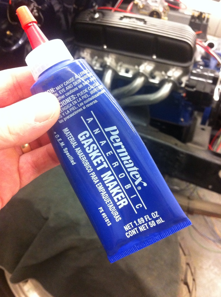

Yes, just the 4 bolts is enough. I just tightened them until my wrist clicked using my little 1/4" drive ratchet.
This is what I use for sealant back there, just a thin coating is all you need.

Excellent! Thanks a bunch Roger, that pic look familiar?

You can also use loc tite form a gasket. I think the torque needed is about 18ft/lbs.... I only know bc I just did the same upgrade LOL.

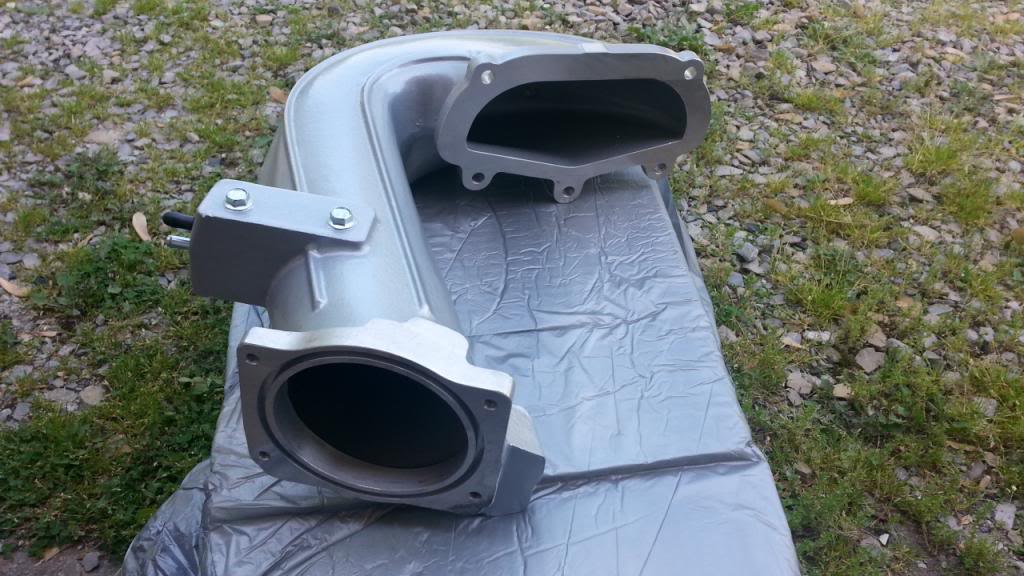

Unfortunately I won't have a before and after impression as this MP122 tube is going on a brand new kit. Figure it's probably easiest to do it right now while the supercharger was sitting on the work bench
