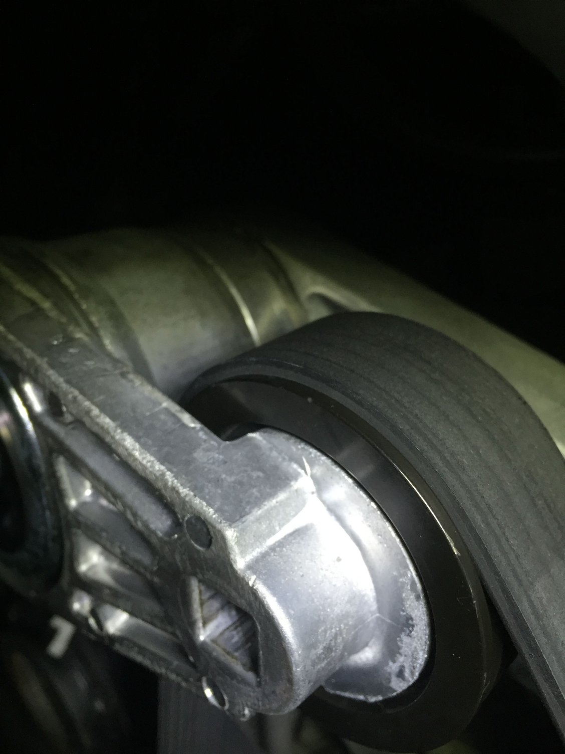

Here's a picture of the tensioner pulley compared to the alt. Pulley. The belt is flush with the lip on the alt. Pulley. The tensioner pulley the belt is pretty much completely above it its just sitting on the grooves.

It would certainly help if the tensioner pulley had shoulders on it. Sound like the entire tensioner is flexing.

in the first pic of the tensioner, it seems the gap is tighter on the top and wider on the bottom, could there be some degree of deflection in the pulley loaded up?

Put an extension in the tensioner and pry away watching for movement.

I'm jumping in late, but I'd be willing to bet a cold beer on that tensioner being your issue.
Since you haven't seen your own setup work under load, check these videos out to see how crucial it is for that thing to swing straight and square and stay plenty tight. I know this has been posted here before but it most definitely pertains to this thread...
