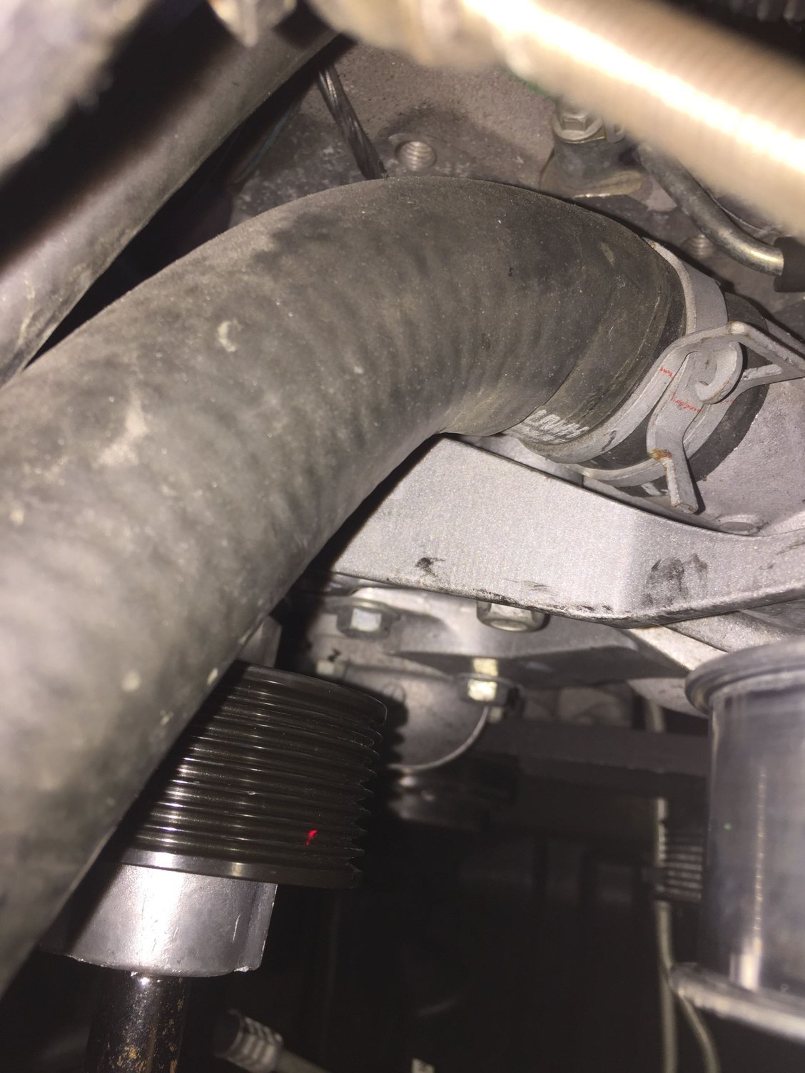

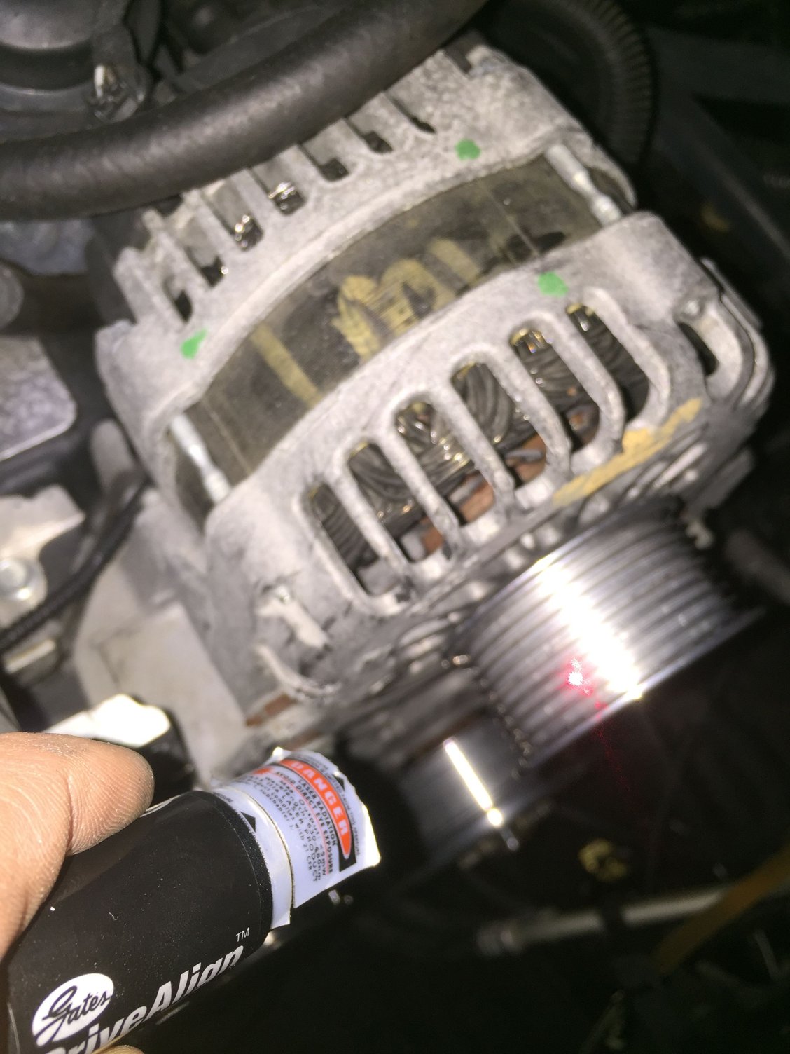

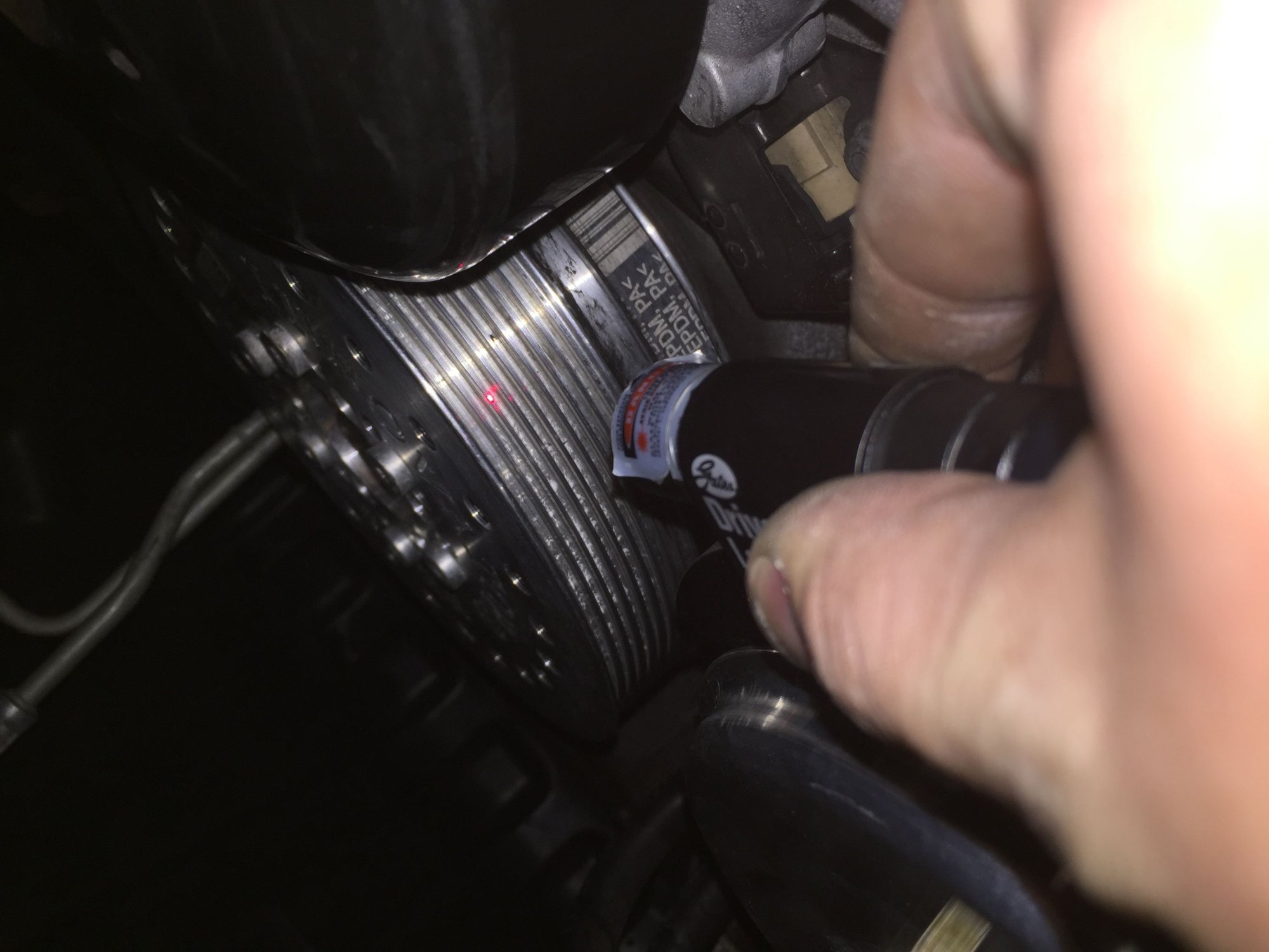

Well guys... I went out for a rip tonight after work and the belt still went back off the tensioner pulley by a rib and ripped into the belt again... I took pics with the laser tool on the pulleys. All are within a 1/4 rib of each other. From what I've read 1/2 a rib for every 6 inches of belt spread is acceptable. So I'm well within that on all of them. Im losing it on this. I just wanna drive my truck!!

Wow this sux. Two more suggestions to check if you have not already:
1. If you remove the blower spacer pulley and flip the blower pulley does it line up wtih the alternator pulley (using a straight edge).
2. I bought a Gates alignment tool but ended up sending it back. Using their paper jig everything looked near enough but with a more solid squared up jig across 4 feet you could really see the difference. After trying to correct the alignment, I figured out the set screws were too small for the tool that holds the alignment. I called their support and he checked the ones they had there too. Apparently the mfg. installed at least one large batch with the screws too small. So I used straight edge like the others herein and LC32 Joe suggested with no problems.

It kind of sounds like one or more of the pulleys arent square to the engine. Use the laser to trace a path around the pulley and see if it moves inward or outward on the adjacent pulley.

Are you checking the tentioner alignment thru its range of motion? If it is not square to the engine and other pulleys, as it moves thru its range, it will move out of alignment. I would also rather see a full face spacer rather than the fender washers spacing out the tentioner. The cast aluminum on the tentioner face is not very thick and could flex and/or crack unless supported at the edges.
