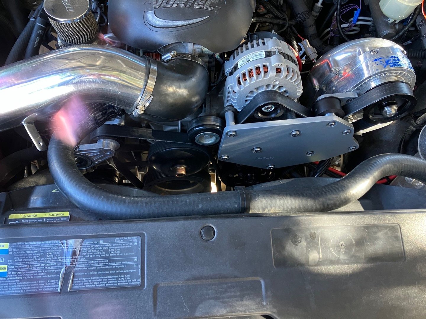

I'd like to take credit for "visioneering" this concept of using the LSA lower as a cheap alternative to 8 ribbing a truck
No idea if that's accurate, but I know damn well I am the first to post pics about it on this forum
My whole build started life because I had an LSA lower I paid $40 for and found a 3.8" ProCharger pulley in 8 rib on eBay for something dumb, like $20. So I said "F-it, we doin it!"
All in I am less than $300 into my 8 rib setup, but I have been building it since 2020 and I am a machinist myself, so modifying the blower idlers and the bracket was easy stuff for me. The single most expensive piece of my kit was having my aluminum pulleys hard anodized

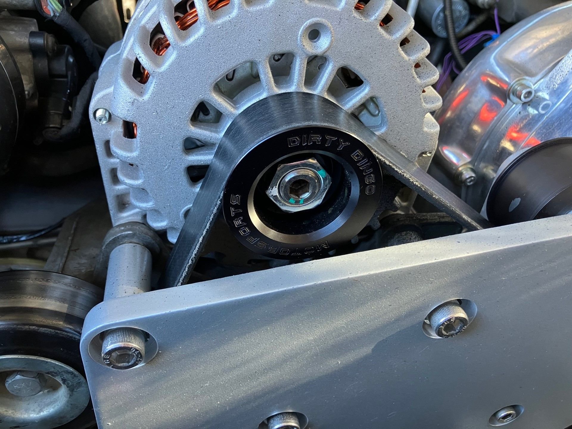

1) LSA lower. I found that you CANNOT seat the lower all the way on the crank snout, it will not line up. I had to pull it out ~.125" and put a washer behind the bolt to torque it down. 250ft/lbs for ARP bolt, don't forget to drill the crank and damper to stop the pulley from spinning
2) Dirty Dingo makes the 8 rib pulleys. I had mine hard anodized, they ship raw Alt Pulley PS Pulley
3) @Atomic Performance tensioner mount. I had mine powdercoated "Porsche Silver" Mount
4) Gates 38518 tensioner. Available cheaper than this:
Tensioner Tensioner
5) Belt. I ended up with a K81092. Your results WILL vary
5A) Found out that with a very careful install procedure the Gate "K040363SF" stretch belt fits on the 6 rib side of the pulley to drive the AC! So thats cool, you're welcome aha

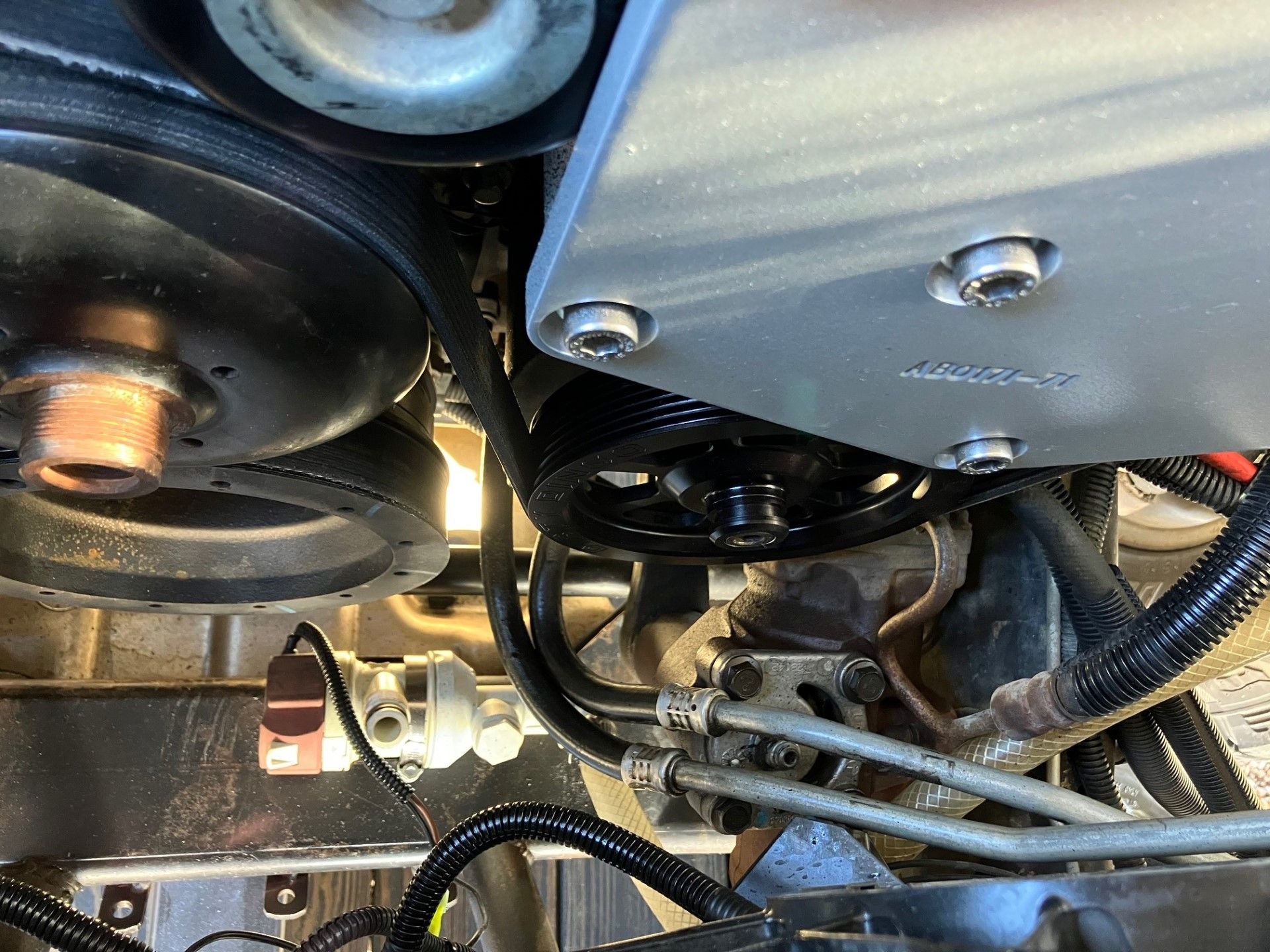

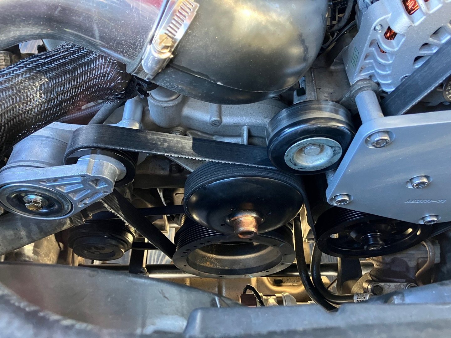

This is my first time posting any of this. I just finished the install maybe 3-4wks ago. You can see my belt is chewed up a little because it took some idle time for me to find out I had an alignment issue 🤣
I have a 3/8 wide, 12" long straight edge- I used it to make the faces of the crank pulley and the PS pulley planar to each other, and that helped with 98% of it. I think I need to tune the damper depth some more. It's a little bit of a hassle, but for $1000 in savings, I can deal with having to fine tune things lol

For out trucks, at the power level we are shooting for (sub 700whp) I would NOT consider a dedicated drive. House Of Boost does make dedicated drives, but we aren't shooting for the 1000+ level. I don't think a dedicated drive is necessary. I made 477whp on a stock 6rib setup, back in the day
my truck is a full bolt on 5.3 with 3.5" exhaust, 212/218 cam and a wastegate on the blower, I am controlling the gate with an AEM truboost. Gate pressure will be about 6psi, with two levels after that. I will be about 16lbs on "kill" but I won't run that without e85
I did 8 rib because I found what I thought was an easy way to do it, and the LSA lower is larger diameter, so I could overdrive the blower and get more bottom end (hopefully) and bleed off the extra boost with the wastegate
