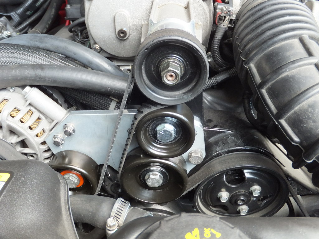

This is the ultimate in belt slip reduction without going to a larger belt or cog system. It basically just creates major belt wrap as you can see.

Gamble, is that a custom piece that you made or is that a kit to eliminate belt slip?

If you are asking me, I designed and made this myself using the original idea from Gadgetized.

The picture that gamble posted in not a GM engine, Gadgetized did it to a LS setup as did Cakes.
