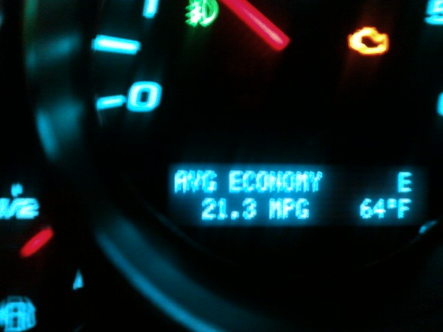

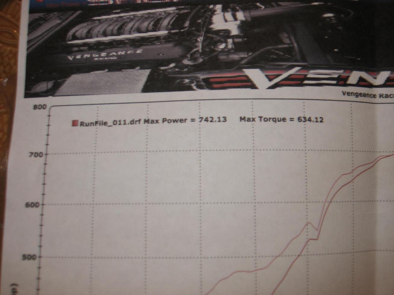

6.2 turbo build-img_1150.jpgGuys the truck did great on the roller today. 742plus rwhp at 13lb of boost. And that with 93oct fuel with meth and the stock exhaust with a dynomax muffler only. The 6 speed trans is hard the dyno too. I think with a 4L80E it will go close to 800rwhp at 13lb. The beast is still getting good gas mileage. Look forward to more tunning, more boost and new trans. Its a rocket!!!! All this was with the stock fuel rails and lines. Just a walbro 450 pump.

Wow that's awesome damn ! Congrats !
I may have missed it but what is done to the 6 speed ?

This is a stock 6 speed with a 3000 stall and it don't like it. The truck goes threw the gear so fast the trans cant shift fast enough. Im look for trans ideas but mostly think the 6speed is coming out and 4L80E going in.. I will turn it back to 600plus something the 6 speed like better.

Killer numbers and 20mpg.
