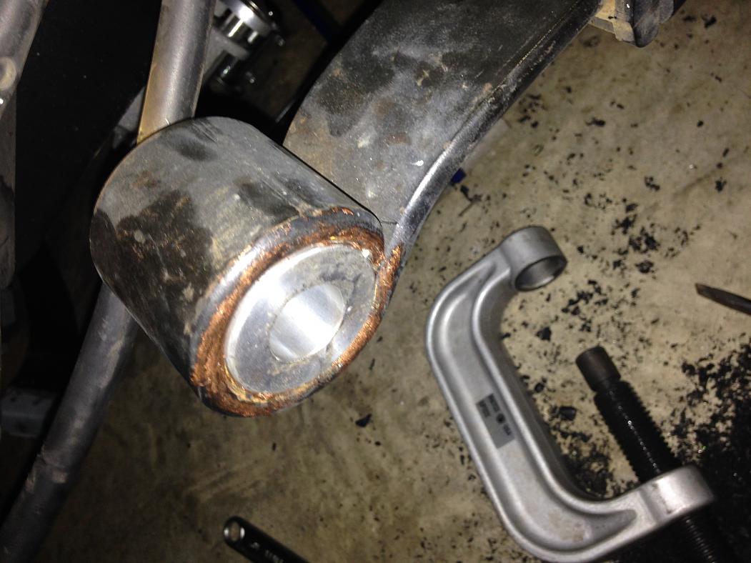

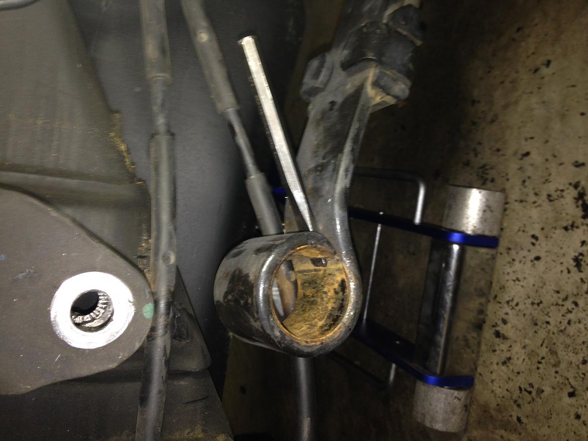

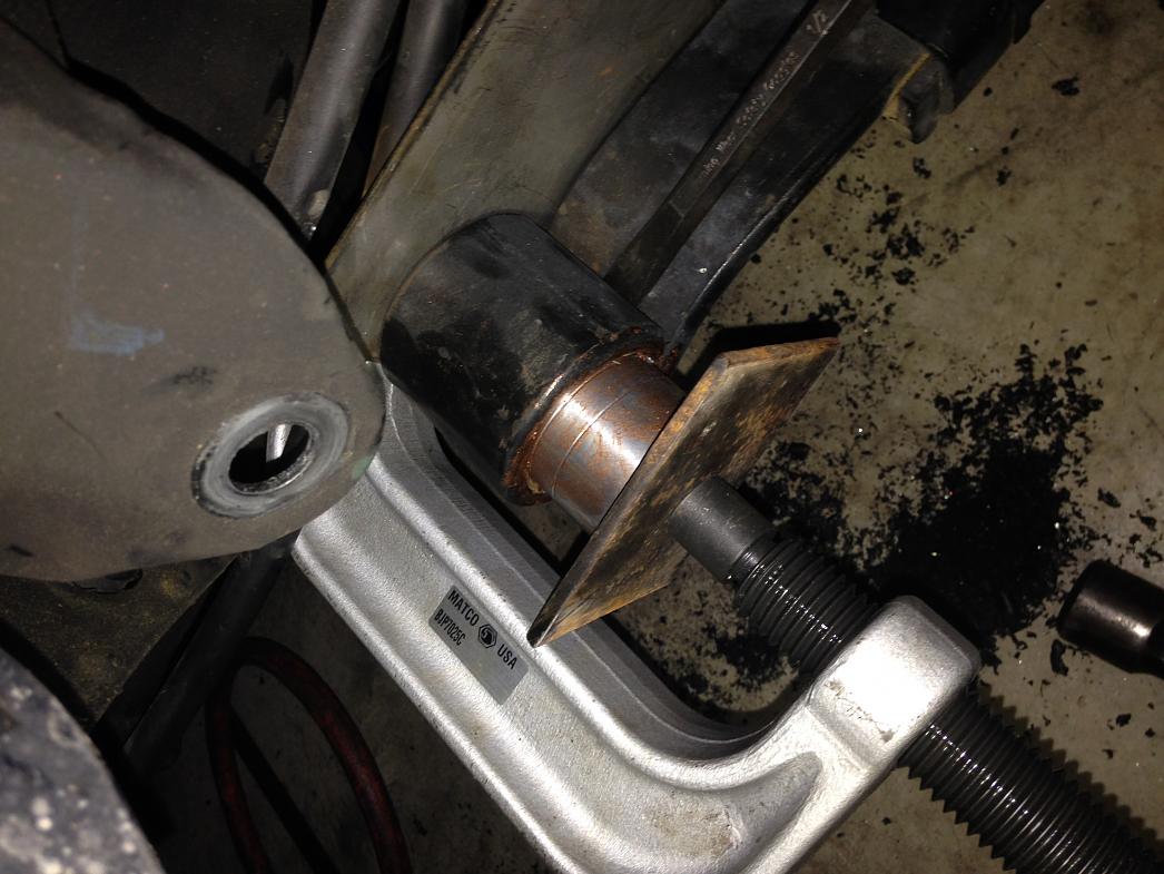

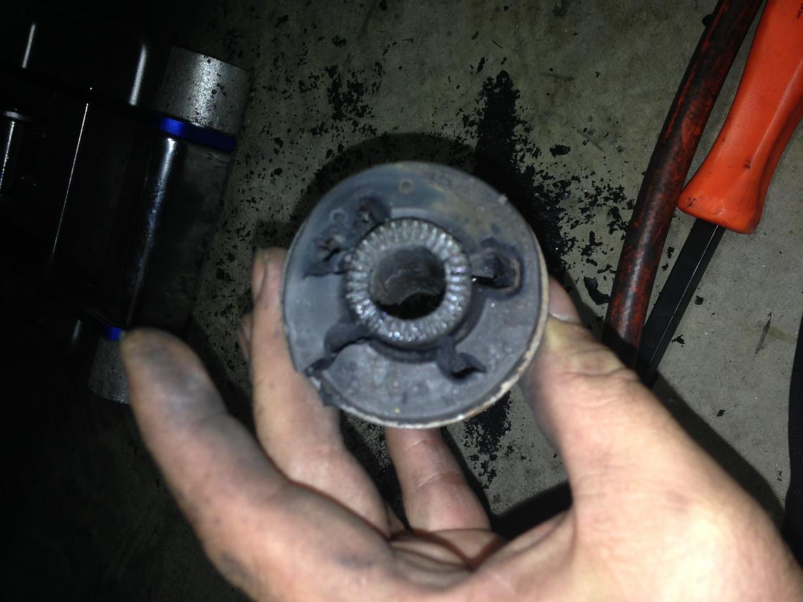

Guys only thing hard was getting the front bushing out. I drill it in 4 places, Air hammer the edge in and air hammer the bushing out. Then used a ball joint press to install the aluminum bushing. One trick to remove and install bushing is to use a chisel to spread the eye on the springs.

bushing are rough to deal with .it may sound crazy but its easier to take spring off and lay on side and smack to **** of bushing .comes right out. that how i did mine.
Yes, Without my pressing tool I would have R&R the spring. But with the press it was fast and easy.
