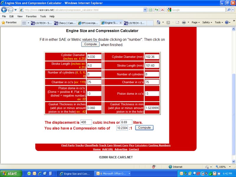

Spoke with Richard a WCCH. The heads will be 75cc chambers. So not taking the cam into account for compression this is what I am working with right now. Seems pretty good to me.

That calculator doesn take into account piston deck height which normally is around .008, which would make you have 10.4:1 but I dont think Id run a .06 HG. A .04 is going to give you better quench but will also net you 10.85:1...
it says gasket thickness plus or minus amount piston is in the hole.

I dont think there is a .068 HG made and I remember in one of his posts talking about .06 HGs.

I use LS9 headgaskets which are 0.059"
