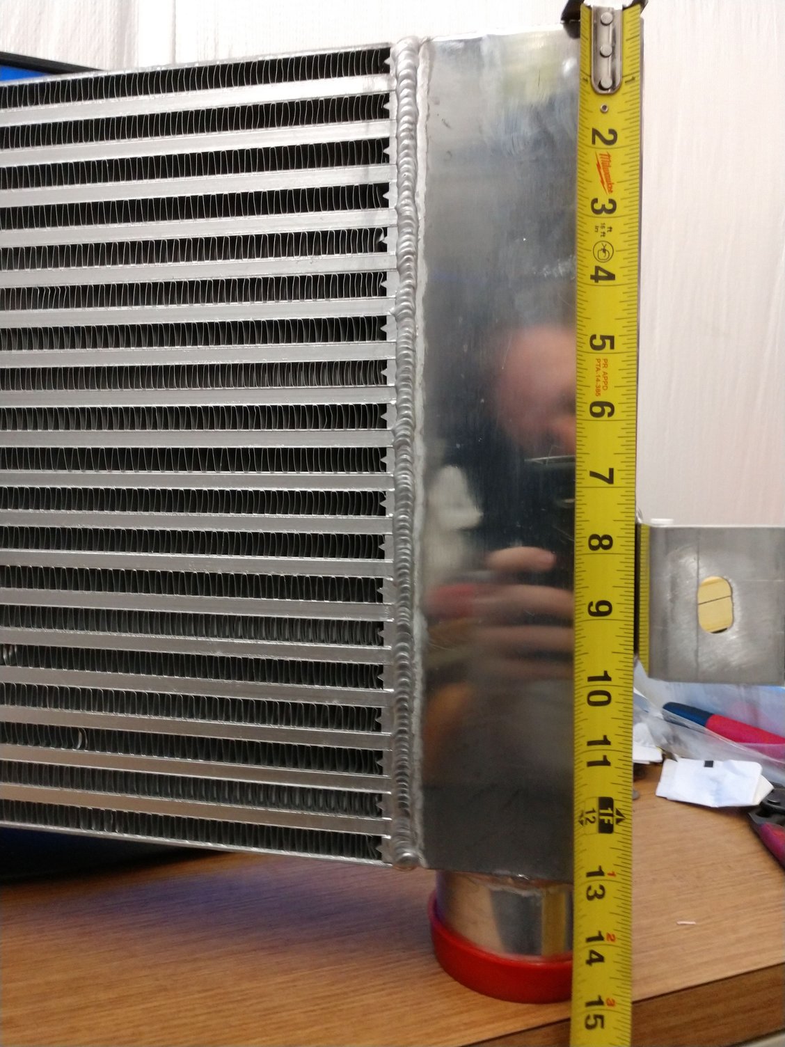

how thick is that FMIC? Im surprised they have square end caps instead of "triangle" shaped ones.
She's a bit thick at 3.5" but easy on the eyes. See photos for the rest of the meaningful dimensions. Seems to be built like a tank. Hopefully tank=low/consistent IATs.
I'm familiar with the ends you are talking about; the name brand items I've seen often seem to use those. I could see there may be some advantages to that setup but I also imagine when you are cramming the air in that it doesn't make as much of a difference from a flow perspective(compared to flow concerns N/A). You could house a small family in the area behind a GM grille so space obviously isn't much of a concern.
