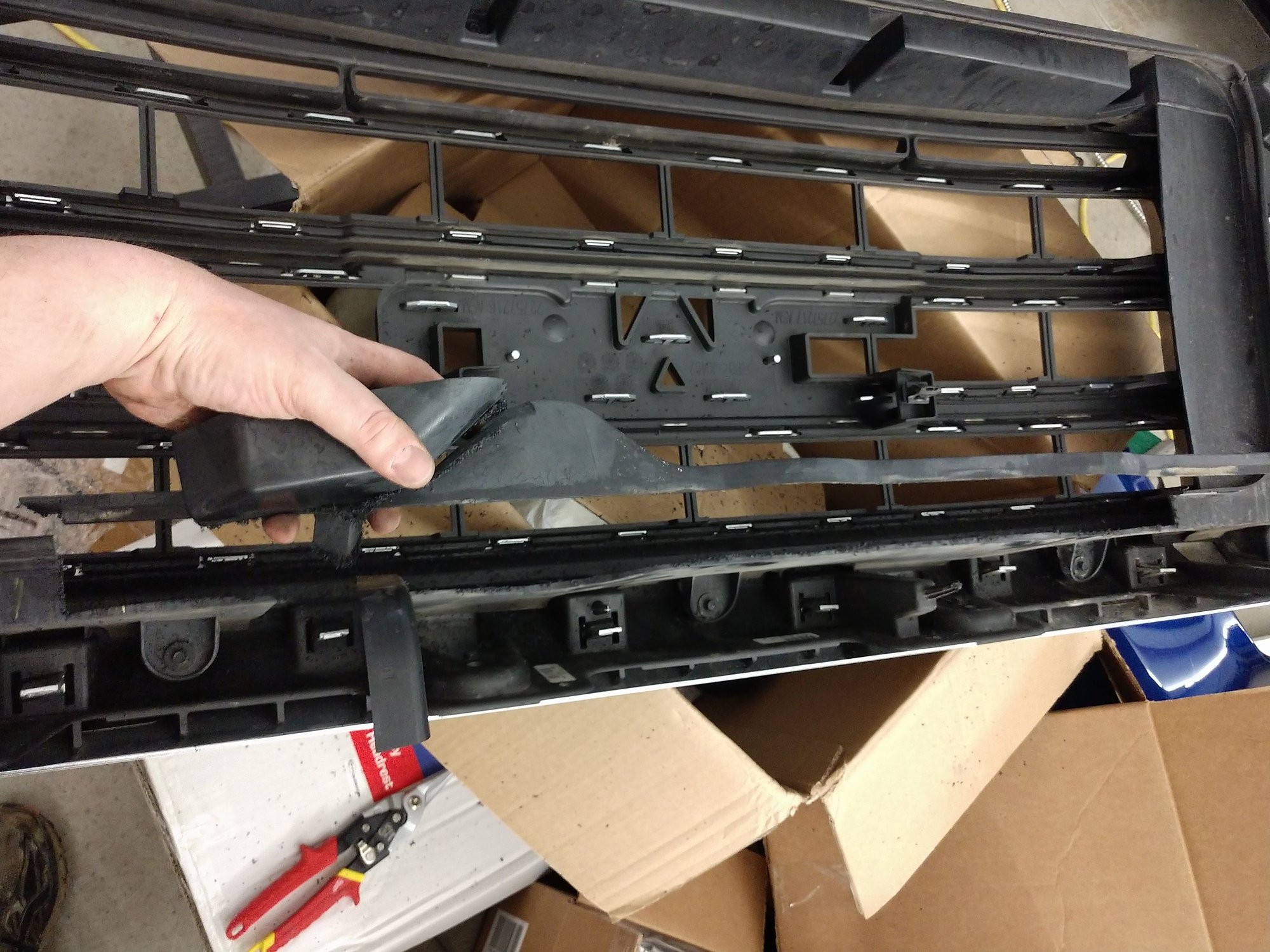

Final assembly I think..hope.
After realizing the grille wouldn't go back on because of the intercooler. It was even hitting on the inlet/outlet so I predict this would have been somewhat an issue with their "standard(shorter)" intercooler. I sawed a few bits off and then realized there is an inner shroud that attaches to the backside of the grille face with about 8x 7mm screws. Next up was two ~1.5" square mounting bosses in the backside of the grille face. Chopped those off and it looks like a truck again.
Tuner asked me to keep it out of boost until I can bring it by but I still got to make some wooshy sounds on the way home. Laughed like a maniac half of the trip.

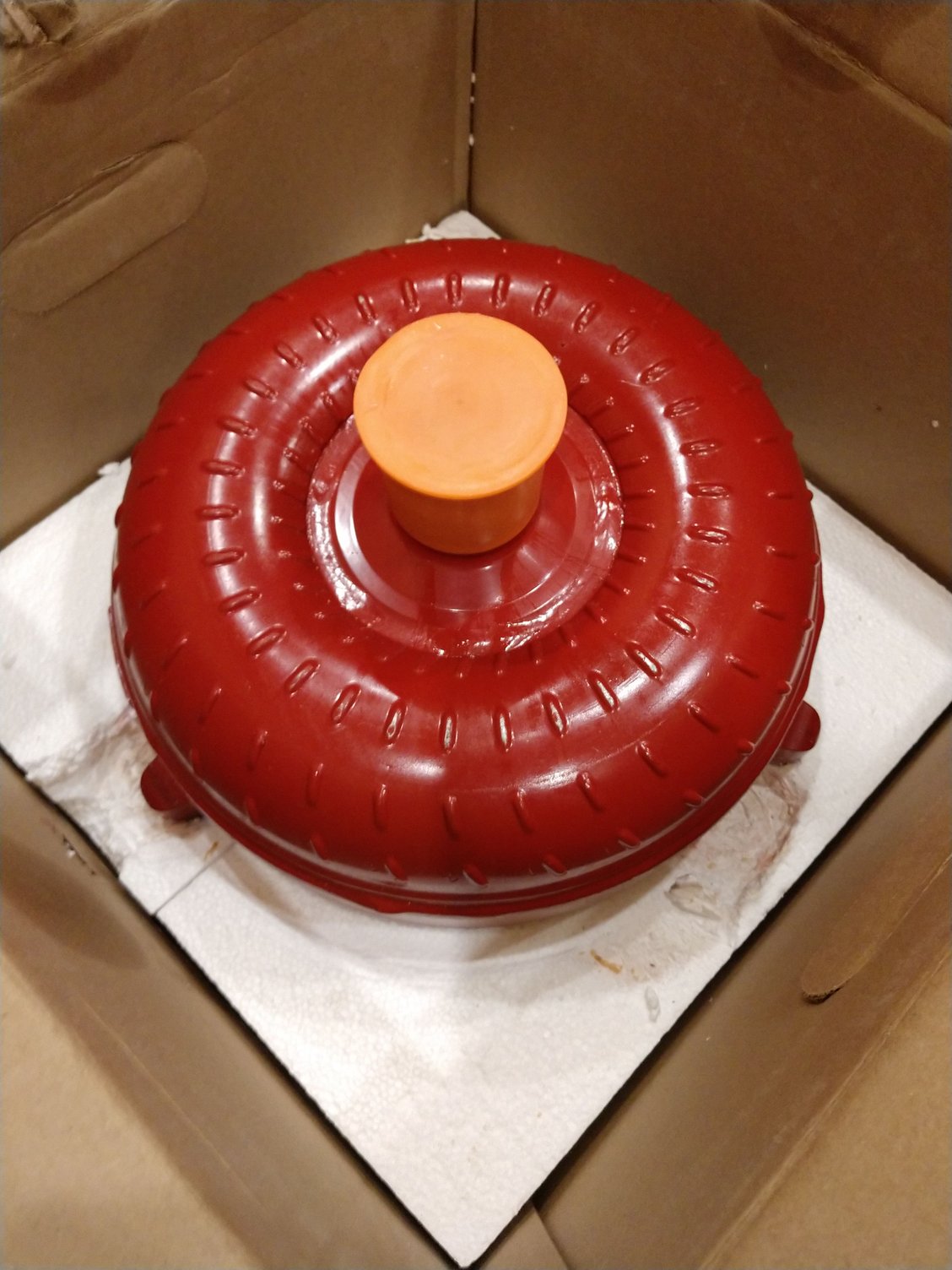

Something pretty arrived today. Dyno is scheduled for Tuesday so hopefully next week I'll have an idea if I actually need this or not.
