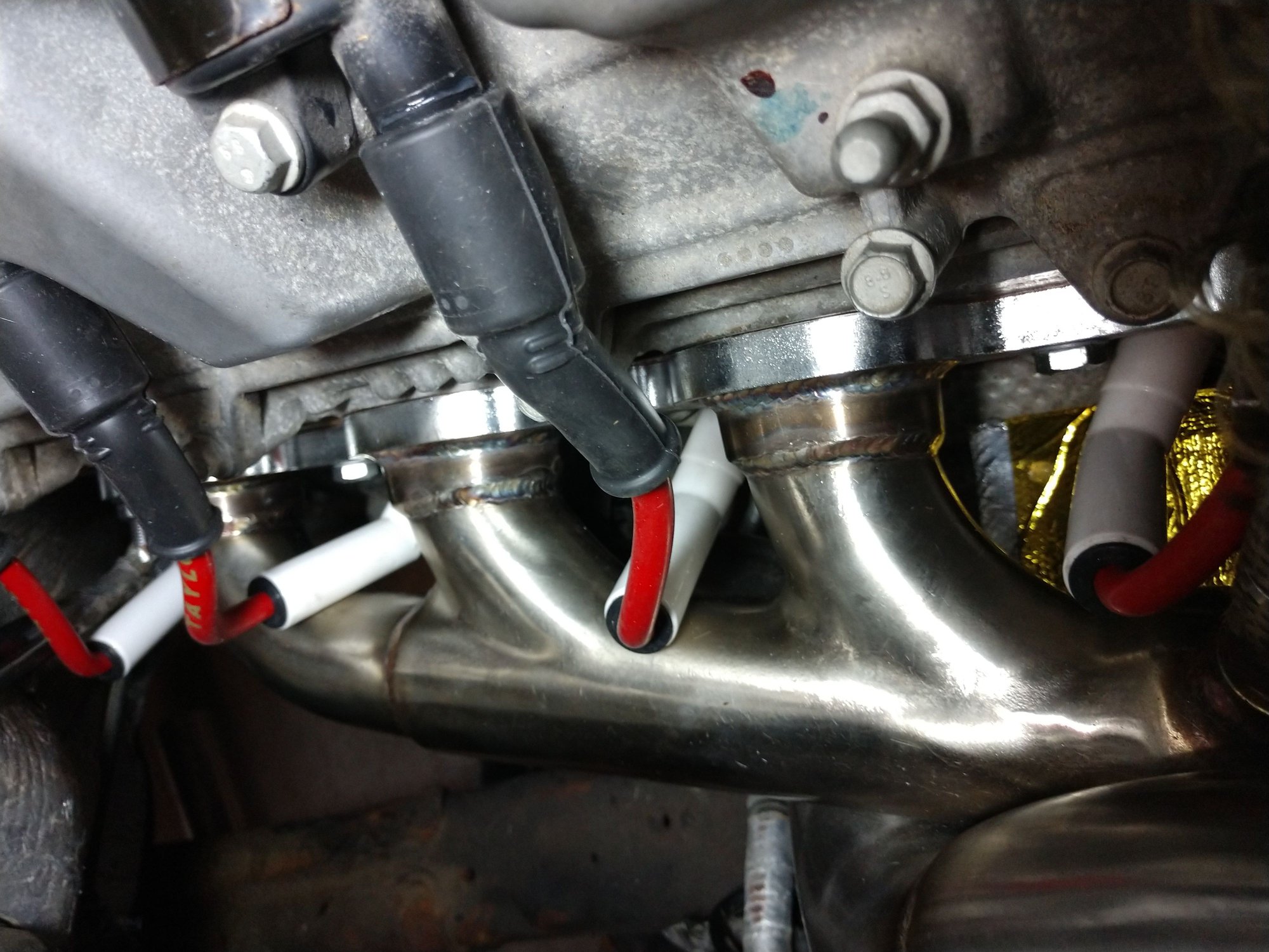

Manifold back on, plug wires on. Ran it a bit with no misses or obvious misfire noise. That's open downpipe. Hopefully next visit to the shop will be exhaust and then road testing. See you guys next year!
Nothing exciting but it ran and didn't blow up. Idled down decently after a minute:

Congrats man. That start up vid is huge

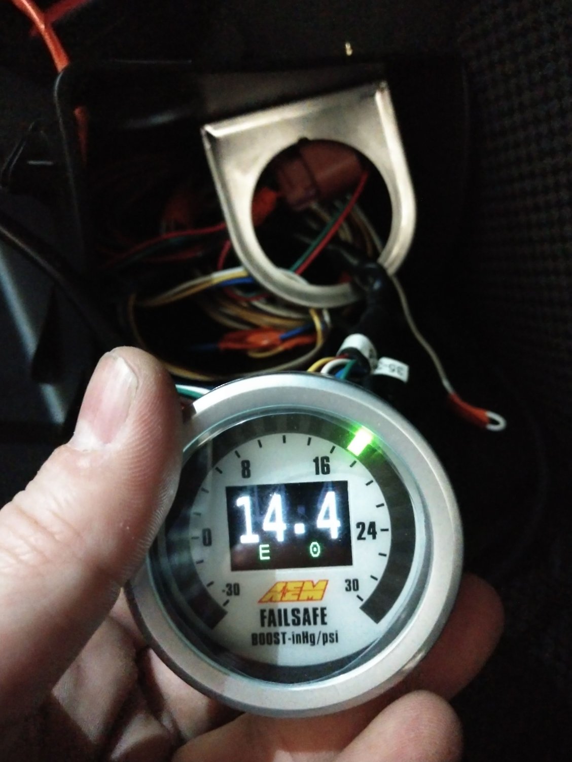

Picked up a cheapie gauge mount at O'Reilley. Using this to mount the AFR/boost/etc. gauge in the (ashtray?) area. Great place to hold the slack and extra wires I'm not using yet. Probably make a panel later on for more attractive mounting.
