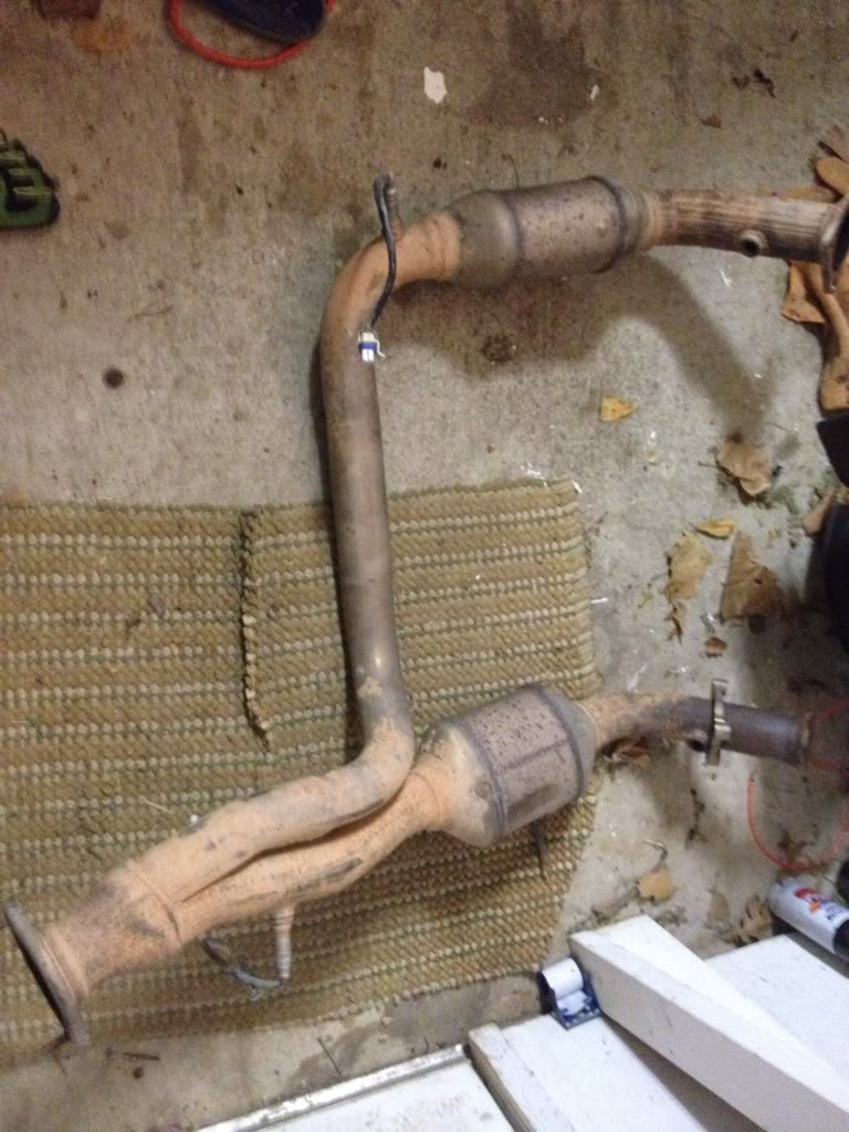

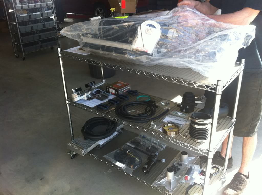

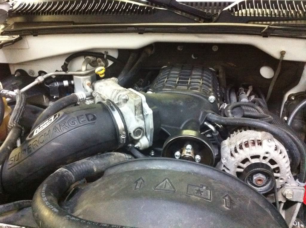

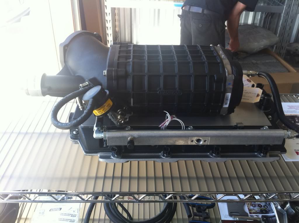

I had Whiteside Customs in McKinney, TX install a Maggie TVS 1900, Pacesetter ceramic coated LT headers with catless mid pipe. He also installed. installer tried to talk me into the more expensive KOOK's set up but the Pacesetters were more in my budget. I also had him install a Street Scene rollpan.
The truck was dyno'd yesterday on a Dynojet 248 and the numbers have me scratching my head a little.
Baseline numbers were:
170RWHP
157RWTQ
Those just seem pathetically low. Like 6 cylinder low. Don't most of these 4.8's put out around 220 or so RWHP?
Post blower numbers:
313RWHP
358RWTQ
My installer explained that this particular Dynojet consistently reads about 10-15HP lower than others and that my wheel/tire combo is responsible for another 20-30 HP loss.
Does this sound right?
At any rate I picked up 143RWHP and 201RWTQ. The Maggie TVS1900 more than doubled my TQ.
170RWHP
157RWTQ
313RWHP
358RWTQ

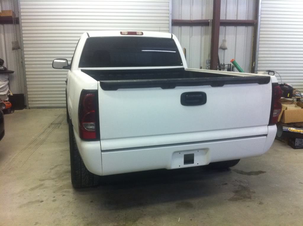

I picked up my truck last night from Whiteside Customs in McKinney. It worked out better to do that instead of pick it up this morning.

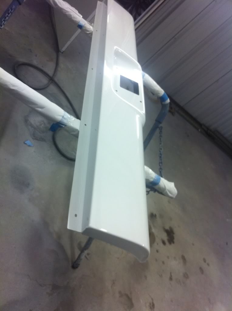

I'm very pleased with how the steel Street Scene rollpan turned out. I plan on getting the flip down license plate kit and installing a hidden hitch.http://
