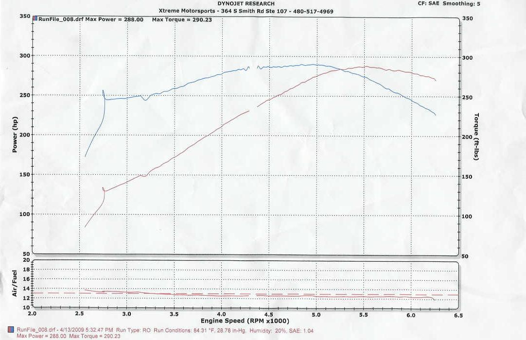

here's my graph... prettty much the same as sig except i was running a 3inch 2 chamber flow and 31 inch all terrains! I should have pulled my air box lid it was worth a 1 mph at the track.
I like the cam its a little mushy under 3k but not as bad as everyone makes it out to be. I get 20mpg and it drives great. This is a stock lm7 with a stock truck intake and t/b. It is tuned on 87* because its my daily driver. There is more in it, the truck runs very hard to the 1/8th. Then falls on its face lol only picking up 16mph on the top end.
2001... 204/211 .525/.525.. 116
