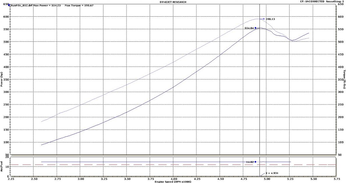

I'm having the same issue with my truck and have been checking everything on the dyno to figure it out. I'm going to put better valve springs in soon and see if it helps me. I don't understand why I lose 50rwhp but then it starts to recover and it only does this above 8psi. Here is my sheet.
