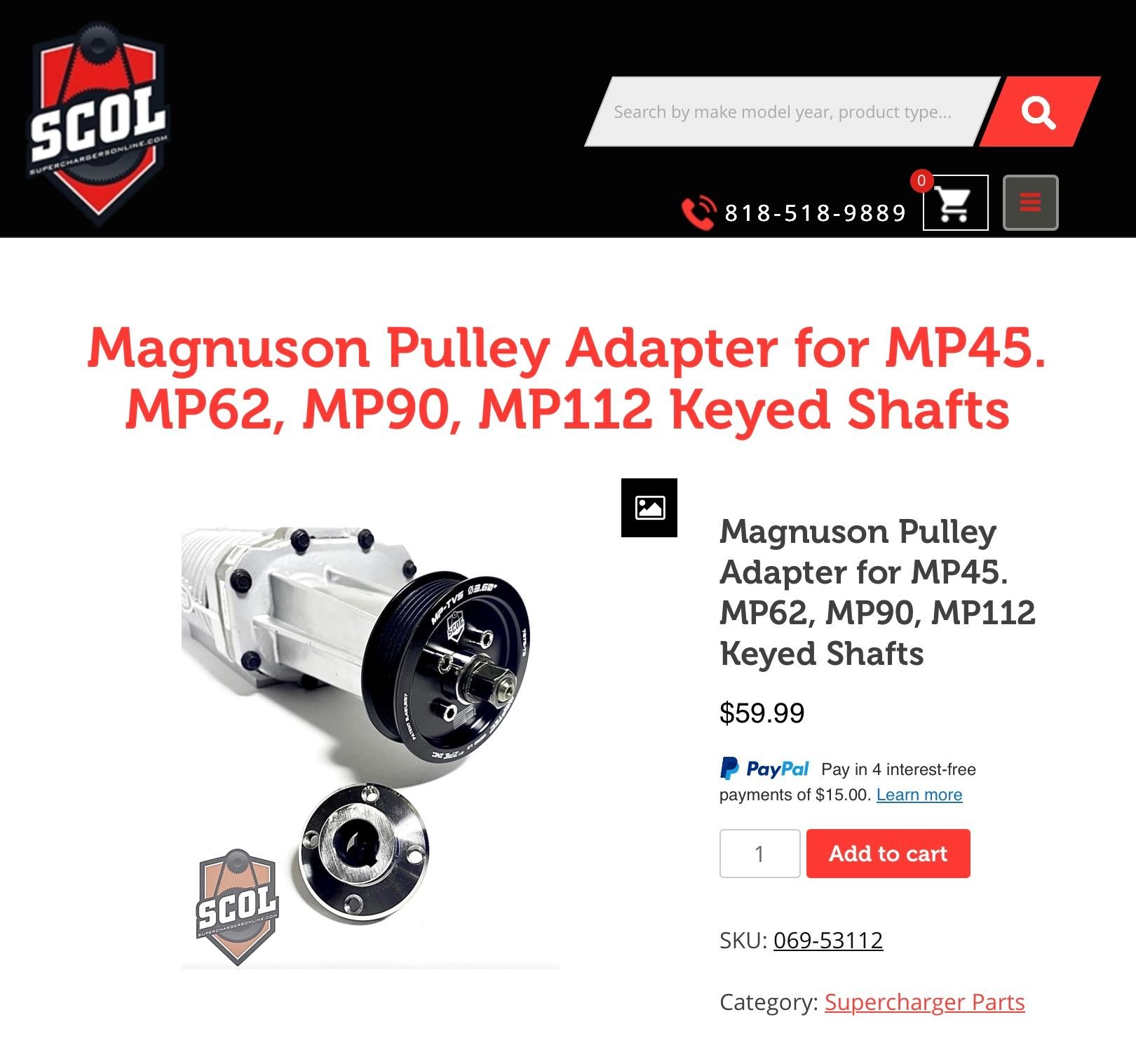

I have this adapter from SCOL and wondering what type pulleys fit it. Thanks

Probably all the TVS pulleys.

Magnuson style TVS pulleys. Not the Heartbeat style. I like the Griptec. MP300BB3Z6 is a 3.0 6 rib. MP280BB3Z6 is the 2.8 6 rib. I have run both of these on my MP112 with the same adaptor.
