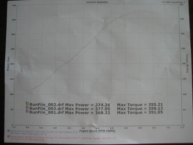

I finally got my new setup to the dyno, I was shooting for 375 hp and reached my goal. I wish I would have had time to dyno the tuned 100 shot on it. I would bet it would see 500/500. I got 377/356 out of it. Thats a 52 hp increase over my old 325 cam only setup. Old setup was tr224/112 and it made 325/325. It will be the last dyno for the 5.3. I plan on dropping in the built LS1 on the 8th of next month. Mods are WCCH stage 1 5.3 heads milled .050", 10.6:1 comp, EPS 226/230 112+4, Circle D 4c mulit disk, TBSS intake. Heads and cam will be for sale next month sometime. Dyno'd 3rd verter locked. let me know what you think....

Very nice curve!!

Nice numbers!

now take it to the real dyno(the track lol) nice numbers but dyno's lie they lie I tell ya ahhhaahahaahhaahaa

Thanks guys!
oh yeah bud, I know. I missed the good weather this year to try for my 7.9 slip. That was the goal, 375 hp and a 7.9 et 1/8 mile. I did run in 2700' da, and did a 8.34 @ 85mph. It got too hot to fast, and I have a forged Ls1 waiting. I want to put it in and get it tuned and get my trans built up before Goat fest in september.
I do think if I would have had one more run, It would have hit 380 hp.

Not bad at all for the ole 5.3.. I'm ready to see what it will do with the ls1

Those are some real good numbers!

Pretty impressive. Youll be hitting 400+ with the ls1

Conngrats man!!! Impressive #s!!!
