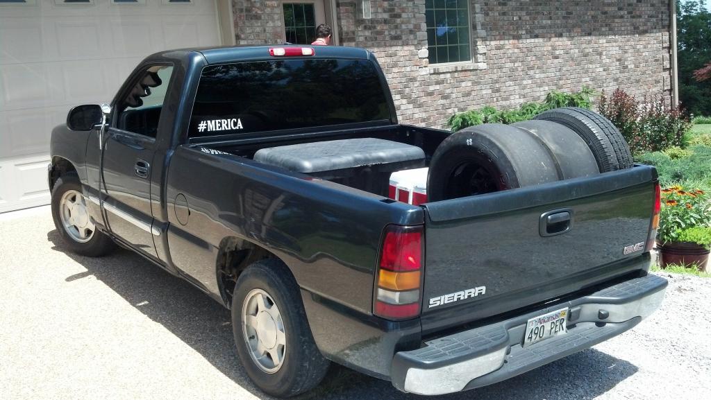

Going to try the track again today. Loaded up.

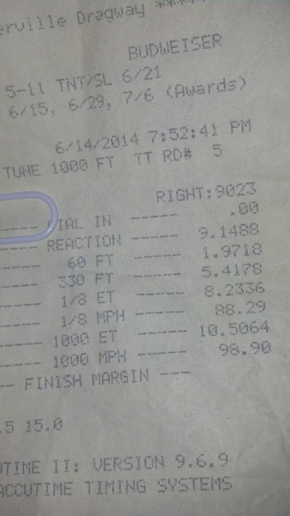

Well, I didn't improve much. I dont feel like I'm going to go any faster without some changes. Truck will pretty much mph between 88-90 every pass. Haven't messed with the AFR or timing yet. Its fat, low timing, and heatsoaked on most passes.
What I am concerned with is my 60'. A 1.97 is the best I can pull off. Most passes are 2.0s. It pushes through the brakes with the 2 step anything higher then 2500. Only builds 4 or 5 lbs. This is also with the syty shuffle. Which makes for an aggrivating procedure to stage. I have to stage both beams, hit neutral, rev, back to drive, brake boost, 2 step, then launch. Hence that great r/t I guess brakes are in order before I'm going to go much faster.
On a positive note. The truck with appropriate air pressure (15lbs) goes very straight down the track.
