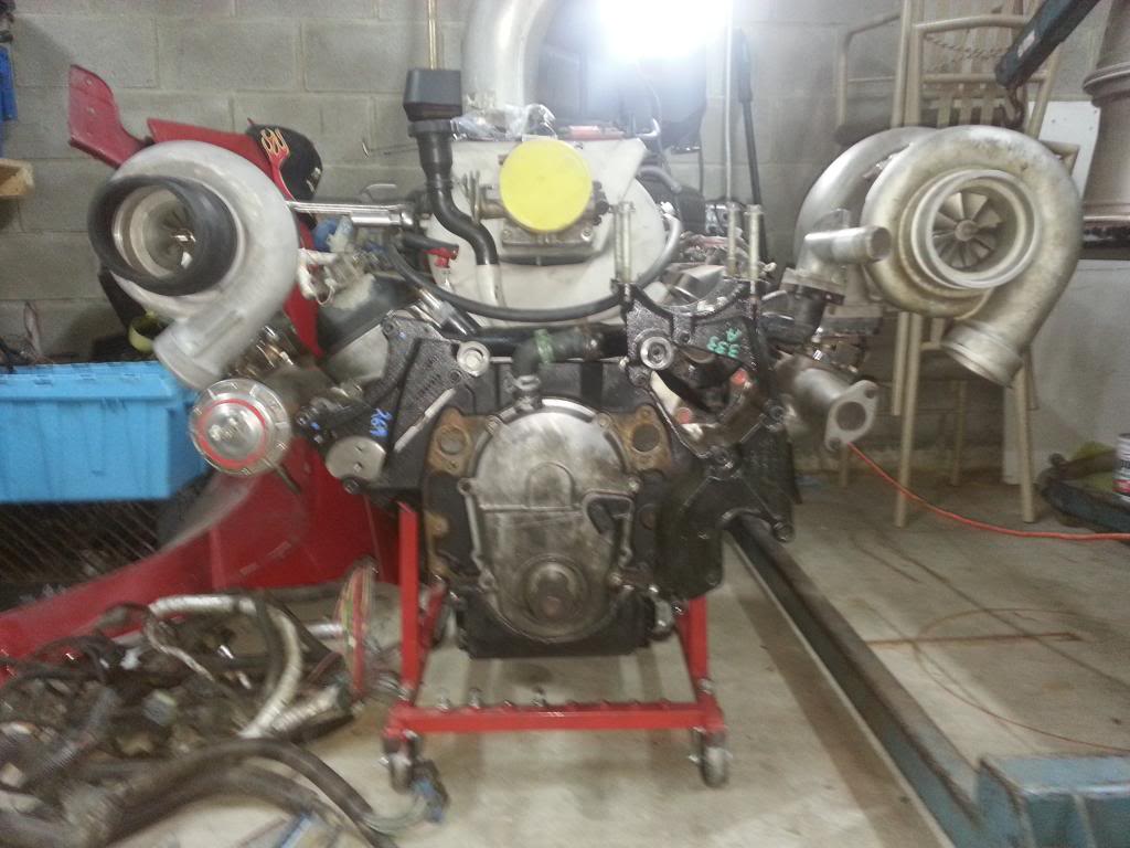

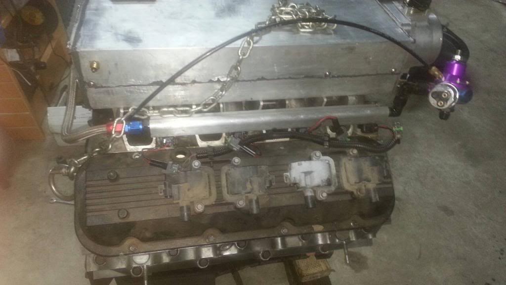

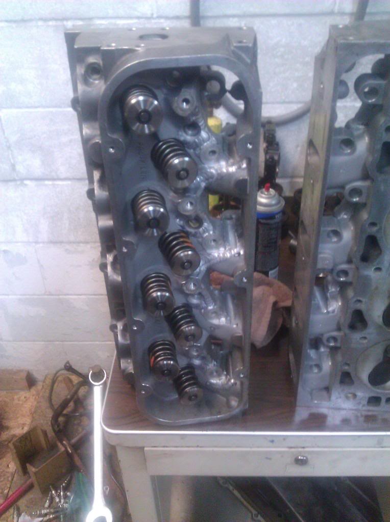

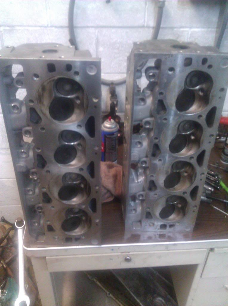

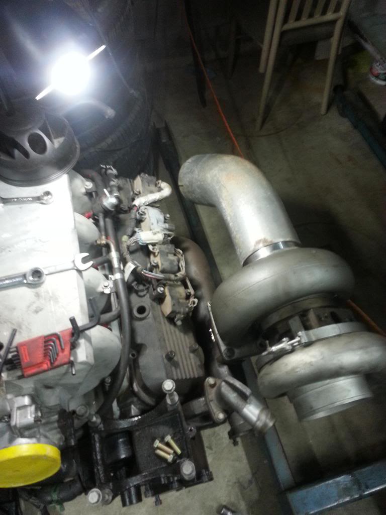

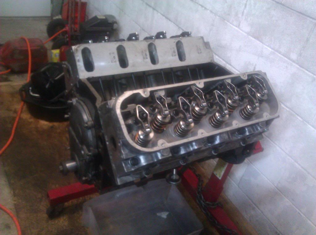

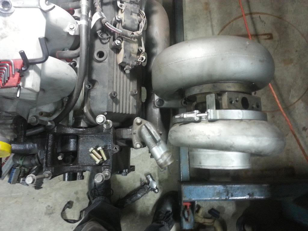

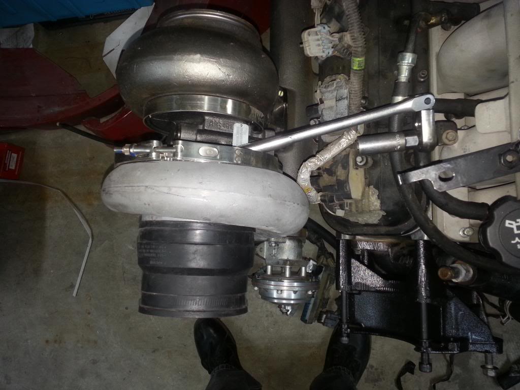

Well as some of you may know my 04 1500 siverado has had an 8.1 since 08. First was a stock engine with a megasquirt then it was a slightly built motor and now it is this....

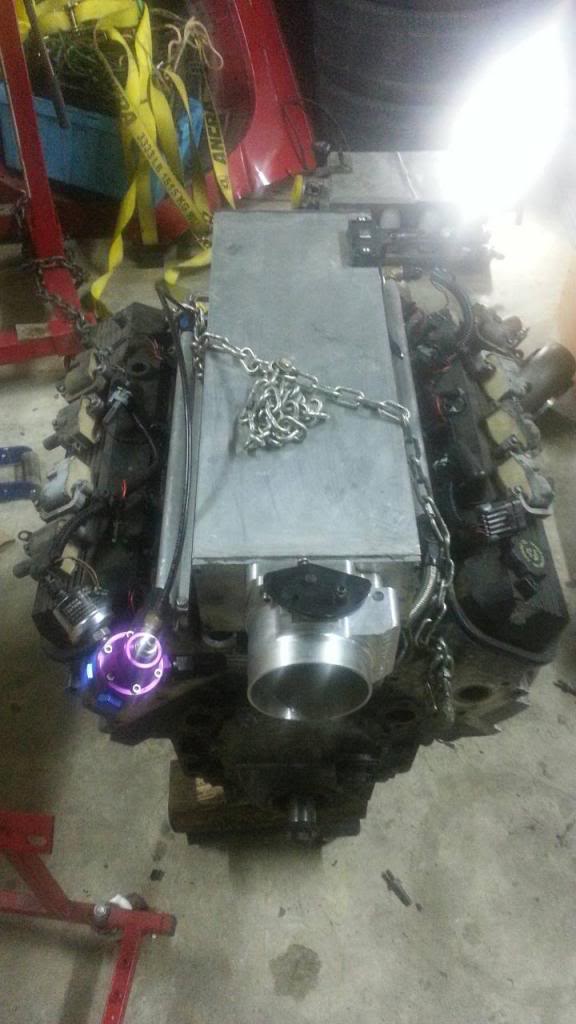

looking great! what kind of numbers do you expect out of this?
top photos were teasing. it looked like an engine with just a different intake on it, i was hoping there was something else. lol

all the same engine was doing alot of mock up the big throttle body setup is going back in truck with raylar long block. I have a t6 rear mount. it is going to get tuned with that setup, then imma work on fabbing up the twin setup in the truck.
I also am putting in a 1 ton corp 14 bolt new clutch and making updates to fuel system
The old setup with ported heads and zz502 cam made 640 rwhp and 680 rwtq on 6 lbs. Hoping for at least a 1000 rwhp with new motor. then put the twins on and see if i can squeeze some more out of it.

Just one problem, its not in the truck
Old Apr 30, 2013 | 11:53 AM
xx_ED_xx's Avatar
Joined: Jun 2007
Posts: 2,229
yup, working on it between playing army. you cant see the oil pan but it has been modified holds almost 3 gallons of oil

Sorry for the stupid question but are you keeping the rear mount and putting twins on it? Would be a pretty bad *** setup.

nah just doing twins, rear mount taking up alot of real estate under the truck etc
I am almost debating doing the twin 5 inch out out the hood and cutouts to run it thru a dual 4 inch system while cruising. Then if something happens while racing i can see it or not see depending how bad it is and blows all over windshield

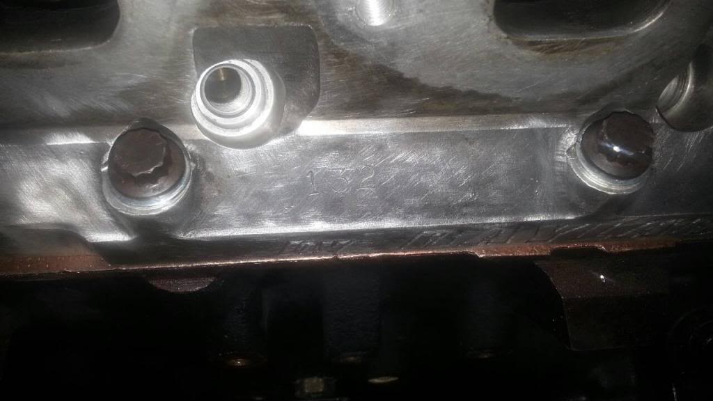

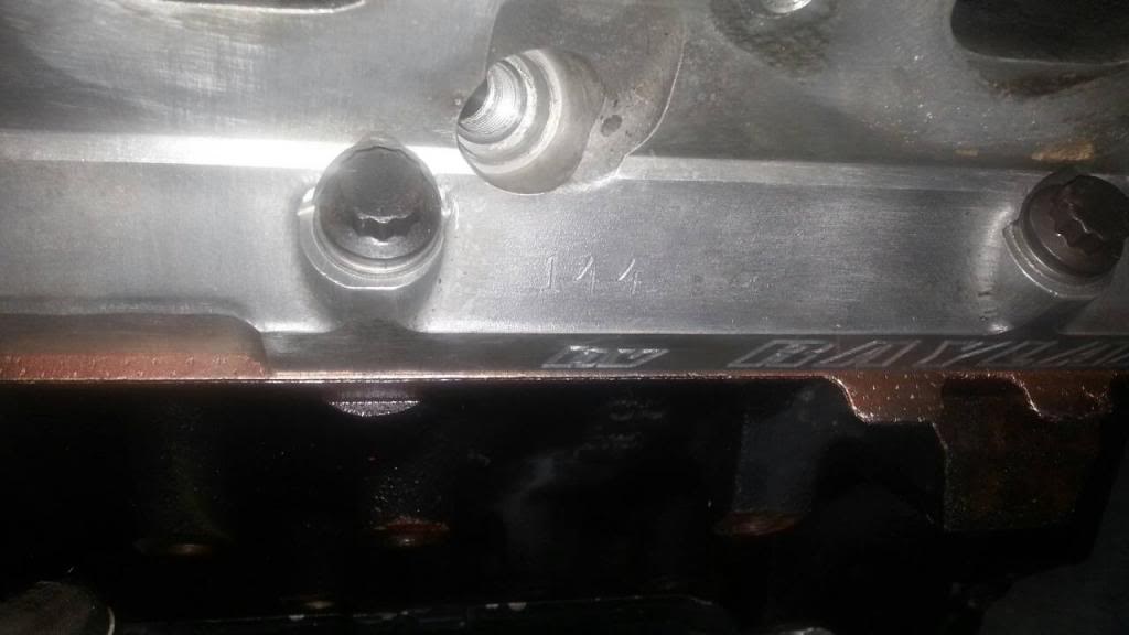

looking sexy.. found out dart makes heads and blocks for it
Old Apr 30, 2013 | 05:20 PM
xx_ED_xx's Avatar
Joined: Jun 2007
Posts: 2,229
yeah iron and iron
Old Apr 30, 2013 | 05:23 PM
whippled 8.1l build's Avatar
Joined: Apr 2012
Posts: 340
From: thurmont, maryland
yup but they are borable to 4.6"
