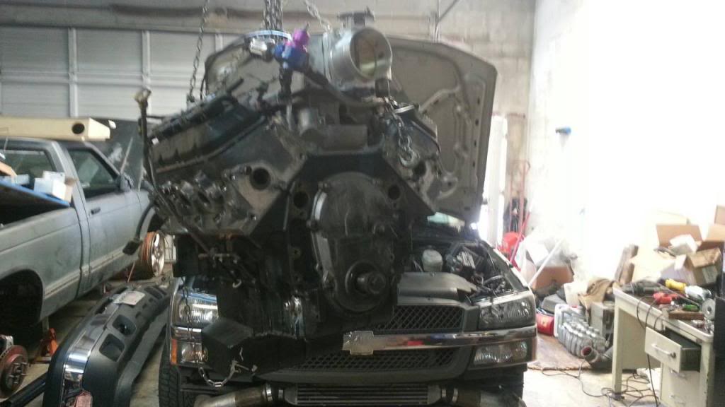

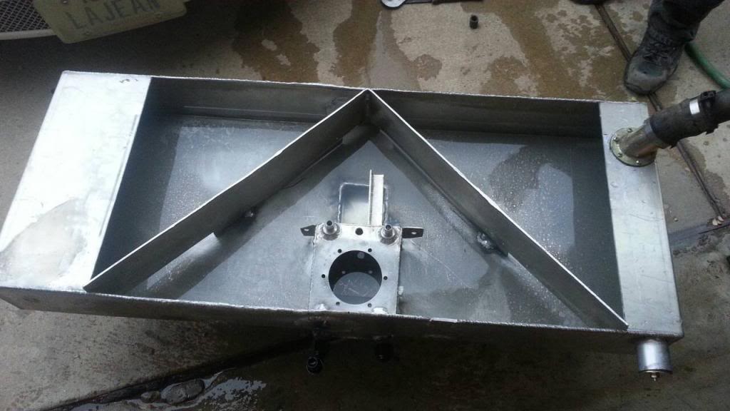

Slowly but surely getting there... I took the fuel cell out to add some more capacity to it and sump it and baffle it etc.
should hold close to 34 gallons behind the tires

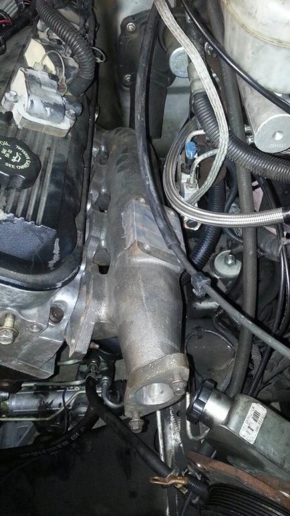

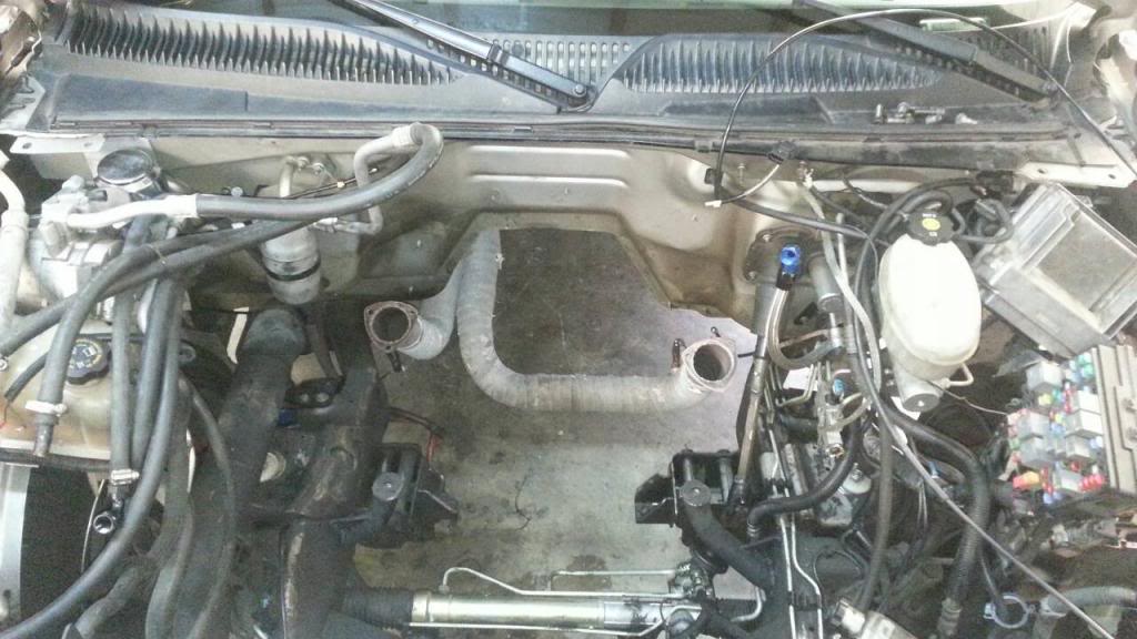

Also sadly to report my turbo manifolds wont fit the truck. unless i prefer to not steer it
Anyhow on to the pics. My new clutch should finally be here today more pics to follow..

Is there enough room to get creative with universals and heims to create a new steering shaft?
Old Jun 3, 2013 | 02:42 PM
  #28
xx_ED_xx's Avatar
Joined: Jun 2007
Posts: 2,229
I could but right now I aint wasting the time or money I test fitted them on a stock 8.1 crew cab. The stock head bolts make them an issue as I well because of their height

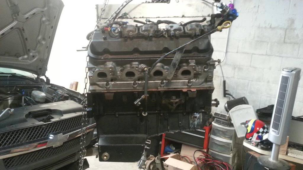

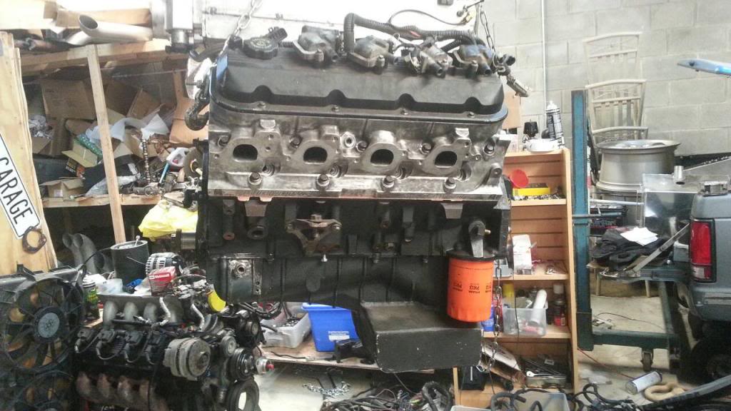

Well, its alive again. the cam isnt as lumpy even though it has more lift etc. This pos 250 amp alt i already replaced once beat its previous record of 3 months and now only lasted a day. Wont waste my money on another one of them. sad i put the stock v6 alt back on and works fine... wtf

What cam you running now, specs? You were on the ZZ502 correct?
This will be great when boostin.
