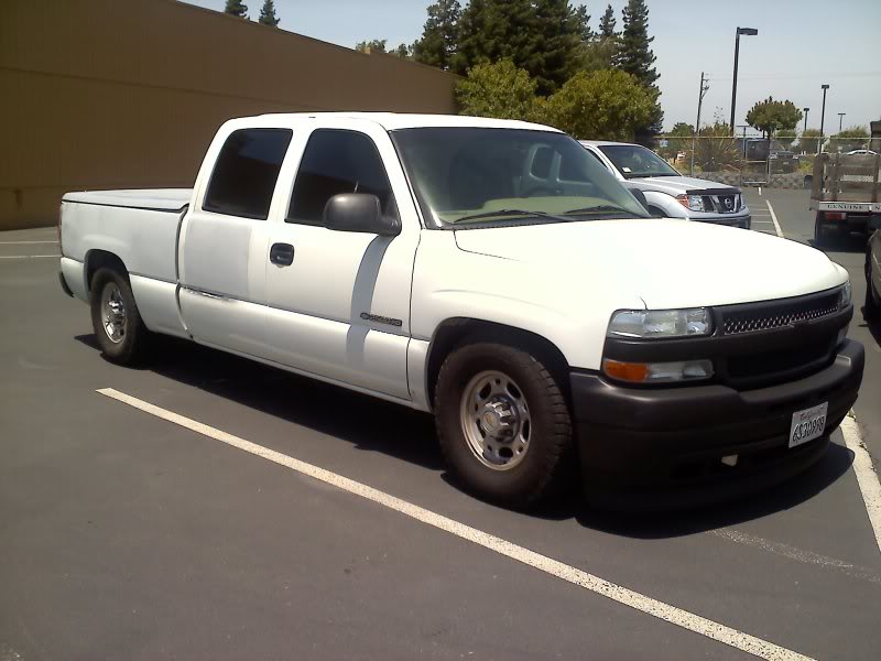

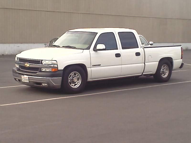

its got the djm kit with drop keys added to get the front even lower, surprising its runs really good except if you hit a dip ofcourse and it hits pretty hard since its pretty much on the front bumpstops. and its got A/T tires since it used to be lifted before i bought it, bought some stock wheels and swapped the tires over cuz the other wheels stuck out.
