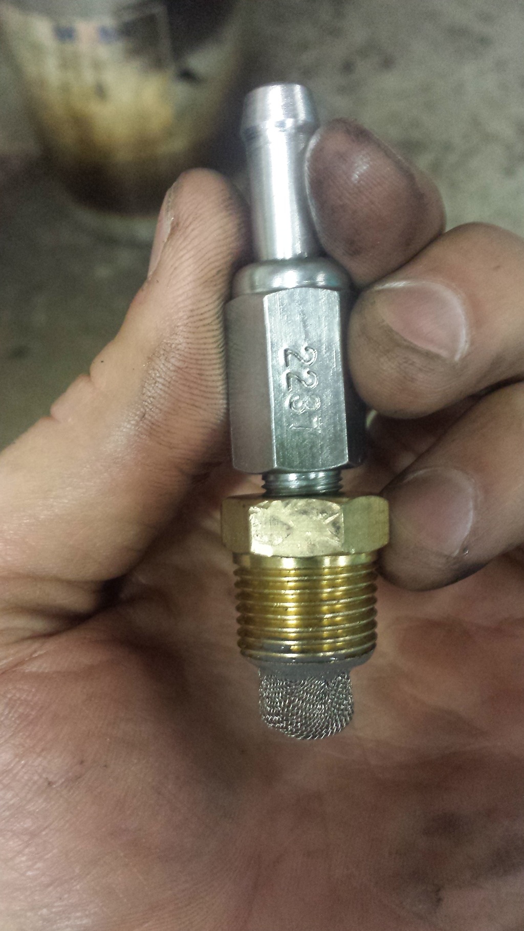

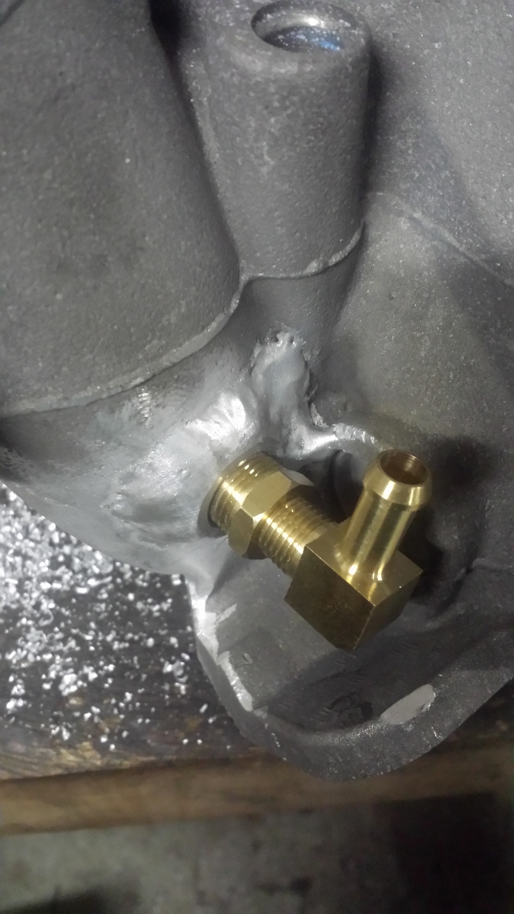

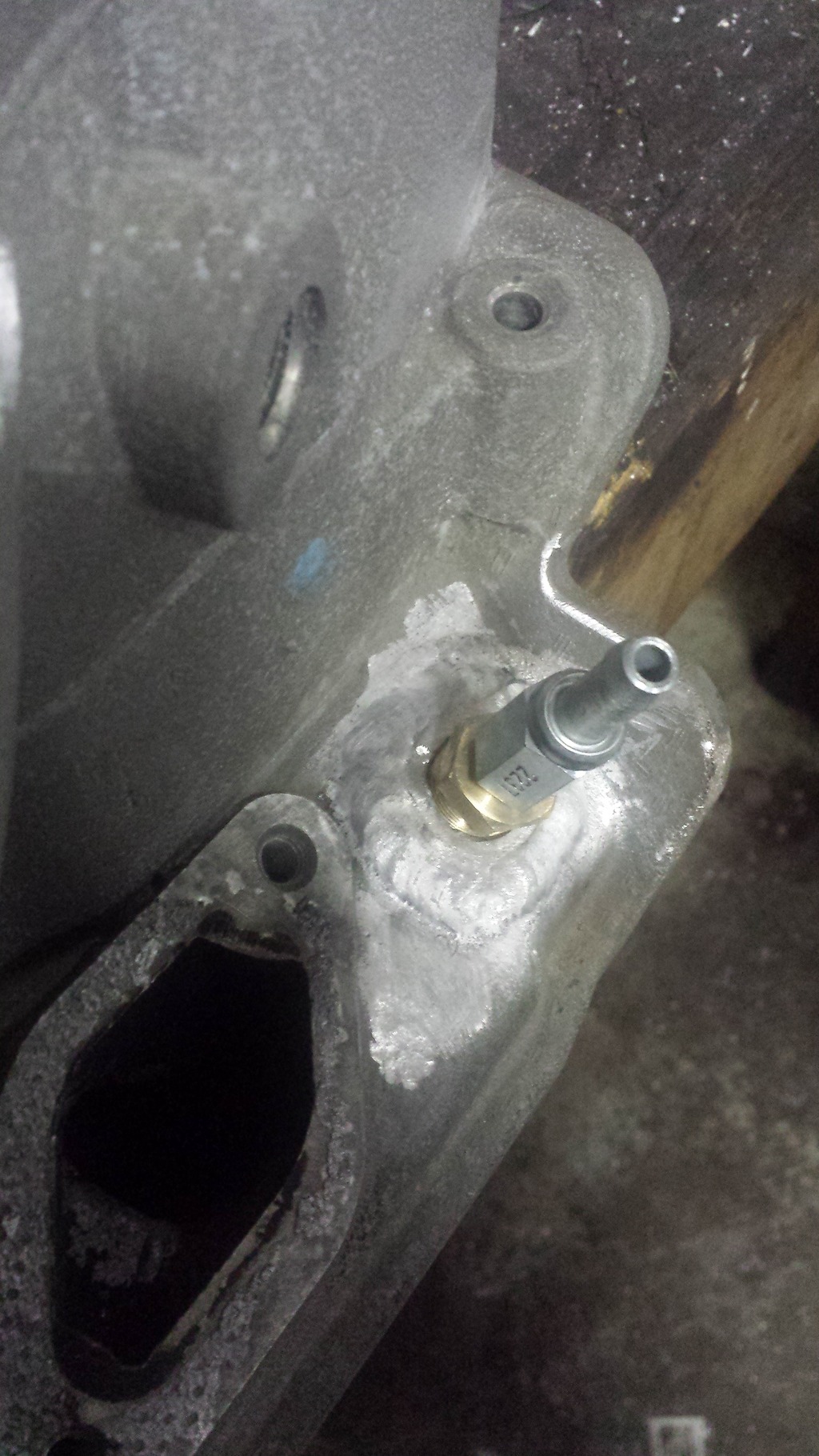

Originally Posted by Whipped383
So here is how I redid the PCV system
Attachment 93500
Put a weld bung below the throttle body for vacuum
Attachment 93501
And another at the back for a PCV valve
Attachment 93502
I put a little screenon the PCV valve fitting for a baffle.
Thoughts? Opinions? Criticism?
Not sure if you're still following this or not. I'm just mechanically inclined enough to think I can pull this off but not mechanically inclined enough to know the answer to this: Why did you decide to redo the PCV system? Does the modification somehow defeat the factory PCV or is it a necessary improvement. Can I get away with leaving the system as is? Thanks,
