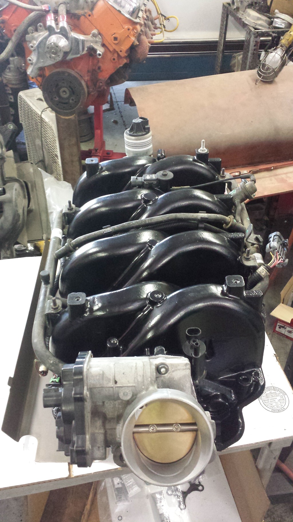

Not happening without major work. There are several thin sections about .090 thick that will break through. The throttlebody is 75 mm, and the bigger step out at the bottom is 76mm. You could safely go to 77 or 77.5mm, but the gains wouldn't justify it unless you could weld it without warping or going thru the thin sections, bore it yourself, and could make your own butterfly. I can, and I just may do it to see what airflow I can get. I always prefer to modify stuff rather than replace it. So far I have ported and smoothed one of mine and picked up a decent seat of pants gain, but I have not slabbed (thinned) the shaft in my mill yet. The porting gain runs between 85 and 100 CFM, depending upon the different variables as it is stock. I'll slab it later and report. Keep in mind that the x-over tube needs to have the Helmholtz resonator removed along with the shroud divot removed also to have the throttle body help as much. Those mods allow the airflow to be more laminar into the bend at the t-body. Then if you believe me, remove the screen and see the gain, if you don't think so then replace it. Mine has been out for several tanks of fuel and no codes or no goofy trims either. Do the airbox and inlet too. Get the headers on and then change the muffs too. TIMINATOR

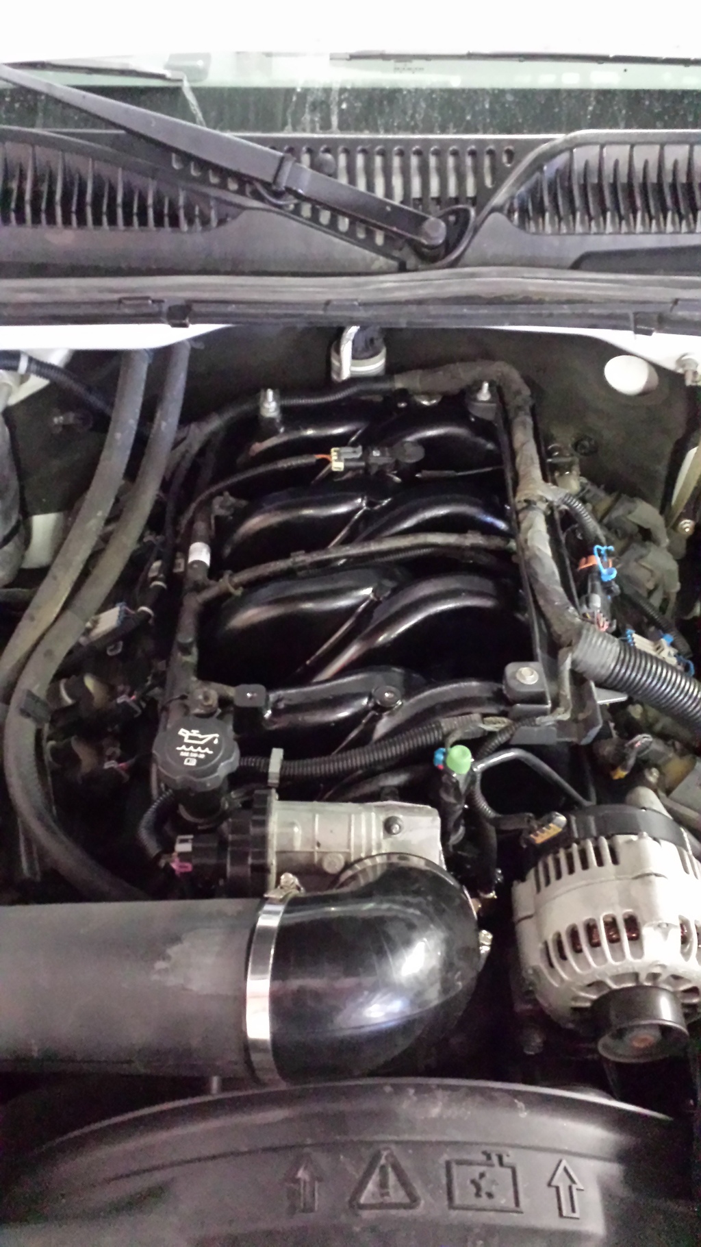

Well intake is on. Not as much as an improvement as I thought it'd have but the truck is heavy so butt dyno makes it hard to tell. Above 3000 rpm it comes alive tho. Definitely worth it just hoped for more.

My theory is that what y'all refer to as the "baffle" was not designed as a baffle per se, IE to reduce intake noise, as in the air box, or as a deliberate horsepower limiter.
I believe the design intention was to have the air enter at the center of the manifold BETWEEN all of the runners to allow a better balance of the airflow to ALL cylinders. The effect of better cylinder balance allows the engine to run smoother making more HP, Torque, and better fuel mileage. It also keeps cylinder balance codes from being set.
GM also did something similar with the Grand National turbo manifold, and early crossfire manifold, but with actual baffles to even out the individual cylinder flow.
I am nearly done with my flow bench adaptors that will allow repeatable results between different 8.1 manifolds, with and without throttle bodies, and different sized throttle bodies, and will allow me to measure each individual runner's flow. Then we'll know for sure.

I can tell you throttle response is much better. But the overall noise is a lot louder.
