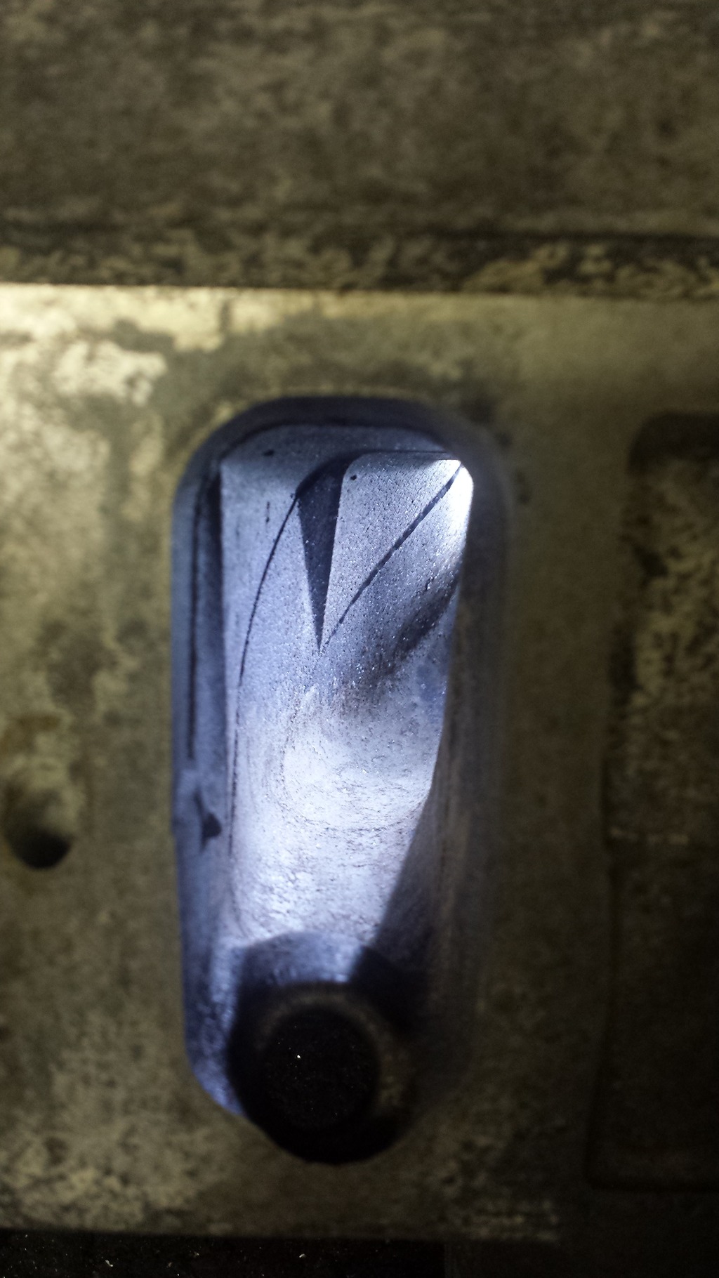

Thanks for the compliment raylar. I am not finished yet I still need to smooth it all out that's just what I removed with my air saw.

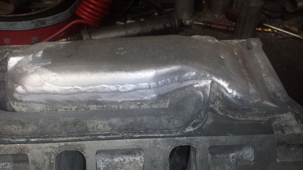

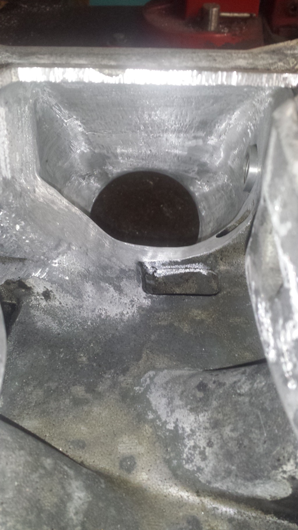

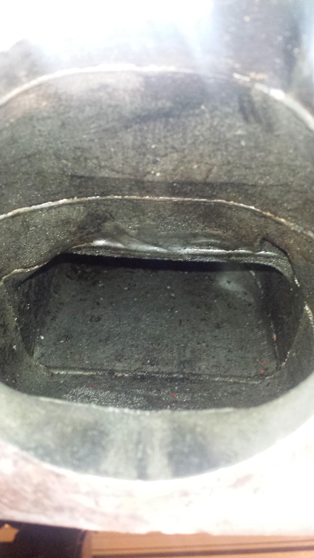

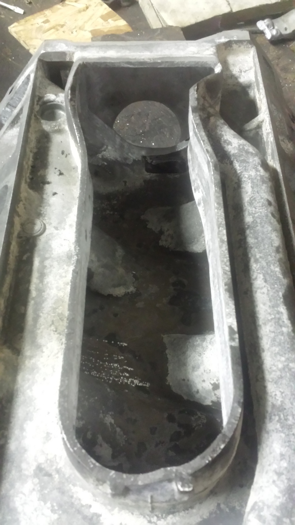

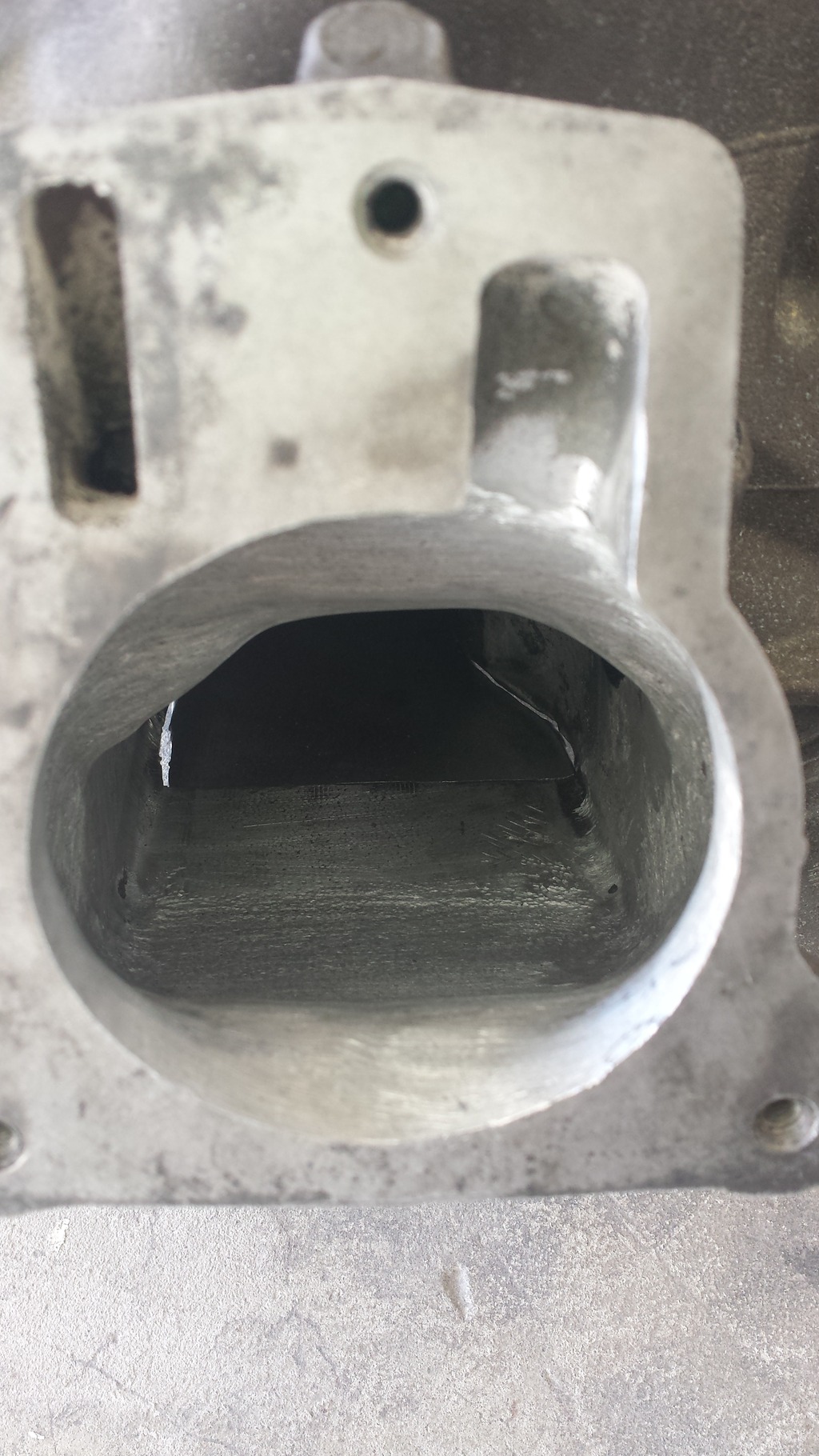

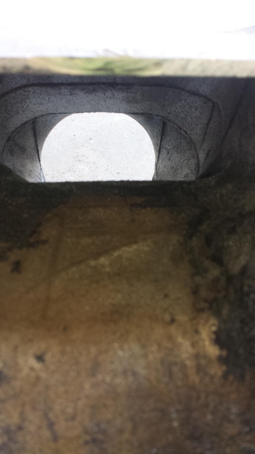

Size:  154.2 KBName:  20150308_141244_zpsrxkmffbg.jpg
Size:  125.5 KBName:  20150312_195513_zpsnbyounzm.jpg
From this
Size:  400.2 KBName:  20150318_195522_zpsbeyinulq.jpg
Size:  412.3 KBName:  20150315_100902_zpsragyezmx.jpg
To this
Size:  177.3 KBName:  20150319_203318_zpstsq3nq08.jpg
All welded up

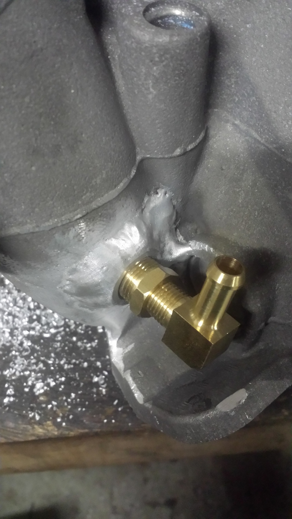

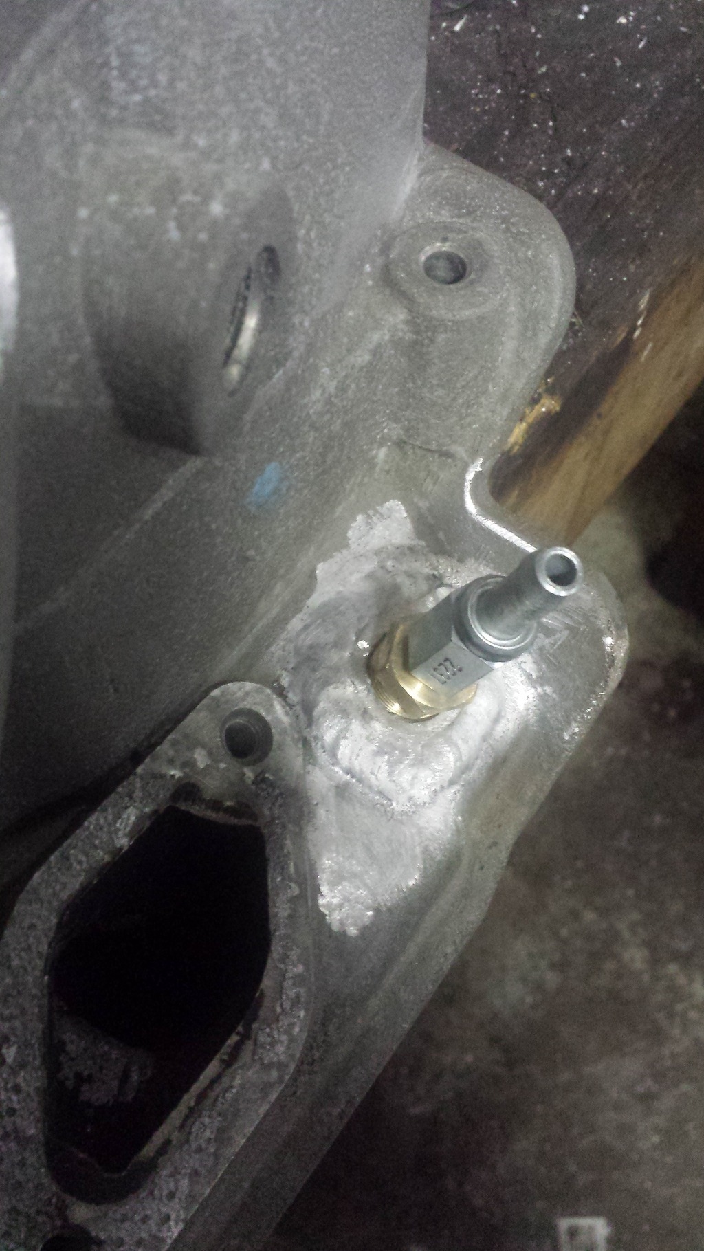

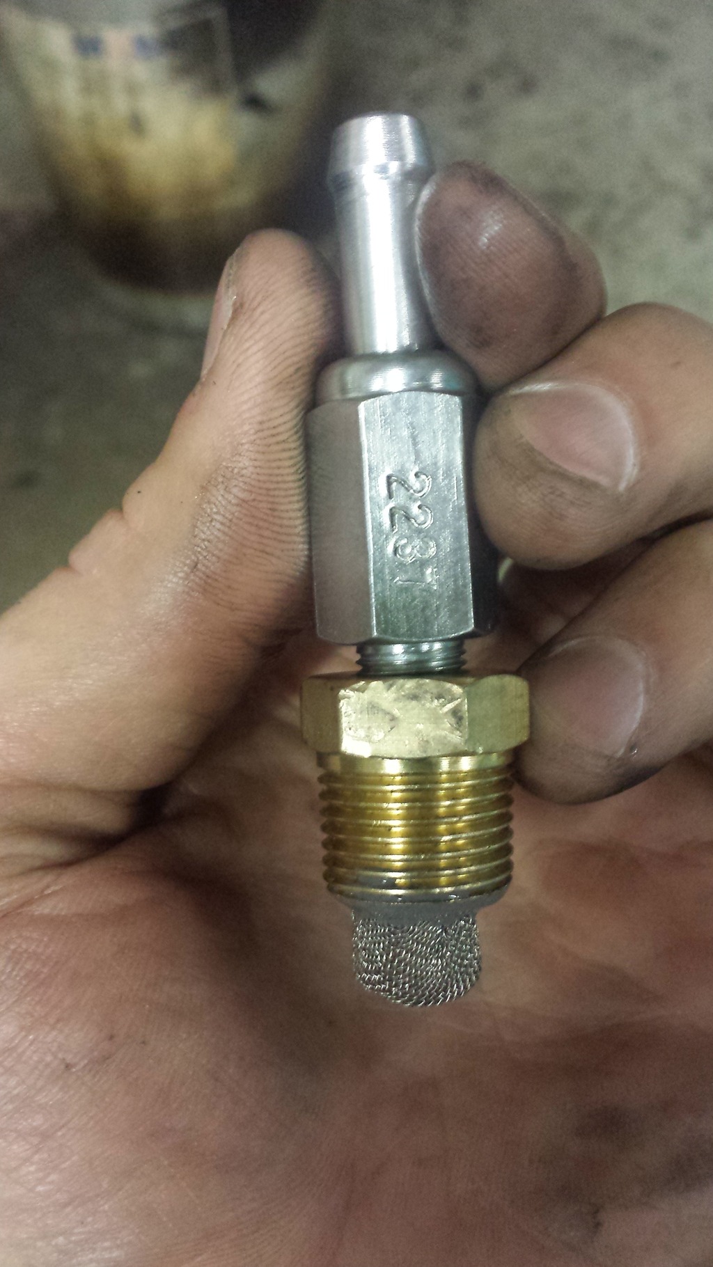

So here is how I redid the PCV system
Put a weld bung below the throttle body for vacuum
And another at the back for a PCV valve
I put a little screenon the PCV valve fitting for a baffle.
Thoughts? Opinions? Criticism?

So from where does that tube in the inside get air from, the front of the TB but where? and what did you do to the tube?
