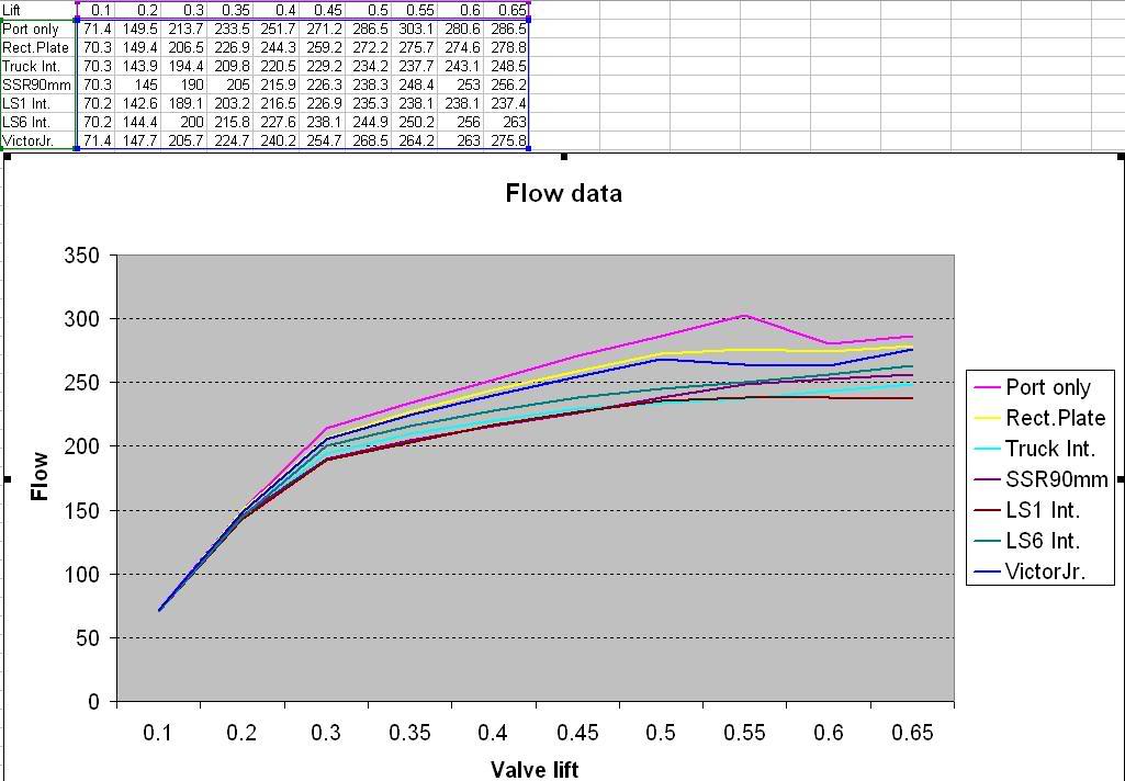

First, one of our sponsors, Richard at WCCH flow tested several manifolds. Here are the flow numbers:

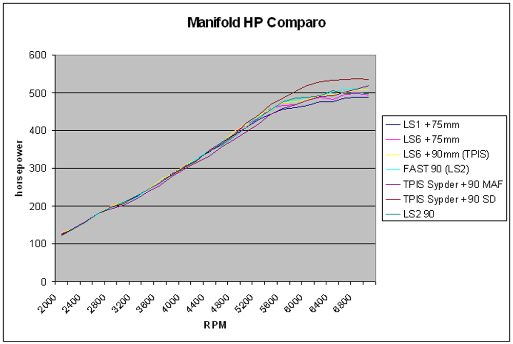

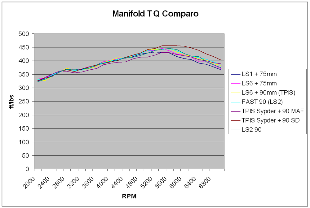

Second, the Jan/Feb issue of Street Thunder Magazine ran a comparo of various intakes and TB combinations on a 236/241 .602/.567 113lsa cammed, ARP'd LS1 with stock 243 heads. All tests except the spyder used the same tune (all tunes created by the same tuner however). Flow matched 28 lb/hr injectors where used for all tests. All manifolds were "out of the box". The full article can be found here: http://www.tpis.com/plog/index.php?o...Id=14&blogId=1
**I neglected to mention that the TPIS Spyder looks identical to the Vic Jr.**
Here are the charts:

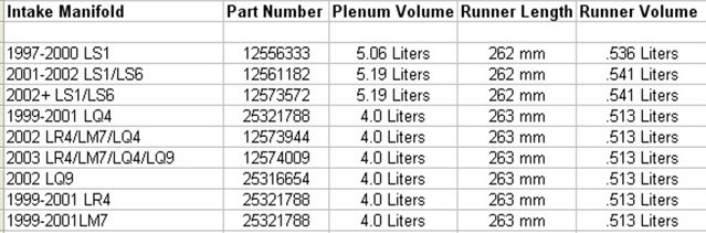

I've been doing some research for a little project of mine and found some info about G.M's intake manifolds that might be usefull...
A little more info; The bigger the Plenum, the better it will perfom at top-end, the smaller the Plenum the better it will perform at low to mid range.
The longer the runners the better it will perfom at low-end, and the shorter the runners the better it will perform at WOT. The bigger the intake runner the better WOT performance, the smaller the runner the better low-end performance.

Well for what it is worth, Most of the info I have found believe for best WOT performance the Plenum volume needs to be the same size as engine displacment, but you can see from the crappy table I made that the later LS6 intake manifolds got closer to that line of thinking with the 5.19 plenum volume.
