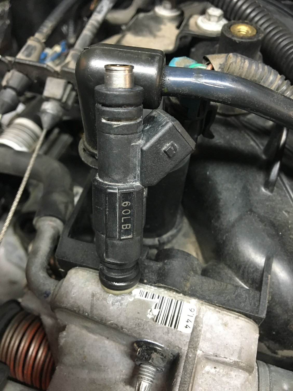

I got this truck and I'm having problems tuning the VE table, just pull an injector to check them they were suppose to be 60 lbs Siemens but the only thing that I see on them it's 60 Lb.

What do you have the flow rate set at? Most injectors are rated at 43.5 PSI. If you are running 58 PSI, your flow rate would be close to 69.22 LBS.
