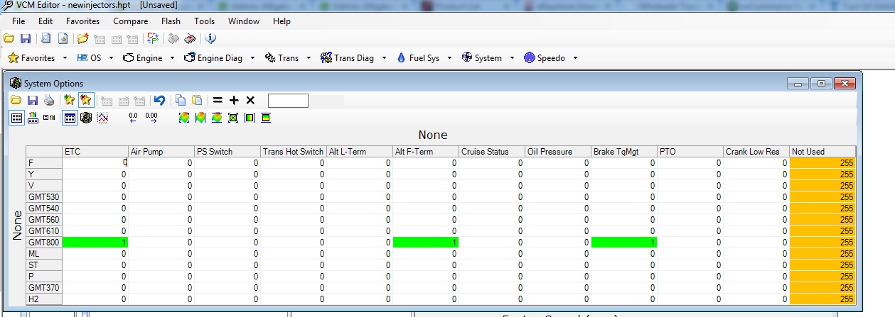

found this under system
"alt F term" it has a 1 on it, i wonder if that has to do with charging system
here is more info on it

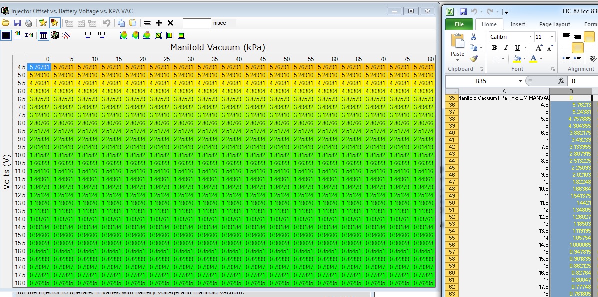

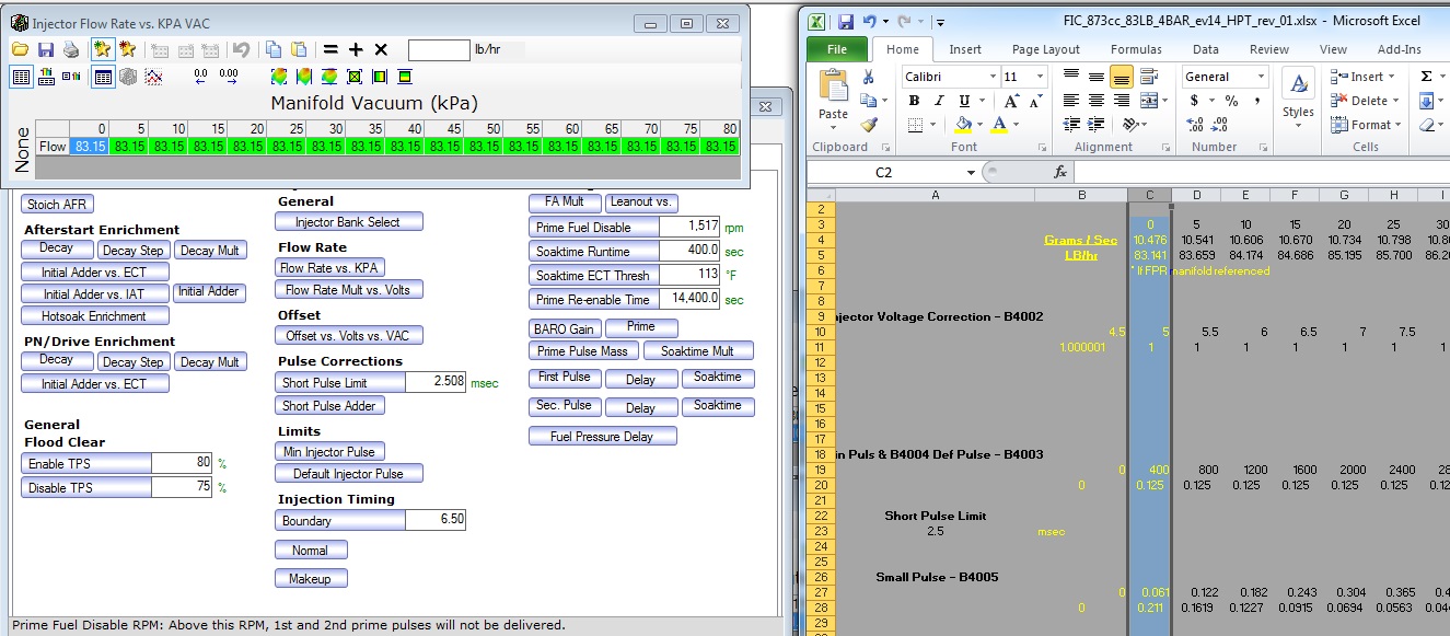

i cant paste exact numbers, when i enter them its like it rounds it to the closest number
also i found this thread
https://www.performancetrucks.net/fo...-488787/page2/
going to look see if mine has that on the neg cable or not if so i may just unplug it
http://www.archivedsites.com/TECH_CO...05%20Final.pdf
Based on your offset table, your injectors have a slow response time. I thought those injectors were faster. Post up your data for them that they came with. My Alt L Term and F Term has a 1

i already posted the data here in the thread, its a download link cause the forum wont let me load it in my post
only 05+ trucks got the RVC systems, im just trying to figure out if there is a way i can disable it and make it sit at 13.8 as if it was in a "fail mode" cause i have the feeling trying to tune around the voltage change is going to be a bitch
link for injector data
it wont let me attach the excel sheet so heres the link
http://www.filedropper.com/fic873cc83lb4barev14hptrev01
