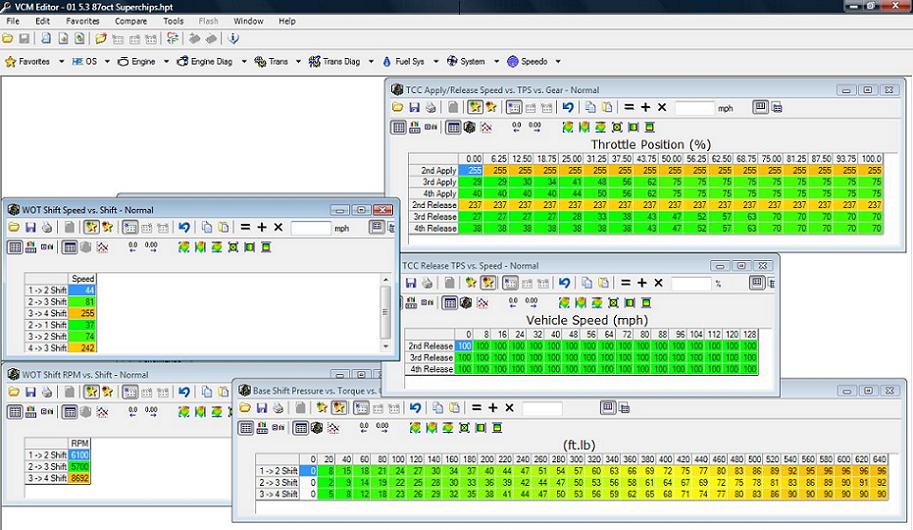

This is how his truck is currently set at. Still not sure if I should raise the shift pressure. Shouldn't the apply speed be raised and the release tps be lowered?

I think you should do a bit of reading before you start changing things Don't mess with the TCC Release TPS (currently 100%) tables. It looks to me like somebody has already raised the shift pressure tables, I do not believe they are set to 96 stock!
You are working on too many things at one time IMO, keep it simple and make small changes and see how they work out.
Go to hptuners.com and start reading...I have had this software for a year and am still clueless

I have been reading and trying to understand more about auto trans settings. I have had hptuners for about two years but all I have done have been manual trans. The reason I asked about the apply and release settings is because I looked at other tunes from the searching I did and some others were a lot different including the release tps table. I haven't changed anything on the tune yet. Just trying to understand what everything can be changed so I don't mess anything up.

I've never altered or seen anyone else's tune that had the TCC release tables altered but you can reset the speeds for lock and unlock in the Normal, Cruise and Performance (apply/release) tables.
