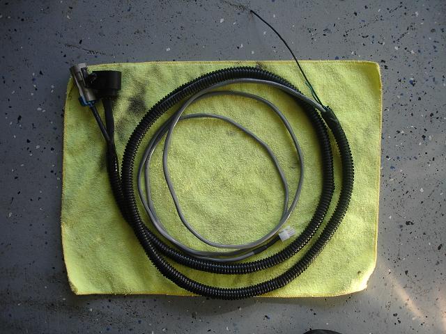

Picture 1 > All you get with the kit. No software. Unit will only do AFR of gasoline.

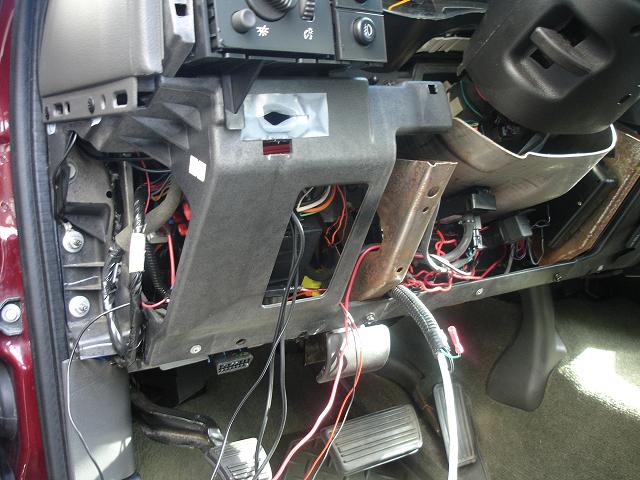

Picture 5> A shot of the dash. You can barely see an orange spot in one hole. that is where I placed the PLX controller. Switched power and ground to the PLX. Gauge is plugged into the controller, serial data and power provide via the controller. Last connections are the outputs. 1 WB out goes to MPVI along with reference ground. The NB out connects to the green wire I brought up from under truck.
