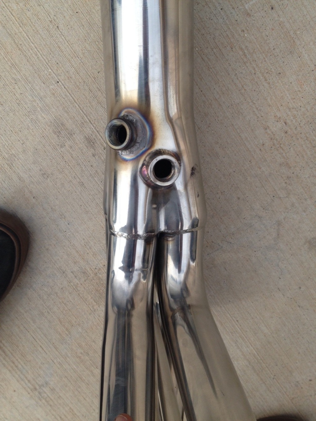

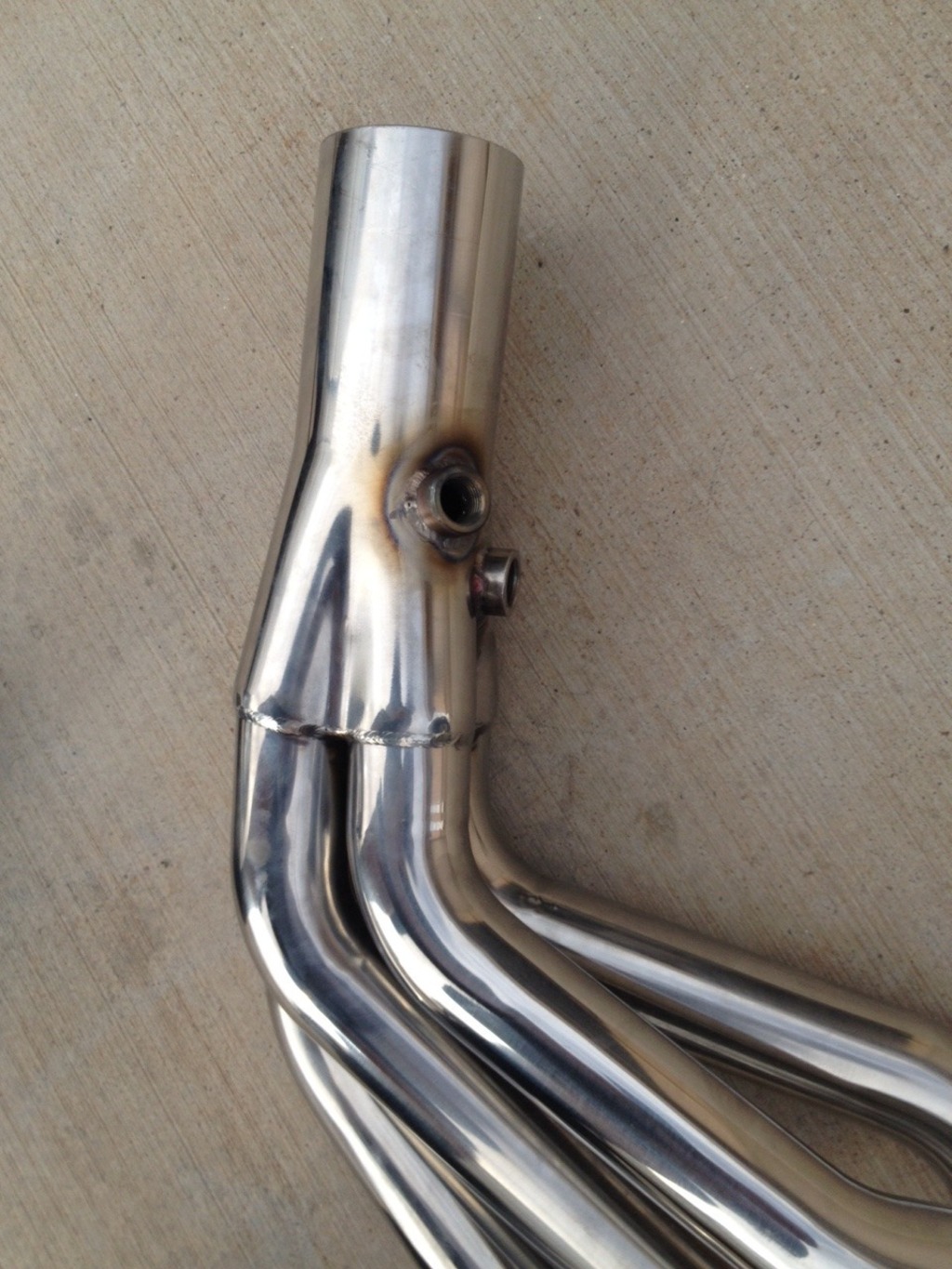

Old 08-01-2015, 12:09 AM
zblee's Avatar
Join Date: May 2015
Posts: 273
Received 2 Likes on 2 Posts
Thanks guys, ended up taking your guys advice and added a second bung to the driver side header collector. I held up the header where it would be installed, checked to see where would be best for clearance and marked the headers appropriately. Took the header to my buddies shop and he was able to weld the bung where I wanted. Turned out great now I just need to install it !

Old 08-01-2015, 05:28 PM
JohnDaMan's Avatar
Join Date: Nov 2006
Location: Sumter, SC
Posts: 101
Received 0 Likes on 0 Posts
Ouch, he butchered that stainless. I'm a welder for a living so it's hard to not scrutinize welds (most assuredly my own first). There is a star crack in that second picture though. Might want to have him wash back over that with his tig rig. Did you purge the header? If not (that weld is really dark indicating a lot of heat input) the weld has now contaminated the back side of the collector directly under that weld. It will be a black, precipitate looking substance. Use an end grinder with a burr bit to grind the contamination out. That could restrict flow depending on how much heat input occurred with no backing gas.

Old 08-02-2015, 09:47 AM
JL Sargent's Avatar
Join Date: May 2015
Posts: 23
Unless there is a leak, nothing to worry about.
