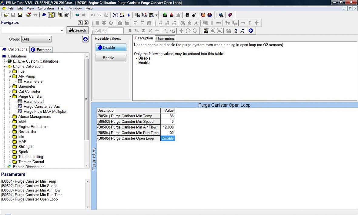

EFI Live has a setting that will allow the Evap test to run in open loop. I looked through a HPT tune i have and I could not find the setting, maybe some one of yall can find it.

I found them.. I got evap gone but still working on the o2s. I'll post what I did tonight. I'm on my phone ATM.
