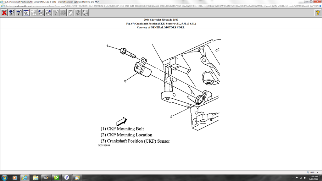

anyone have a pic or two of where the Crank sensor is?
I mean i have the general idea but would like to know before crawling under there and pulling the starter what i'm looking for.

  #90
AKlowriderZ71's Avatar
11 Second Hall Moniter
Joined: May 2008
Posts: 11,651
Likes: 10
From: Wyoming
