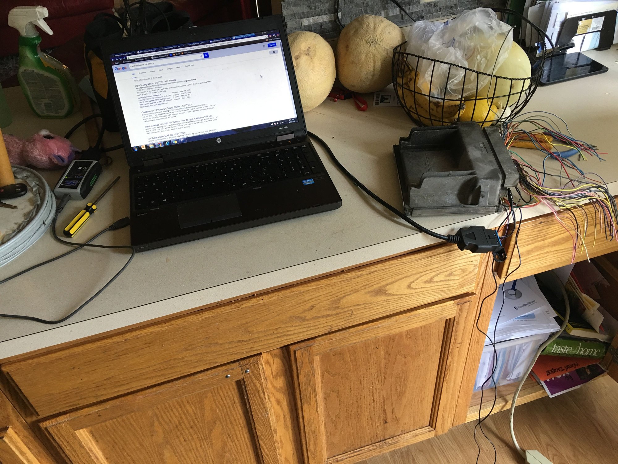

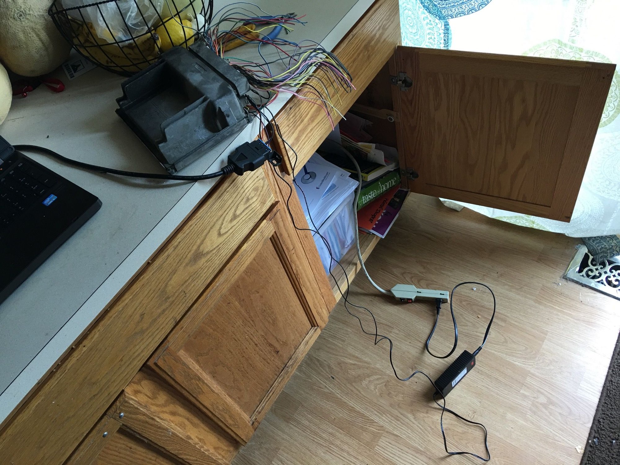

It aint pretty, but i can work on pretty later lol
Made the bench flasher
and no, i didnt get yelled at for putting this on the counter.
i guess it flashed fine, i can read and write to it.
but now im having this issue, i dont see an os on it..
