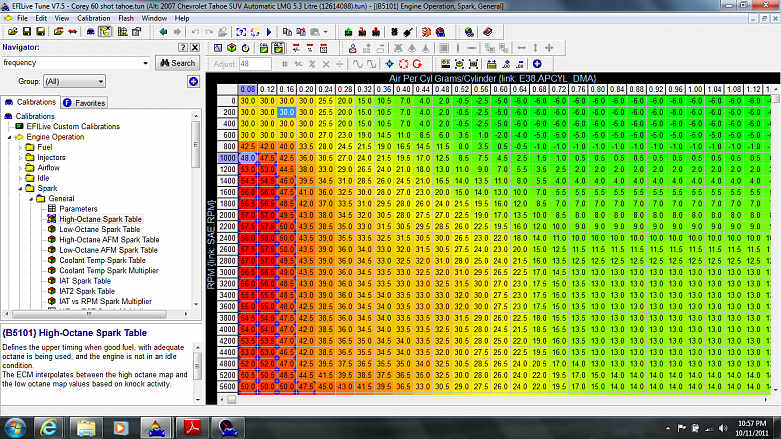

Originally Posted by Rhino79
Interesting, I had a stock file that was like 45* in that area..lol I would try lowering the timing some, it may just be too far advanced.
Heres a stock timing table for my LMG...

Im thinking of trying this??

Give it a shot, I see no reason to run 50* in such a no load area.

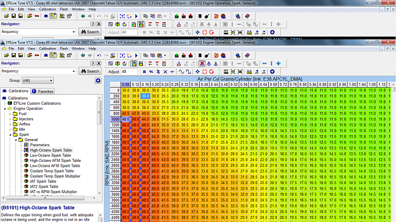

I lowered the low load/low rpm timing.. Heres a log of the changes. May have to do some fuel trim corrections?

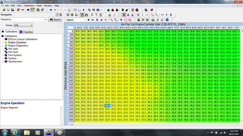

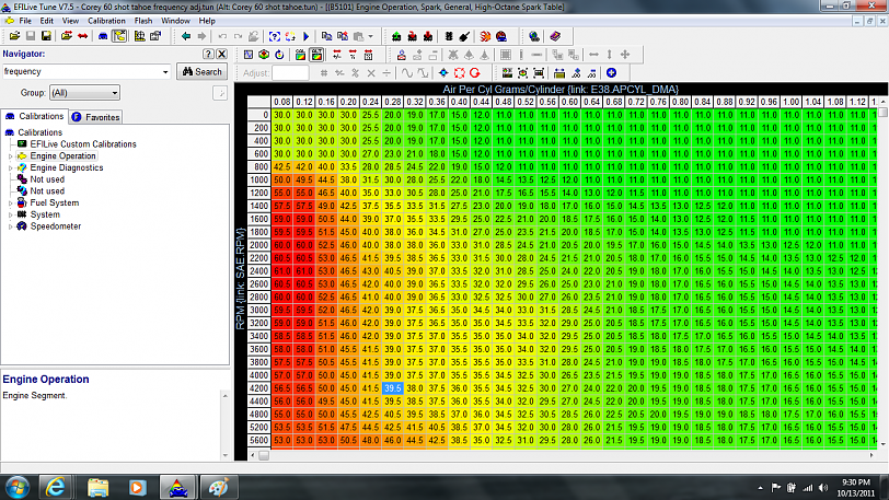

Ended up lowering the Timing a Ton! Seems to be liking it so far...
Attatched a before and after adjustments
Attached Thumbnails Help (efilive log)-timing.png   Help (efilive log)-timings.png
