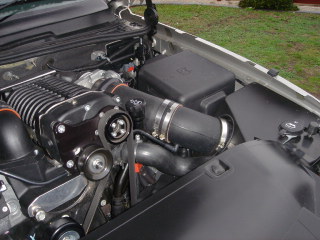

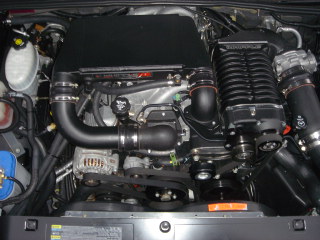

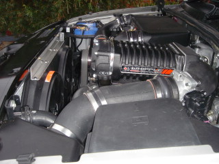

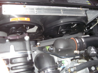

Here are some pics.
My truck has been converted to RHD, so some serious mods needed to be done to accomadate the SC install.
The fans are flexi lite normally for a duramax and they work well.
Any chance of looking at your tune??????

Looks good man, I dig that radix style blower adapter on there. Thats a lot shorter run than mine intake track. I will have a look at your tune and see if there is anything that looks different. My tune is in the link in the first post of this thread. Its an EFI tune. Out of curiosity, why did you drop EFI and go HPT? What issues does HPT cover that EFI can not?
