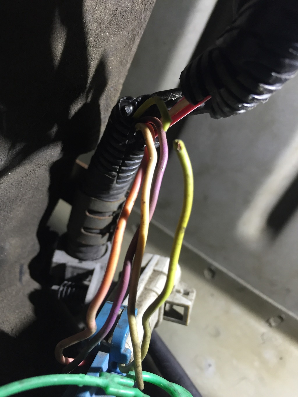

When you search hard enough you will find the problem. Broken wire in the passenger side O2 harness.
