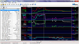

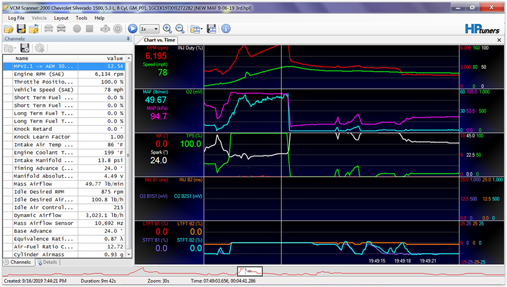

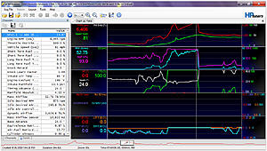

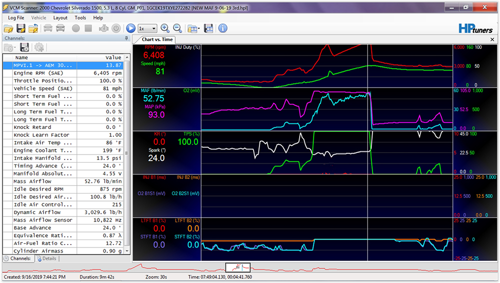

Tuning the MAF curve today getting everything pretty well smoothed out. Still in open loop MAF only I wanted the check the A/F at WOT in PE. Looking directly at the wideband everything seemed OK until I looked at the scanner log.
At around 6000 I was at 12.54 AFR then It creeped up to 13.87 around 6400 RPM! It was there a brief second unbeknownst to me when I got out of the throttle. Seeing the scan though was a little upsetting
I'm running a small cam, headers n/a with 50 lb/hr injectors with a 10 year old Delco OEM pump.
Looking at the Walbro 255...
Does this sound like running out of fuel pump??
Couple pics between 6000 and 6500 RPM (wideband highlighted top left column)

Really don't know where to add fuel without making the tables rich below that spike. It's perfect 6100 and lower but at 6400 it starts to go lean (rev limiter is set at 6500). It's kinda worrisome seeing that quick lean spike at high RPM's.
