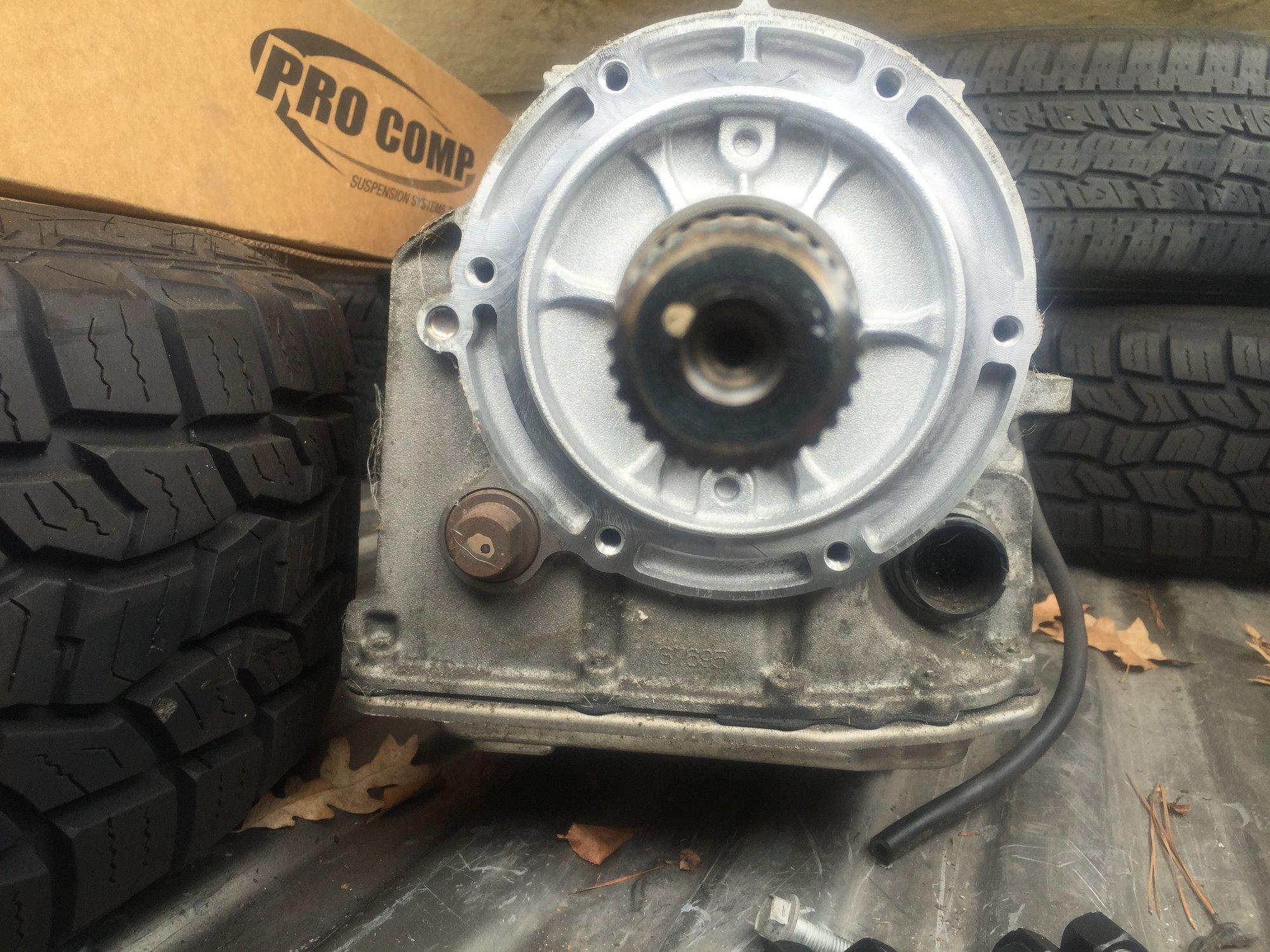

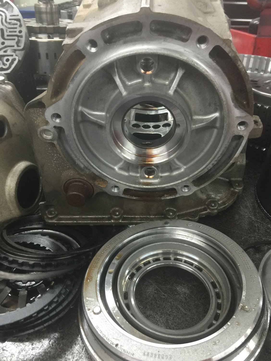

They are correct the holes in the output shaft assembly are essentially the reluctor wheel for the output shaft speed sensor, the newer style have lugs on the outside(at least in the 4wd versions) and come with the iss/oss harness that hasa different oss sensor with a step in it to clear the lugs. The vette and 4wd trucks use the same case, 2wd 6l80s have a hole in the back if the case....
The rear of the vette/4wd case, on 2wd one of the divets at 6 and 12 oclock to the shaft are open
Here is a 2wd case...

YES - My guess is that those two holes on the 2WD are needed to lubricate the yoke and return fluid back to the trans pan. Something not needed with a Corvette trans.
