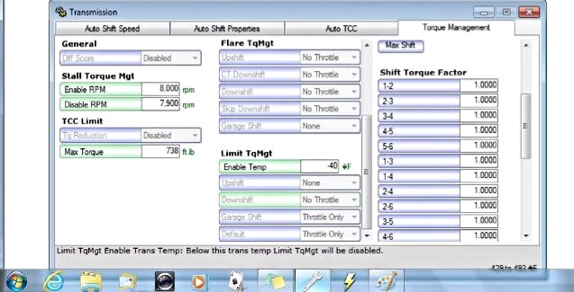

As to the topic of this thread , I have also experienced this .
Bieng the middle man with my HPT software , i was helping my friend tune his 2007.5 2500HD LY6 6.0 and 6L90E . All stock no mods just tune only at the moment . One of my good friends tuning it
The truck after the tune ran great , we were very happy , but he , Like the original poster , wanted to be able to power brake the truck a little , hence part of reason why he wanted it tuned .
So after loading the tune and driving around awhile , happy with the shifting and better performance , we stopped and tried power braking it , it would start to , then stop and go again . Hmmm wierd , tried it again , both pedals to the floor and it just felt like it had pulled a ton of timing till he let off the brake .
I went into the tune and found a value in the trans table that I felt was causing the problem , turned it off and reloaded the tune , seemed to fix it .
But my friend says it again sometimes won't power brake , so something is still retarding the timing when he tries , i have more tinkering to do , it's weird .
I'll take a screen shot of what I changed for you to try as soon as I get on my laptop , on my phone now .
How do these tables look in your tune ? Anyway for you to tell ?
They should look similar to these under torque managent .
On the Shift Torque Factor you can change that table from 1.000 to .5000 and will give it and quicker firmer shift.
