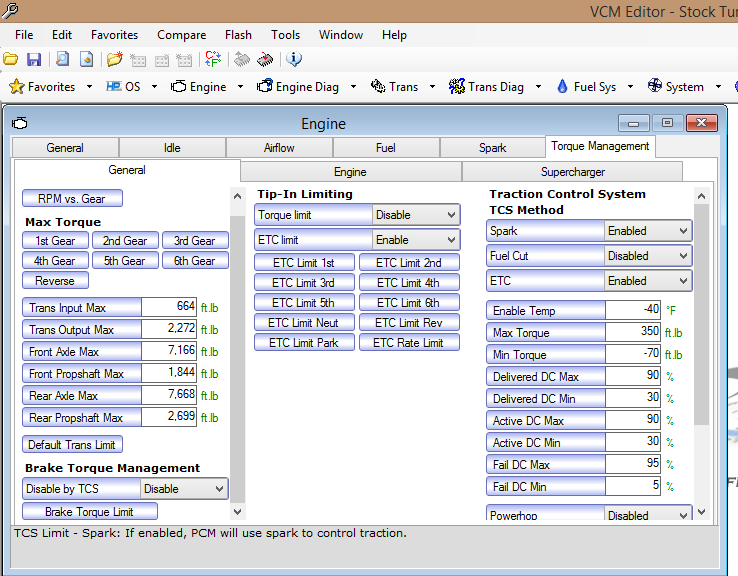

Brake Torque Limit: Maximum torque during braking, to ensure the vehicle brakes can always stop the vehicle.
When you hover over the tab it actually says "Maximum torque limit when brakes are applied to prevent engine overpowering vehicle brakes"
You can set this from -6042 to +6042
Stock it was mostly set to 378 on my old 2010LTZ
Set that tab to all 0's you'll melt the tires off...even with a 3.08 rear
